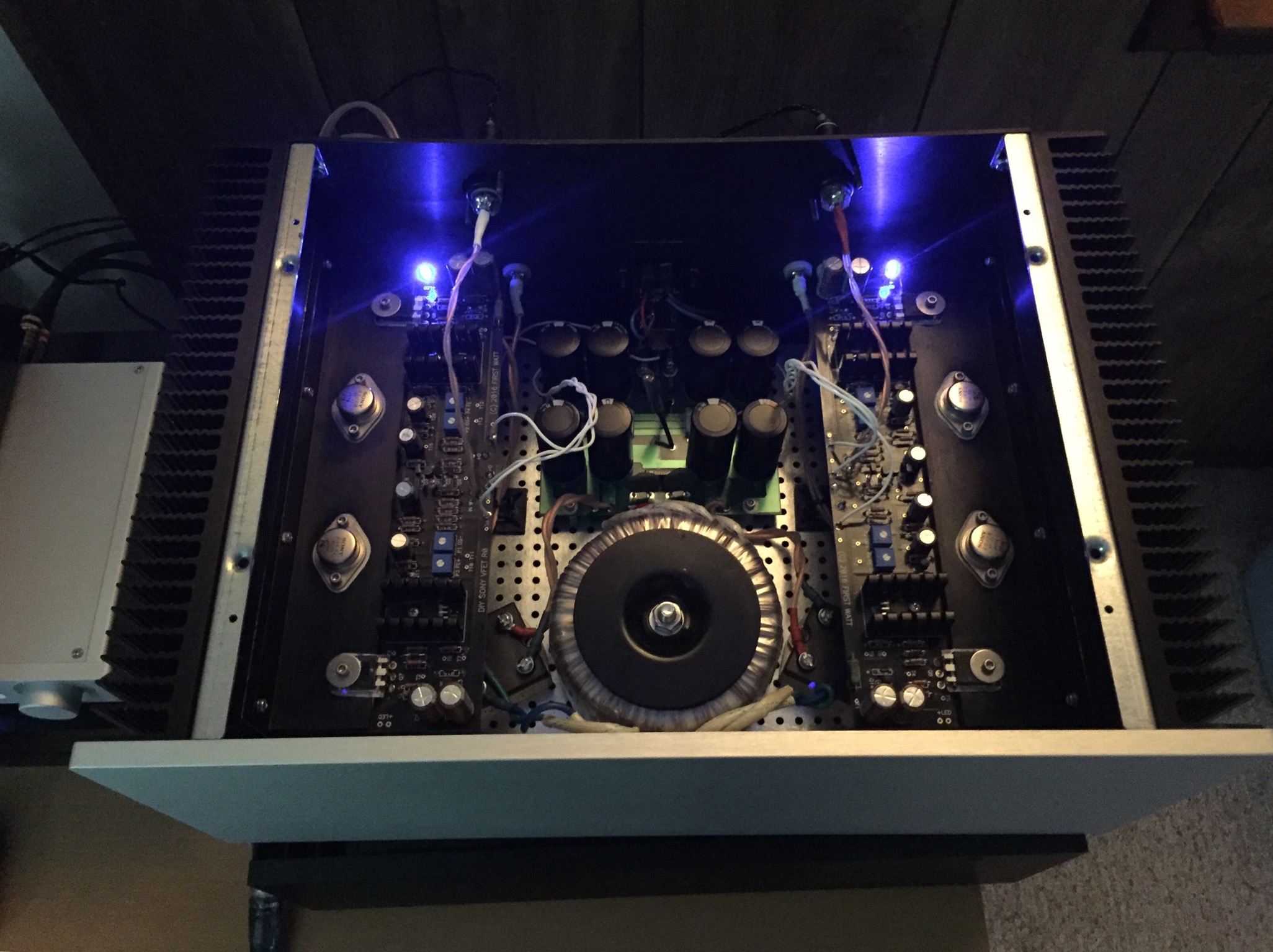

I always wanted to go with true dual mono build for my Sony VFET, hence built couple of universal PSU boards but because of space constraints in the cabinet I had to go with a single toroidal with 2 secondaries of 0-22v@6.8A x2 which is the recommended as per the build guide and NP. But couple of weeks I have connected my another same universal PSU board with the same exact components and the amp works fine and better control on the bass but the downside is the hum issues that cropped up with running dual PSU boards with single toroidal. I was suspecting it would have similar issues that I encountered with my earlier CRC psu boards for the PeeCeeBee V4 build.
So now planning to get a new single toroidal with 4 secondaries like 0-22v@4.5A x 4 so effectively comes to around 400VA. Planning to use 4 independent bridge rectifier modules for 4 secondaries to power 2 universal PSU boards. This is the ideal rated toroidal that multiple of my friends suggested but I just want to double confirm here before I go ahead with the ordering. As I said above because of the space unable to go with 2 independent toroidals. But at least with 4 secondaries I can still achieve sort of dual mono 🙂

I used the larger 4U chaszisy, 400 mm deep I think, and was glad for the extra space. Once I stuffed in a 400 va torroid, soft start, psu, ect, thinks started to get tight.

I used the 4U for mine. Wasn't too hard to fit everything in. It runs way cooler than my F4, which is also in a 4u

Thanks Walter, it looks and sounds wonderful. The best amplifier that I have made and also heard. It pairs superbly with my Jericho Horns made from Fostex 208Sigma drivers. That is why planning to go with dual mono PSU boards and as no space inside the cabinet going with a single transformer but with 4 independent secondaries. I am using 2 psu boards now but as usual having hum issues.
