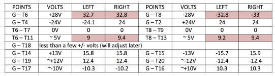

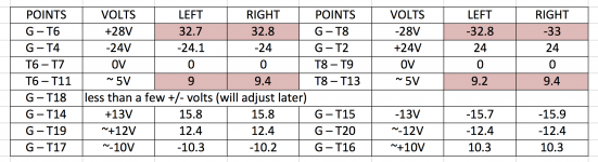

I have completed voltage measurements and attached the results. I am concerned that the rail voltages, G-T6/T8 (approx 33 Volts) are a bit too high. My transformer is a Toroidy with 22V secondaries. My wall voltage is 123V, which is higher than the 115V toroid design. I am using the universal PSU rectifier board with fast Schottky diodes. I changed P3/P4 to the recommended value of 1K for use with the Fairchild MOSFETS. I believe the 9V measurements shown in the results are due to the higher resistance of P3/P4.
I proceeded with biasing up the front end and was able to achieve 1.5V across R5 and R6, with a T18/Gnd output voltage around 0.1 to 0.3 volts. My question now is, should I proceed to installing the VFETS with the higher rail voltage or correct it? If I should need to lower it, how do I do so?
Steve
Steve
Your 9V readings are from the 1K P3/P4 pots.
My guess is that the rail voltages will drop a bit with a load though may still
be higher than 28V. The IRFP240/IRFP9240 mosfets will run a bit hotter but I suspect
should not be a problem. If it ends up higher than you like, you can
burn a bit of voltage by increasing the resistance in the CRC supply,
but I personally would give it a go as-is.
Hopefully others will chime in as well.
