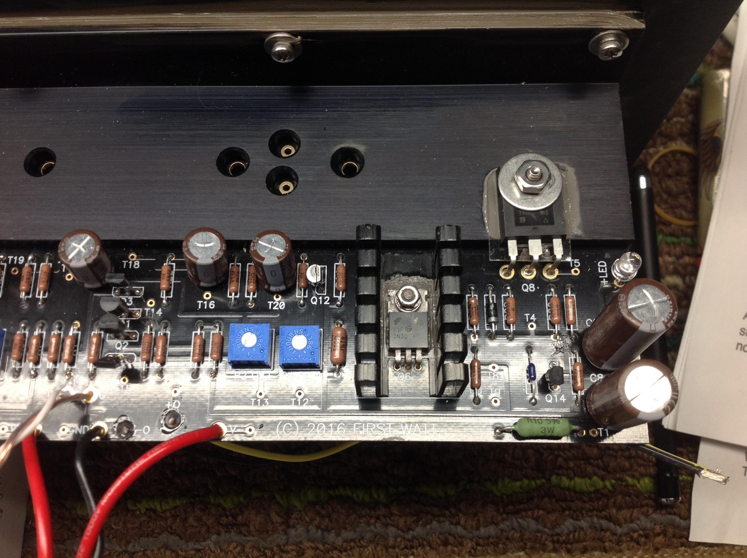

Got my boards stuffed and they have passed the resistance test. Applied voltage as required for part 2 and I'm not sure what to think of some of the readings. Everything looks good until I get to t-6 to t-11 where I have +16.15 volts. At t-8 to t-13 I have -16.15 volts and at G to t-18 I get -16.69 volts. Should I be concerned or is this normal before the pots have been adjusted?
Are T14 and T15 to G close to zero? Sounds like Q3 and Q4 are not turned on properly. Check that Q3 and Q4 are the correct part and are correctly orientated in regard to their respective pinout. Also, check R7 to R10, they're supposed to be 2.21k each. That's where I'd start at least...
Also, pics, plz. Why doesn't anyone post pics, it makes troubleshooting so much easier.

G-T6=30.6v. G-T8= -30.6v
G-T4=-24.1v G-T2= 24v
T6-T7= 0.714v T8-T9=0.822v
T6-T11=16.15v T8-T13=-16.15v
G-T18=-16.69v
G-T14=14.36v G-T15=-14.34v
G-T19=12.43v G-T20=-12.68v
G-T17=-13.36v G-T16=7.38v
All of the resistors are in the correct position. The semiconductors seem to be installed correctly as well. Q3-Q4 seem good also. I have inspected the solder side and found nothing. I will post photos later when I have a chance

Can you please verify that you correct values for R35, R34 (221 ohm) and P3, P4 (500 ohm)?
The T6-T11, T8-T13 voltages seem very high, assuming reasonable Idss values.
