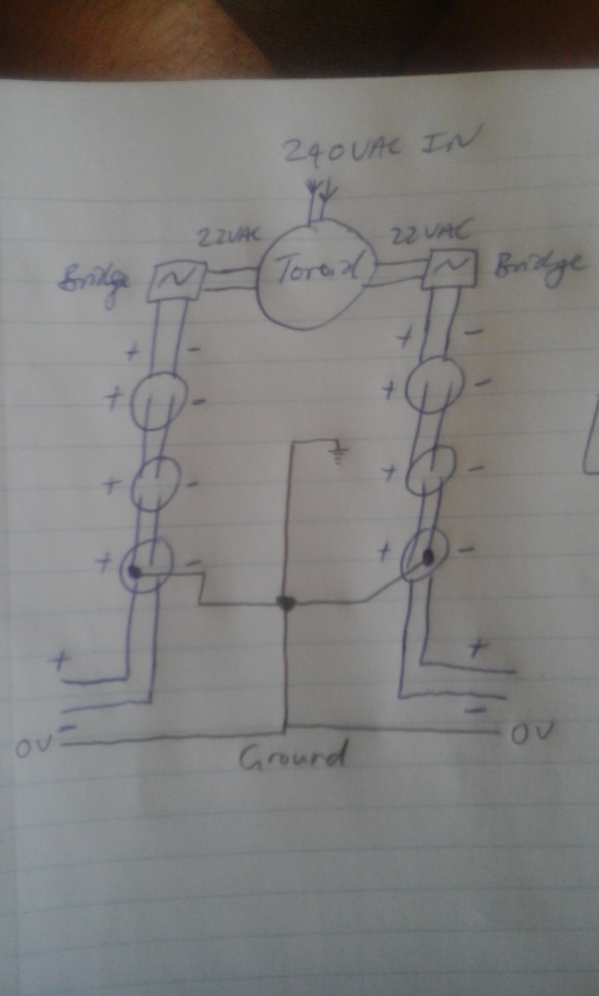

OK - Im not very good at mentally sussing out power supply requirements to please bear with me. I'm not totally sure what I am aiming for here. I have followed the general gist of the post on page 1 of this thread to build the powersupply. I have done it as per the attached. Is this right? I take it Im not aiming for plus 30-0-minus 30VDC? As I dont have that currently. I am getting:
* 30VDC between the wires on each side on the powersupply and
* As well as the above, plus 30VDC between ground and plus on one side and
* As well as the above, minus 30VDC between ground and minus on the other side.
Am I overthinking this? I basically have the same powersupply sorted out as per the diagram in this thread except without the resistors. Would I be better off installing the universal power supply boards sold in the diyaudio store? Im not sure that I have room in my case now.....thanks!

Great - thanks - and I assume that the plus, gnd and minus in your revised diagram goes identically to both modules?
Sorry but I can be a muppet sometimes.
Adding the resistors between the capacitors will also reduce the ripple voltage.
And if you are referring to each channel as a module, then yes the plus and minus voltages and ground need to be connected to both channels.

if you're having dedicated PSU per channel , then yes ....... if that is what you're asking
