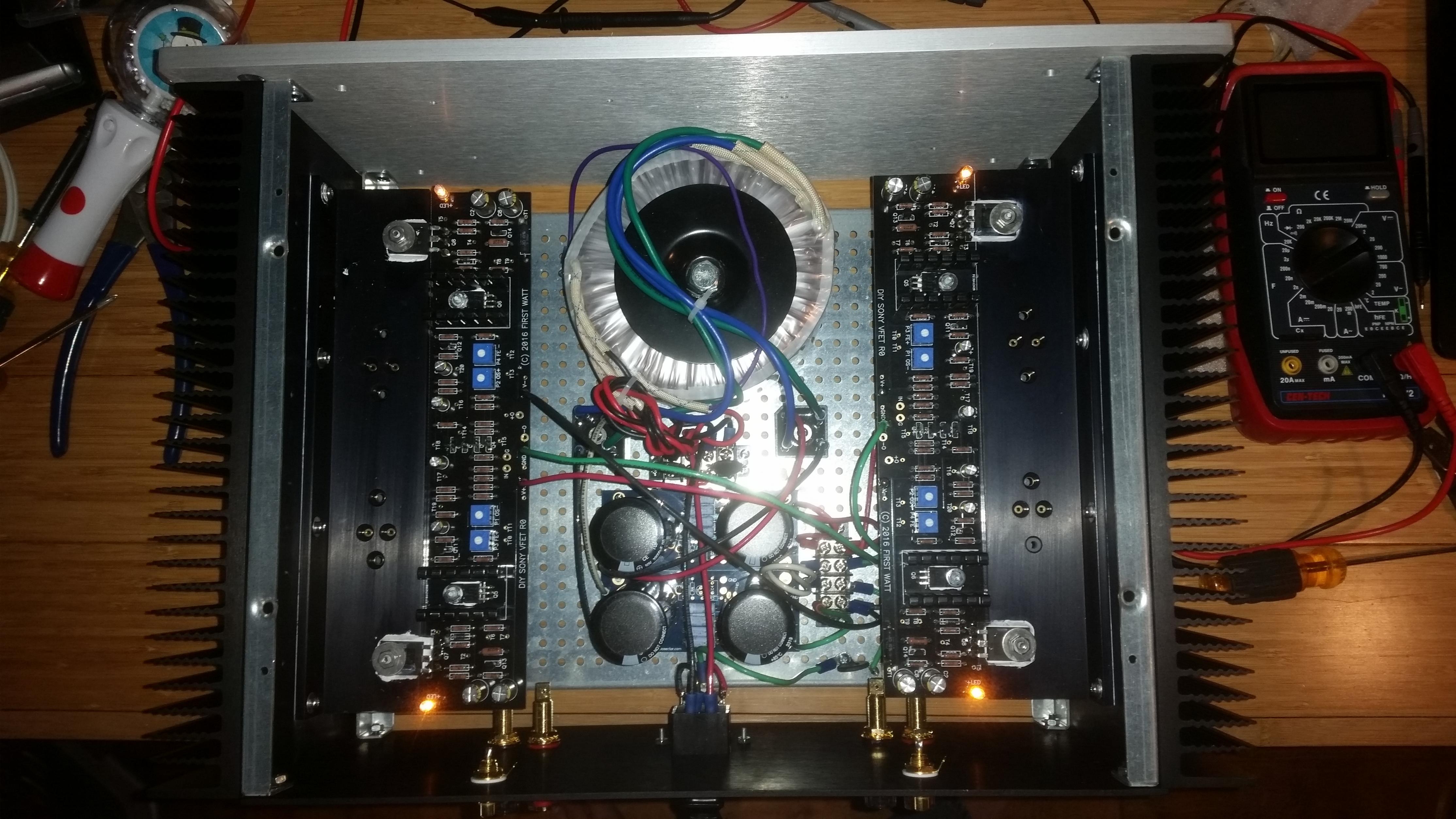

I've got my front end up to 1.5V ( same process as getting my BA-3 FE preamp set up ), with ground to T18 as close to zero as I can get it. Also rechecked and adjusted G to T16 and G to T17 to keep it dialed in for my vfets.
One thing...this is my first time using single turn pots. I've read many jokes here about getting them in the right spot, but getting G to T18 close to 0 seemed to require a combination of screw driver weight, rotating it, and some voo doo. Is this normal? Seems to stay put once set, but I worry that moving the amp around could jar the finicky pots. Unnecessary paranoia?
Time to put the vfets in?

What you can and should do is to slightly tap the pot's housing with the screwdriver to promote the pot to release any residual mechanical stress of the moving parts (pot...release stress, haha). That way you can see any changes in the setting while the meters are still attached.
Without the Vfet installed the currents in the amp are all pretty low, so small changes in resistance will have a big effect on draw - hence why the pots seems super sensitive. With the circuit running at spec, the sensitivity of the pots will lessen somewhat.
Without the VFETs installed there is also no feedback, since the loop from output to input is not closed. With the VFETs in place the feedback loop is closed and things start to get interesting 🙂
That makes sense. Thank you 🙂
I fired it back up this morning to warm up and everything settled back into place where I left it yesterday, with offset bouncing around between +- 75mv for both channels.
To get offset right yesterday I would purposefully slightly overshoot whatever direction I was turning the pot so it could settle back to the value I was aiming for, so tapping the pot to relieve stress also makes sense. I gave them each a small thud this morning just to be sure. Everything stable 😉
Going to pull it back apart and get the vfets in now.
Almost forgot....Thank you guys!
