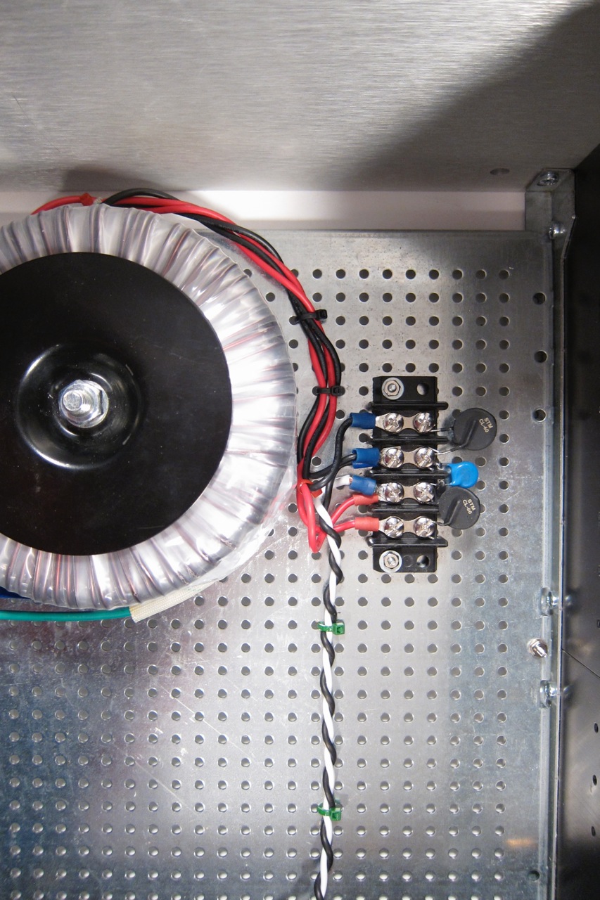

tidy up that CL60
I think the CL60 is where GND meets PE. Not deadly, bit still not pretty, I agree.
Tidying complete
CL60 leads shortened. Also scooched it over a bit, and attached the ground on the opposite side of the terminal block, where there is more room.

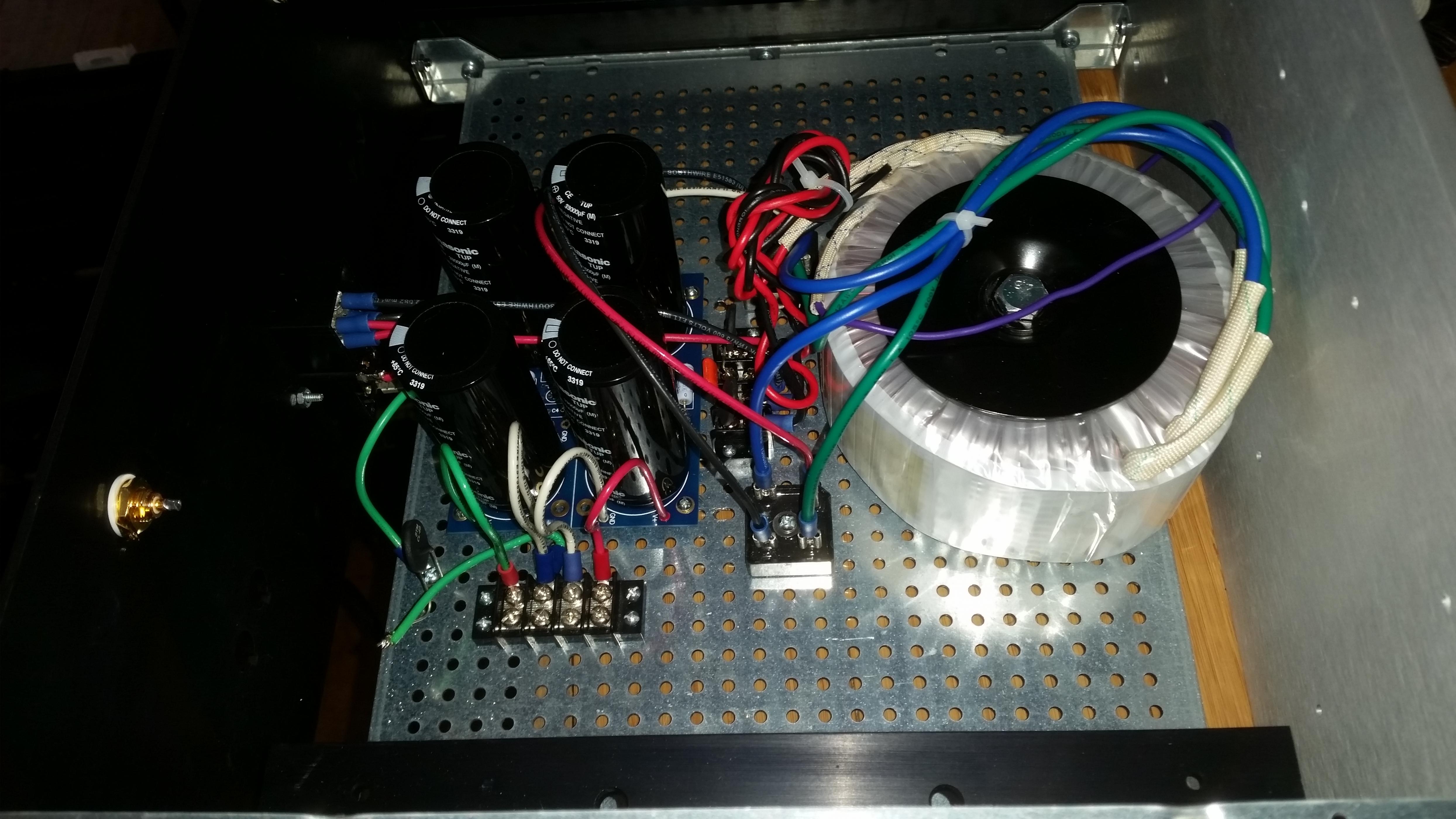

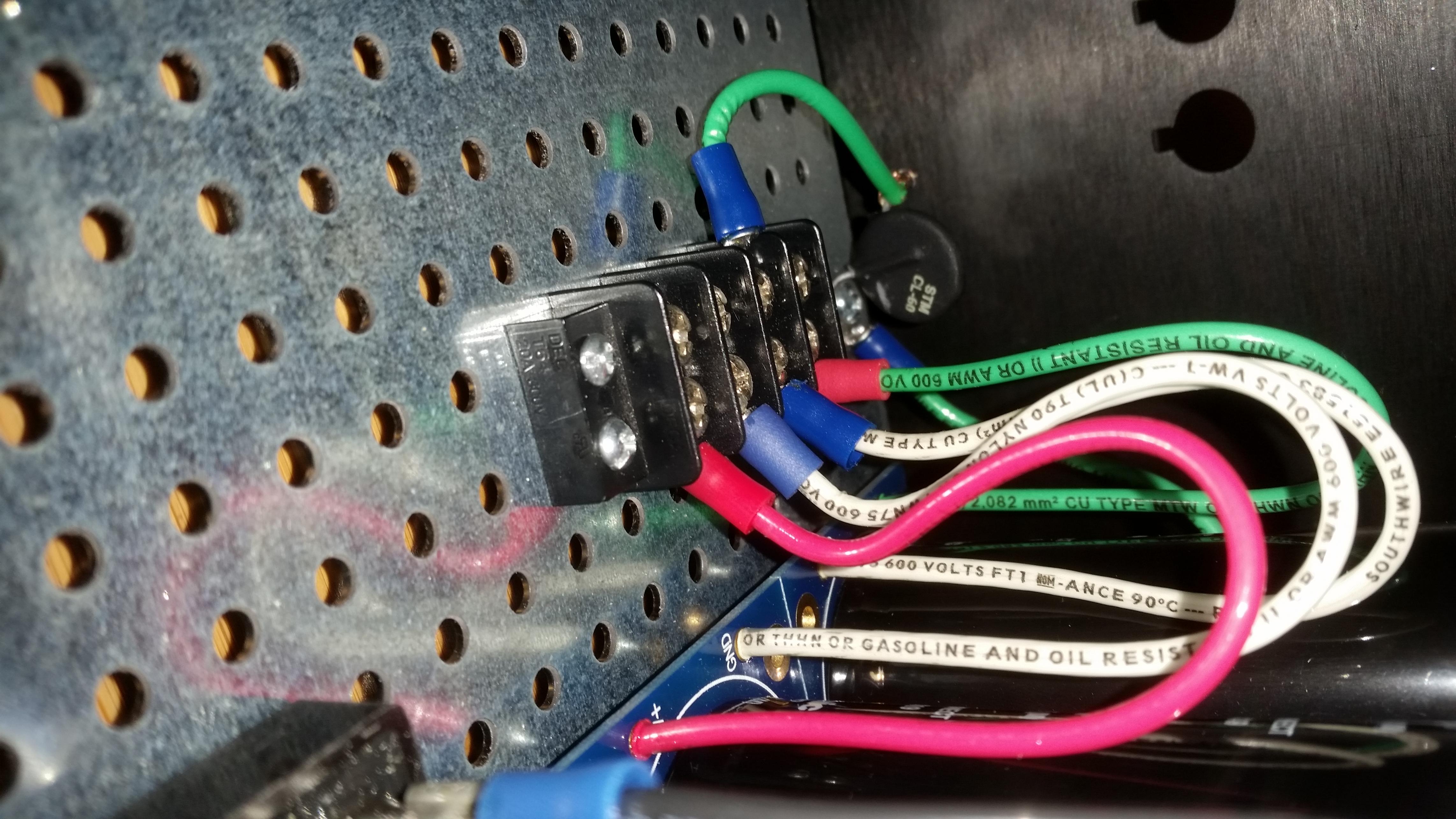

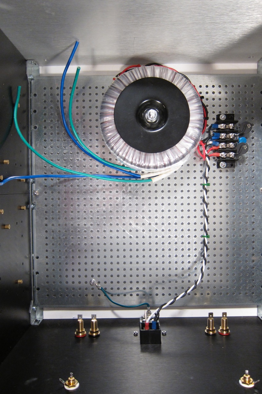

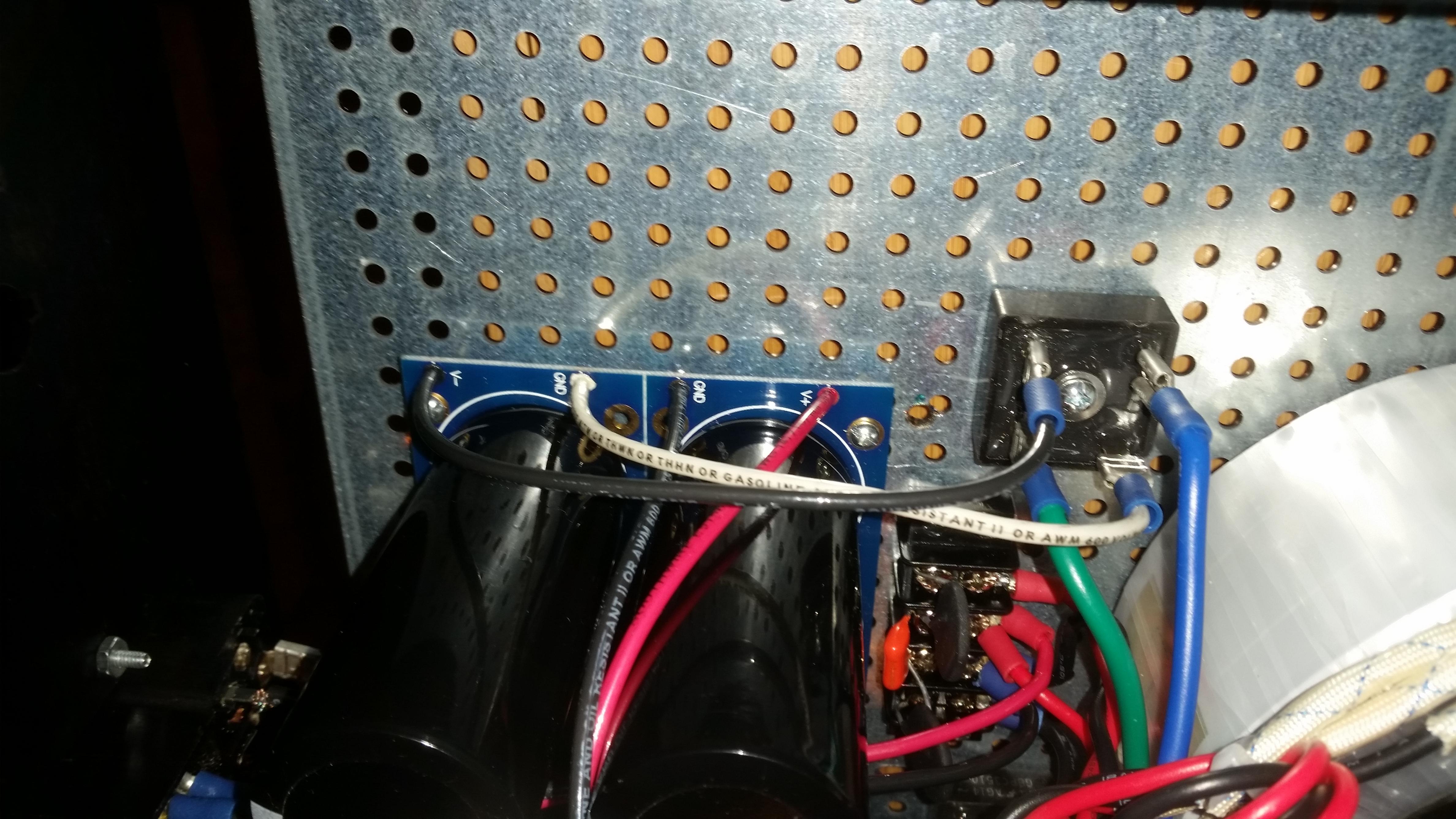

How have you insulated the bottom of the PSU PCB it looks to be mounted very close to the bottom of the chassis, & do you have a fuse anywhere? Also is that orange cap safety rated, I've never seen one in that collour? If not, if it shorts you'll have a problem.
Hi Folks,
I constructed the PSU exactly as shown here:
A guide to building the Pass F4 amplifier.
The photos of the power supply are at a bad angle. It's about 1/4" off the board. Tall enough that the 2.2k bleeders are under it, but each still about 1/8" off the base plate.
I want it to be safe and correct, but don't see where/how to change the connection to chassis ground. The side of the CL60 that is attached to the chassis is connected to earth through the schurter power inlet. Same one as comes with the back panel kit in the store.
All help is appreciated 🙂
