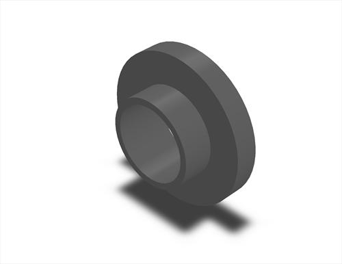

Q5/Q6 use insulating shoulder washers? Can't tell from the pics.
BK
Yes used thermal insulation pads for Q5/6.
I just checked every resistor on the board and compared one by one with the board which is working fine. And the values are exactly the same without any discrepancy. I cross checked the J74/K170 orientation and they are fine including ZTX450/550. Q5/6 are also mounted correctly. The only values being different on both the working board and this board is the R34/35 where the good board I have used 562R and the bad board 1K after checking with 221R/470R/562R and went all the way to 1K. I have ordered the FQP20/N20 pair to replace if they are damaged with excess voltage during the setup initially which I doubt as I checked the continuity and they seem to have almost the same resistances around pair of legs when compared to the good board Q5/6.
And I hope the jfets Q1/2 are not damaged during this voltage checking process as they are matched ones that I had since last year for this project 🙁
Now this is getting little complicated as everything is same and with couple of test voltages being abnormal rest seems to be on par with the published values.
Oh yes TO-220 washer which came with the Sony vfet kit and used on both Q5/6 for both the PCB boards.
