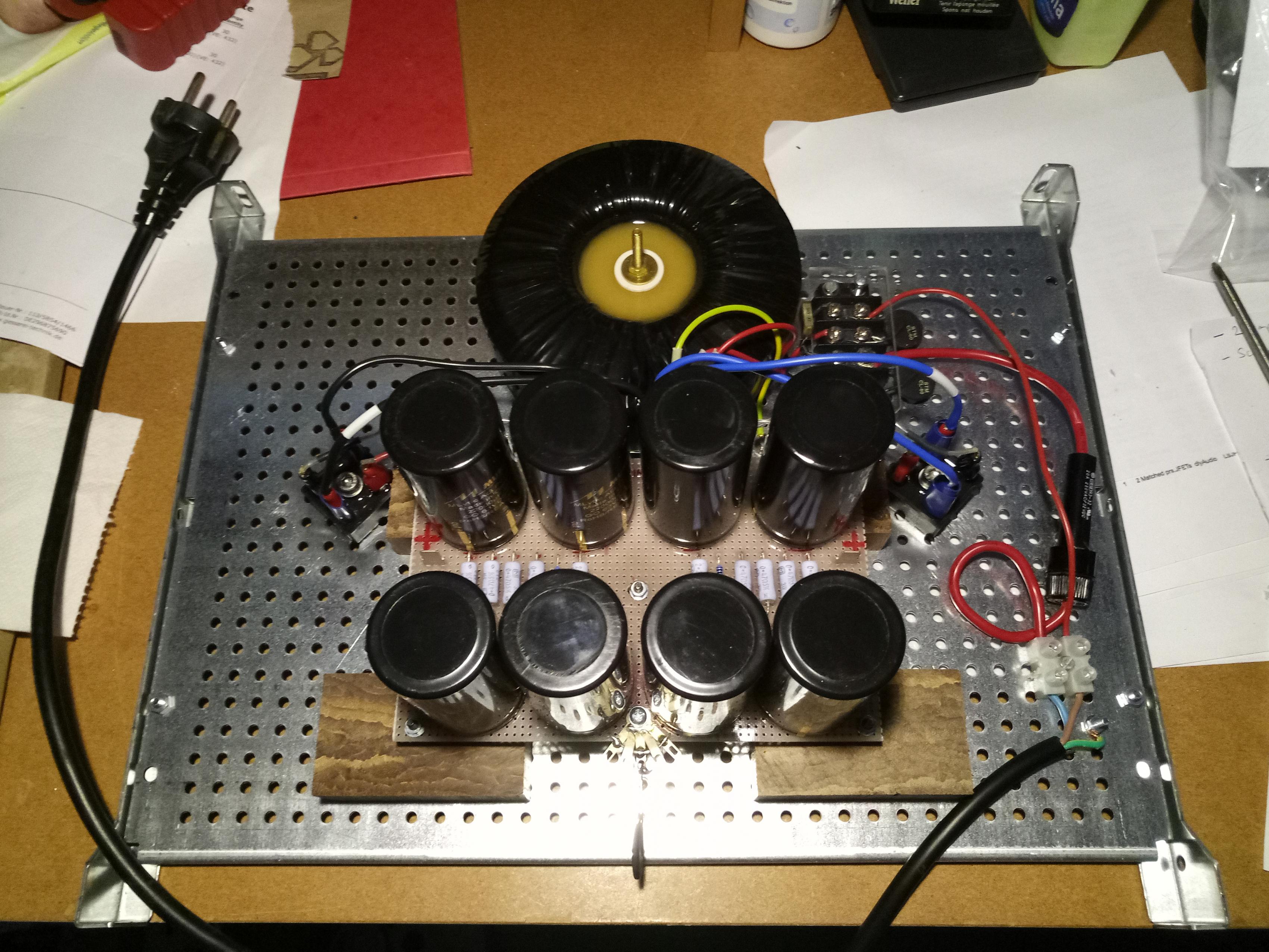

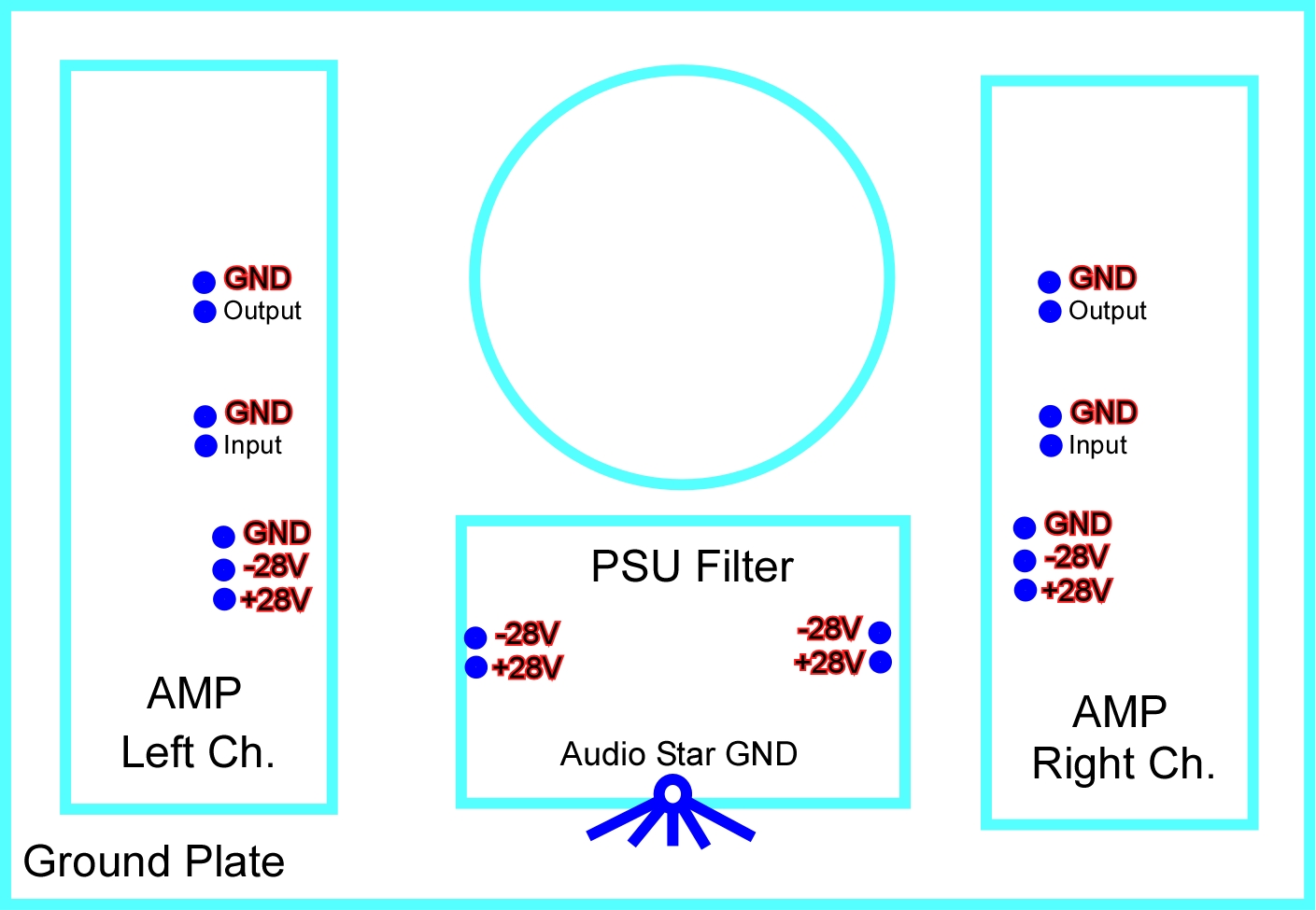

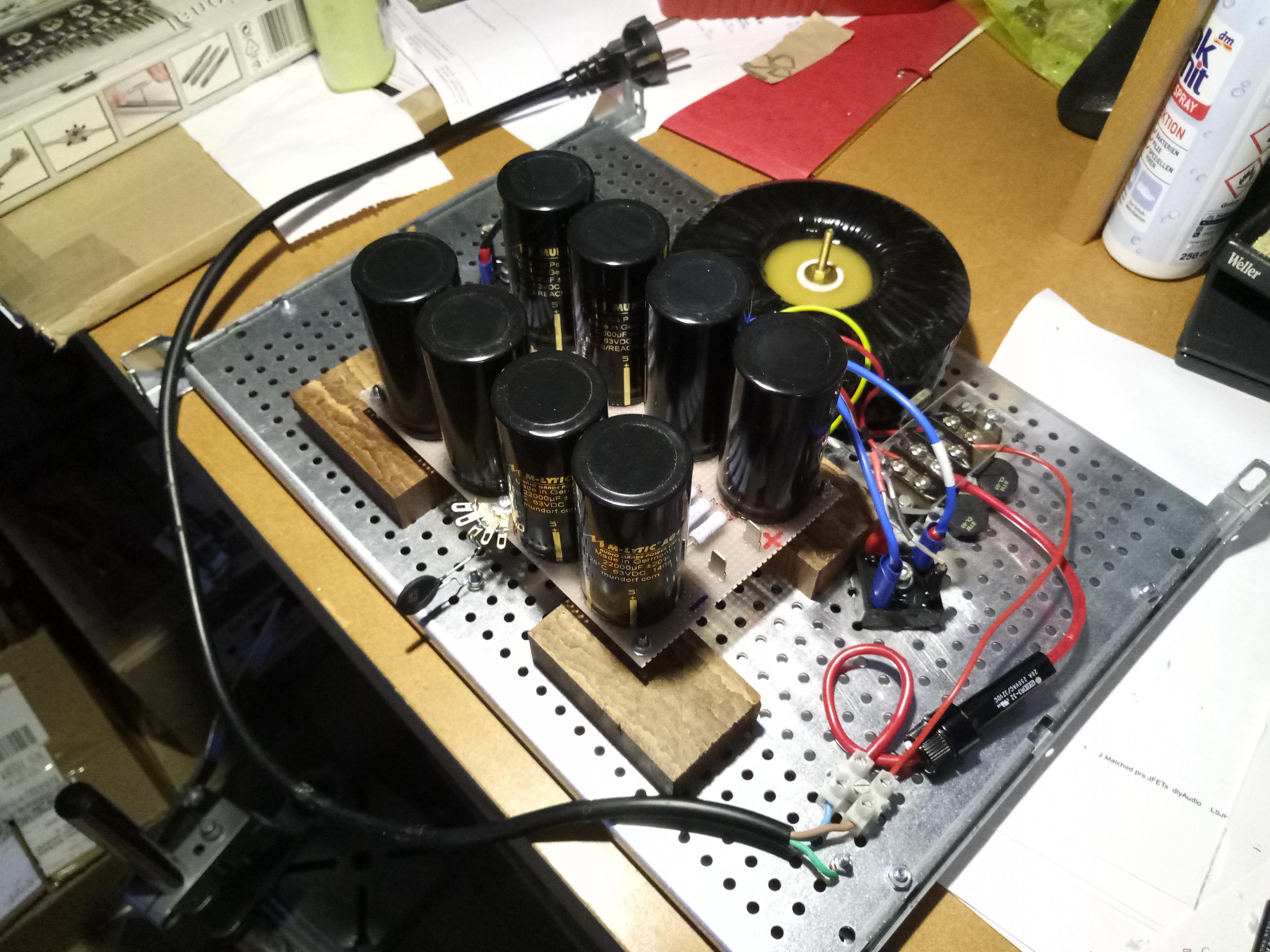

as I am slowly progressing with the amp and have now finished the PSU using 4pole caps I have a question regarding the GND connections:
is it better to use the audio ground (star GND at the PSU) for the speaker connections and connect only the "+ output" from the amp pcb, or use both the "GND and +output" on the amp pcb?
The same same question is also for wiring the input connections ;-)
best regards

look no further than on how Papa made it
many thanks MZ! it means wiring the GND for input and ouput from the amp PCB and not from the audio star GND at the PSU?
regards

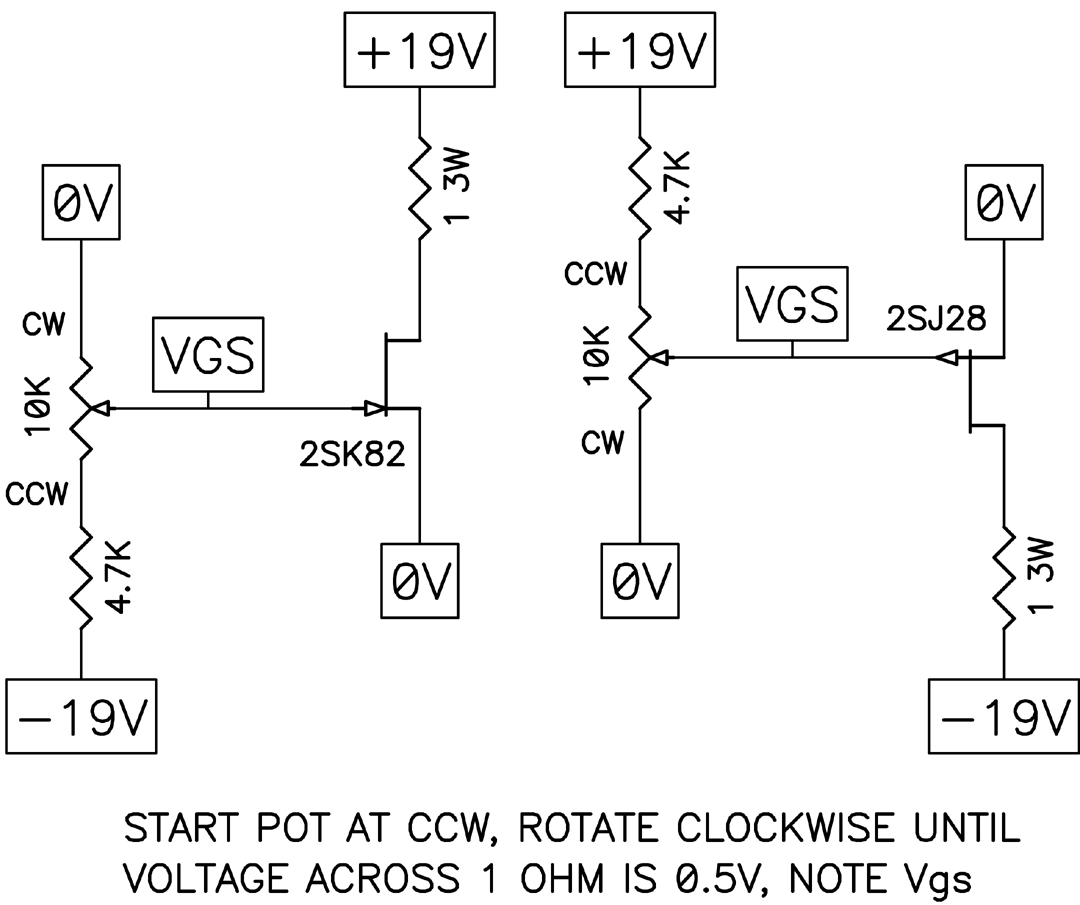

See attached diagrams. The gate voltage MUST be present before you apply any voltage across source-drain. Adjust gate voltage to start passing current though the VFET (mount to some kind of heatspreader), bonus points for measuring Vgs @ 0.5A Ids (which should correspond to the number written on your VFETs).

Unfortunately this sort of condition is difficult to verify completely without a curve tracer.
You can in principle measure if the VFET works using an ohm-meter and a 9V battery with 1k resistor in series.
The ohm meter is connected to D-S (+ on D for K60, - on D for J18).
The battery with 1k in series (there MUST be a resistor in series to guard against an incorrect connection) goes between G and S (+ on S for K60, - on S for J18).
Here is how you measure:
1) Just use your instrument to verify a diode between D-G and S-G. If the VFET does not pass this test, it is dead.
2) Connect S to G (you can use a short circuit, but even better is if you use the 1k resistor). Then measure resistance between D and S (instrument + on D for K60, - on D for J 60). The VFETs should measure 1-2 ohms (depends on the current the instrument passes through the device under test). If it's radically different, the VFET is dead.
3) Connect 9V battery in series with 1k resistor between G and S (battery + on S for K60, - on S for J18). Then measure resistance between D and S as above. The resistance should be MUCH higher than in step 2 - depending on your instrument it can varu a lot but it will at least be tens of k ohms, usually it will show open circuit. If it shows a low resistance the VFET is dead.
HOWEVER. When Vgs=0V and resistance measured is in the low ohm values but not below 2 ohms, there may be a problem with leakage or breakdown damage which results in dramatic reduction of gate sensitivity, and low Vdg and Vds breakdown voltage. This is not easy to measure but a curve tracer will show it immediately.
Specifically regarding TA-N7: PREVENTIVELY REPLACE THE BIPOLAR OUTPUT TRANSISTORS which are used in the BJT-VFET cascode output stage. I've written about this before, to make a long story short, these tend to break down and in various ways take the VFET with them. If they go short or leaky, they can easily destroy a VFET by simply making it permanently on. If they go open, a more insidious mechanism results, that degrades the VFET very similar to your symptoms by provoking Vgs larger than the specified maximum. In time, the VFET gate to channel interface breaks down and the VFET will start behaving strangely, leaking and resulting in full breakdown of it's mated BJT, in turn destroying both.
The preferred substitutions are D44H11 and D45H11.
I followed the 3 steps and there is hope, the 2 vfet had passed the test successfully!

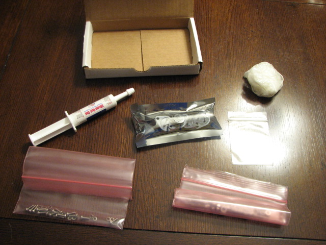

Ordered All This stuff some while ago and am beginning to read up and figure out what I need. Attached is a pic of the kit I received. It seems like there were some other parts kits available back then, but this was the only one I could lay my hands on.
A few questions about needed stuff if I may:
I know I will need these pieces:
UMS compatible TO3 mounting brackets (US warehouse) – diyAudio Store
which are out of stock, hopefully there will be more?
Is there a BOM of all the parts I need to acquire, I see one referred to in a few posts but have not located it.
Is it the 4U "jack of all trades chassis in the build guide, or the 5U?
