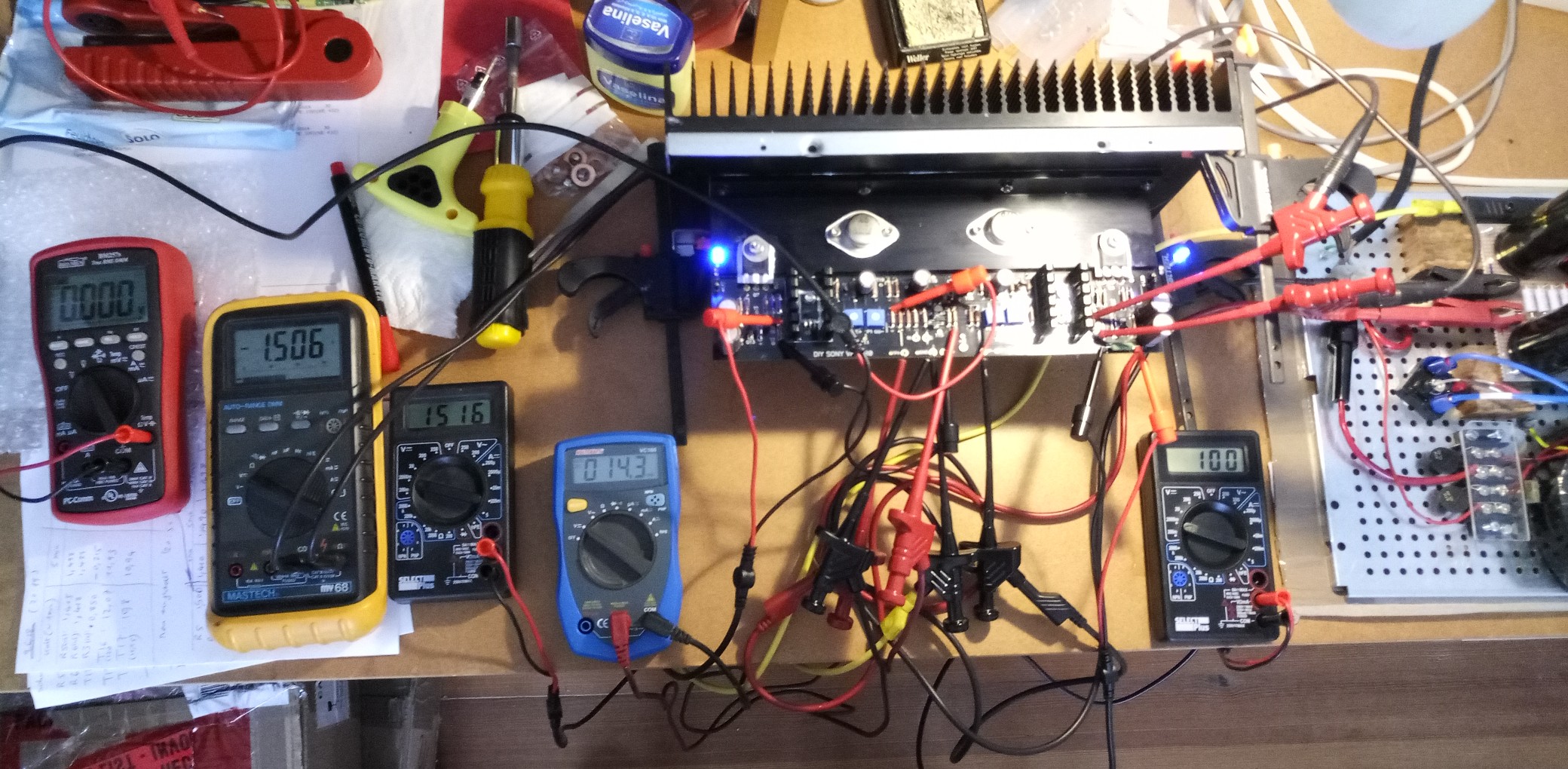

VFETs are now in place. after approx. 1h warm up , following values could be set:
R5: 1506 mV
R6: 1516 mV
R31: 0-30mV
R32: 100mV
output DC: 14mV
I am going to build the other channel during the next days and then check the sound 🙂
many thanks to you all, especially nelson, for this nice project and all the support.

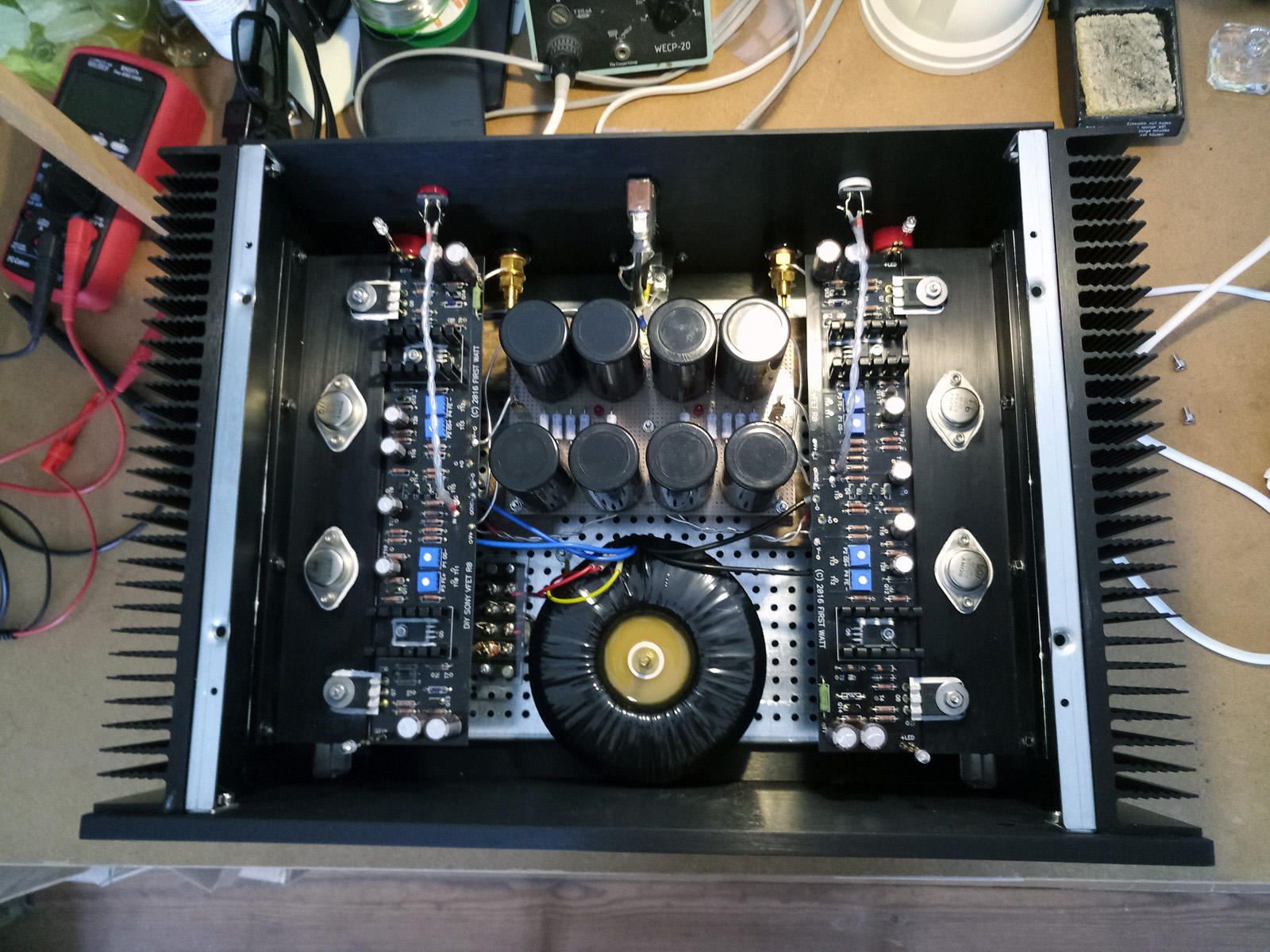

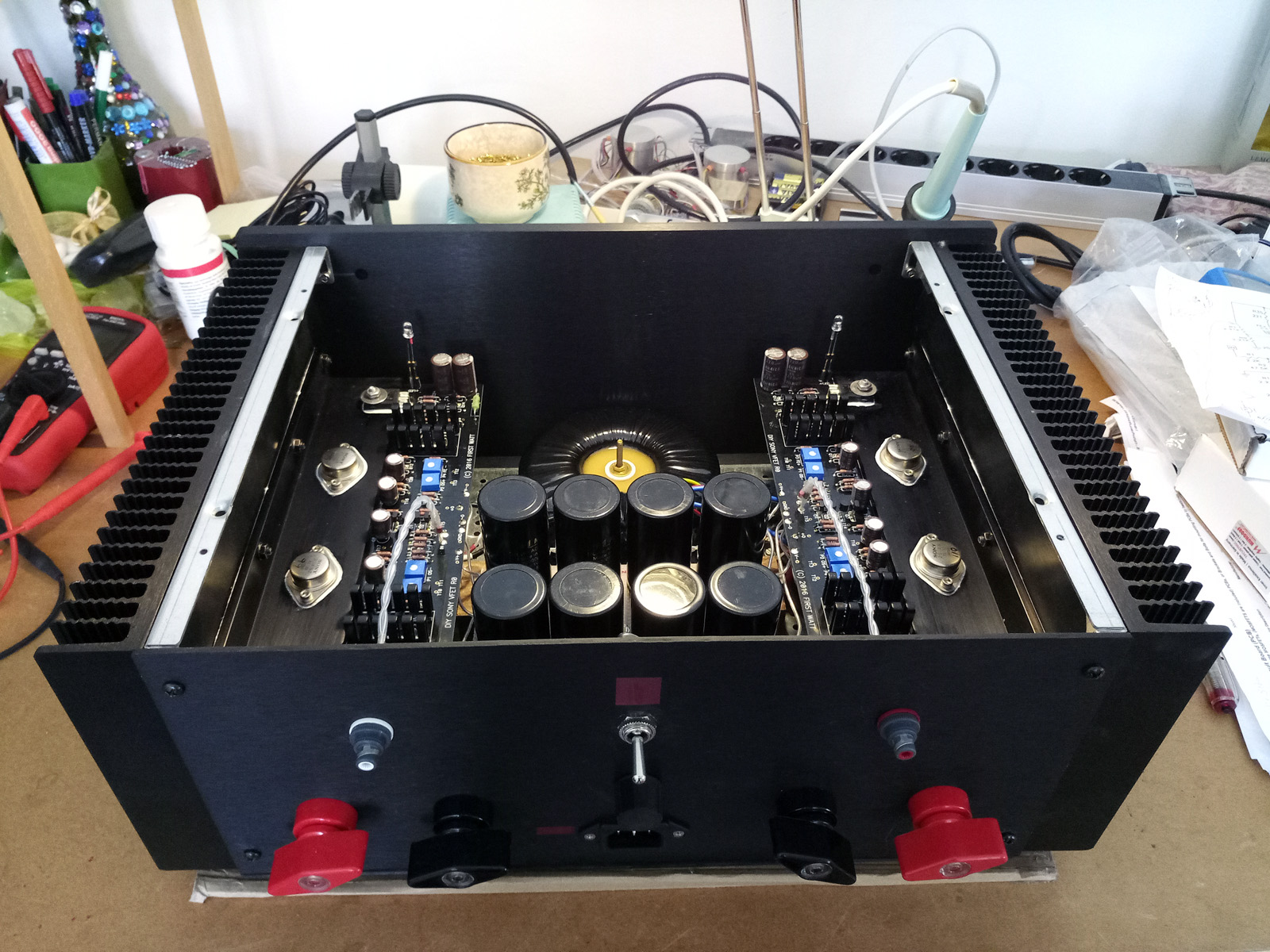

hi everybody,
today i finished the amp. i measure followings:
cold (after 1 minute):
..............left channel / right channel
output DC: 90 mV / 61 mV
R31(T18): 212 mV / 370mv
R32: 106 mV / 107 mV
warm after 45 minutes:
output DC: 20 mV / 8 mV
R31(T18): 1 mV / 1 mv
R32: 100 mV / 102 mV
I think these values are ok. But for the PSU I measure with both channels connected just 26,7 V. (with one channel it was 29,5 V ). the voltage drop over the R19 and R20 is 2,7 V which should still be sufficient according to Nelson. However, before I go forward and connect the speakers , I want to make sure if there is any need for further actions? any suggestions?
thanks and regards

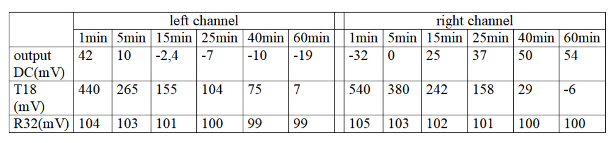

The only thing I would ask is if you did the final adjustment after warm up
with the lid on. (In case there is some difference because of temp)
Happy listening.
Happy listening.
hi zen mod, bare and dennis,
many thanks for the feedbacks. i will go and connect the amp to speakers today 🙂
indeed, the situation changed as i put the lid on 🙂 i had to re_adjust the settings again. the amp gets almost stable after 60 minutes ;-)
i get following settings now with the lid on (please see the attached image).
@bare: the vaseline was used for a plaster cast 🙂 . but maybe i could give it a try and oil the VFET engines too :-D
i was lucky to have/find some DMMs. they were very helpful for setting the amp. i was propably lost if i had to do it with just one DMM 🙂. as a matter of fact, i use 6x DMMs to set the amp with the lid on :-D
i will report when the amp is playing music ;-) . many thanks again!
best regards

update
update:
the amp plays music 🙂 very nicely, dynamic, transparent with a dark background.
let me give him around 100h of playing time before i compare it to my single-ended 300b ;-)
at this stage may i send again lot of thanks to everybody, especially to nelson and the diyaudio team for making this experience possible!
best regards
update:
best regards
