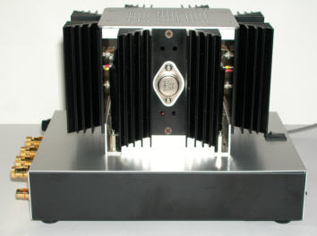

Here's a photo of one just before it went off to CES.

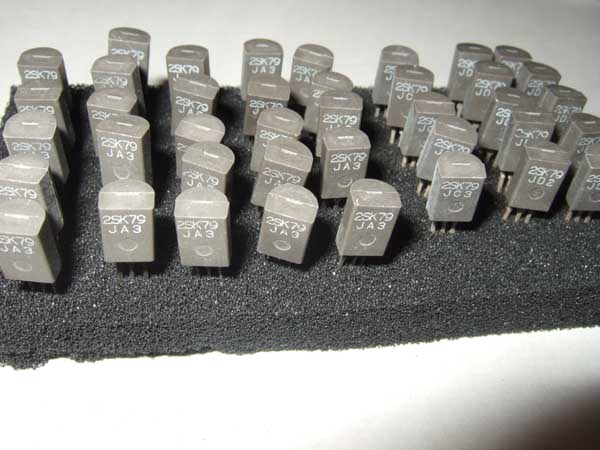

I thought I bought enough VFETs from Acronman, but it seems I am a little short.... Well, I do not need 250 W, I need more time!
Acronman is a very reliable supplier IMHO.
I'm in the middle of matching 230 pair of K82 and J28, but of the
KE33 rank. I'm testing for Vgs at 20V Vds and 0.5 and 1 amp,
transconductance and Drain resistance.
It's very tedious.

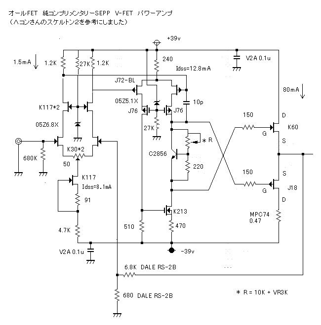

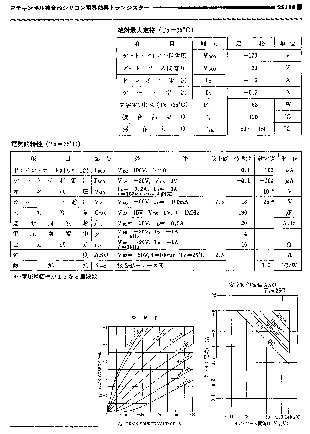

Interesting blog pages with links about SIT's V-Fet's with DIY schematics.
???? Oldman's Note: V-FET / VFET / SIT ?????
http://www.geocities.jp/mutsu562000/root/amps1/htm/hp005.htm
SONY 2SK60£¬NEC 2SK70£¬YAMAHA 2SK76£¬SONY 2SK82£¬YAMAHA 2SK98²»ÍêÕûʵ²â - ¡¾µ¨»úÖÆ×÷ÓëÐÀÉÍ¡¿ - ÒôÏìÖйúÂÛ̳¡ª¡ª×¨ÒµÒôÏì¼¼ÊõÉçÇø! - Powered by Discuz! & Audio-audio.Cn
Google translation can be used
Hope you enjoy it
Hope you enjoy it

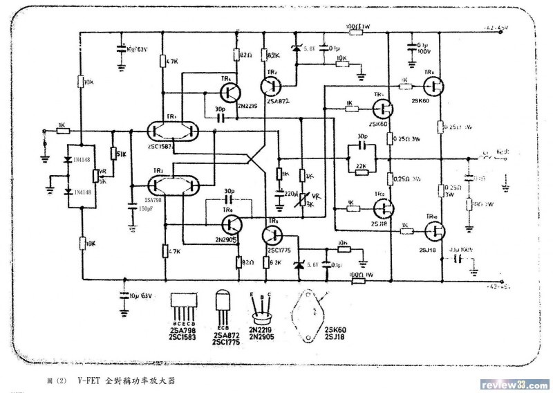

Mmmmm much better 😉 maybe I just have a bias for simple circuits
Seems like an early eighties input stage, maybe even late seventies. What is it? Who is the designer?
