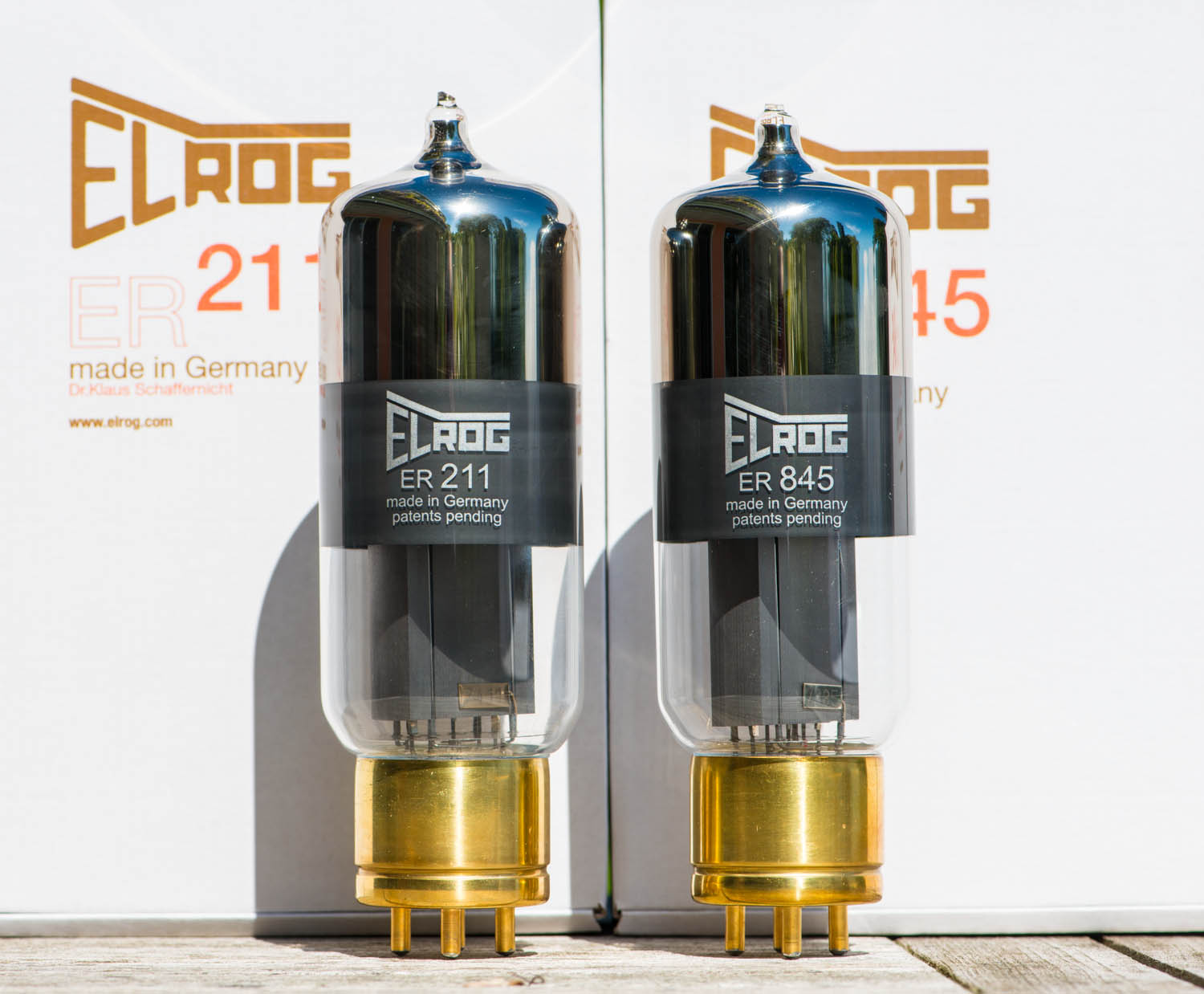

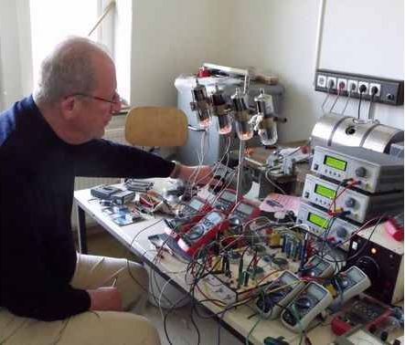

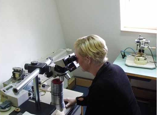

European revival become from ELROG company in Germany
direct heated hand crafted triodes 211/845 delivered 20 watts
be in production at small factory&lab.
In 2014 we see probably first new 300B from this passionate and smart team

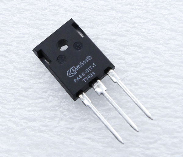

My questions for Mr Pass and DiyAudio gentlemans is:
SIT and Vfet transistors what the future for next generations of music
lovers?
Vfet and SIT's solid state revival and developement like high standard audio for 21 century bring back at large scale for humanity why not ?
😀:Yes do it today🙂
ClassD with Vfet's Sony TAN-88 sound interesting amplifier or vintage curiosity?

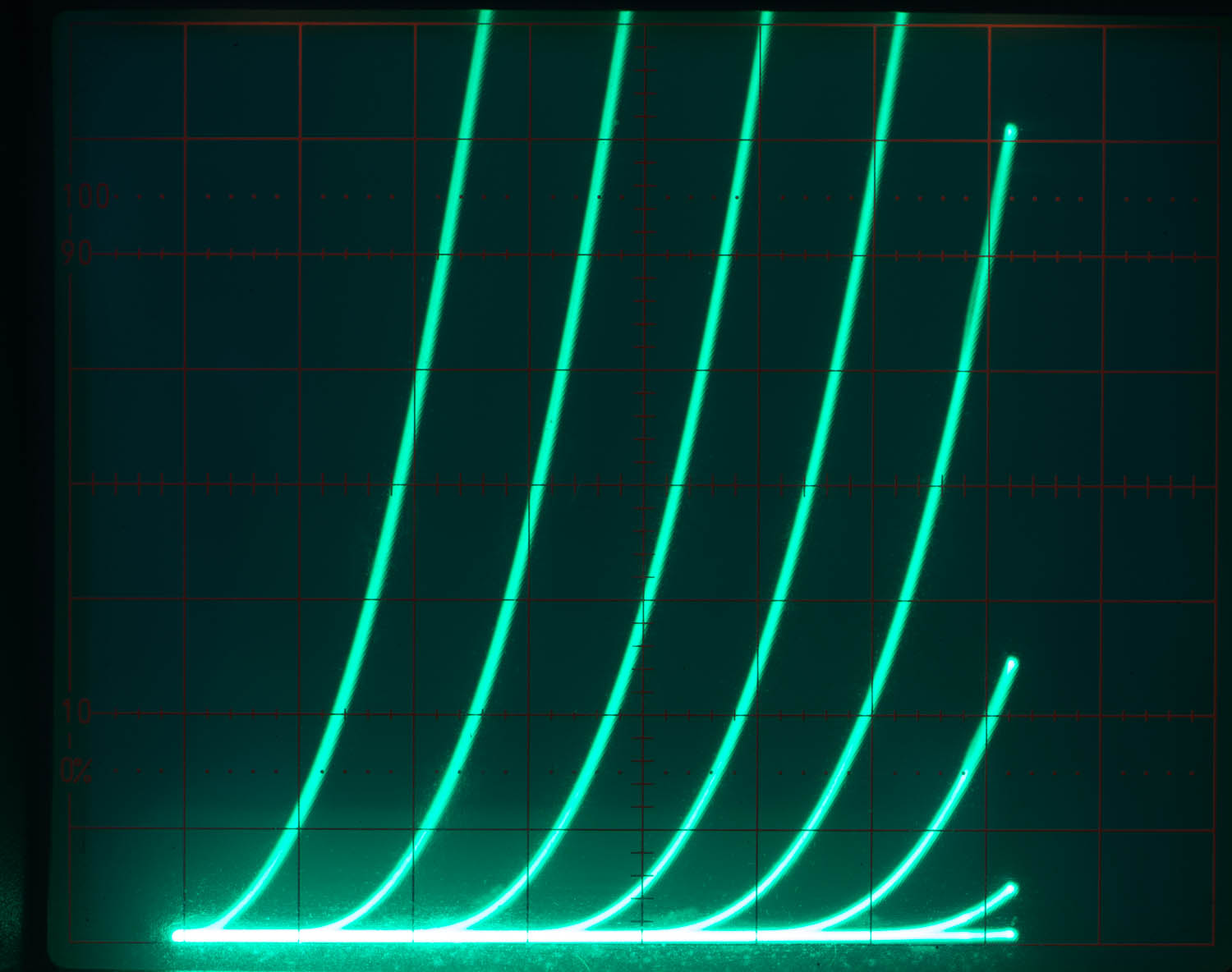

I've been thinking about the triode "characteristc". (Not like I complete understand it.) Is there a tube or transistor characteristic that goes beyond triode? Is it limited by the the 2nd and 3rd harmonic? Does it have more to do with the curve characteristics of a tube or semi?
I've been thinking about the triode "characteristic". (Not like I complete understand it.)Does it have more to do with the curve characteristics of a tube or semi?
Hi Vdi_Nenna
Every day transistor for audio amplification have much
like pentode tube characteristics.
Vfet or Sit be triode tube " equivalent " in solid state technology.
Vfet SIT transistors have very similar tube valve triode curves
very linear excellent for audio reproduction and
with no output transformer needed and this it easier
to have large bandwith response.
Cheers

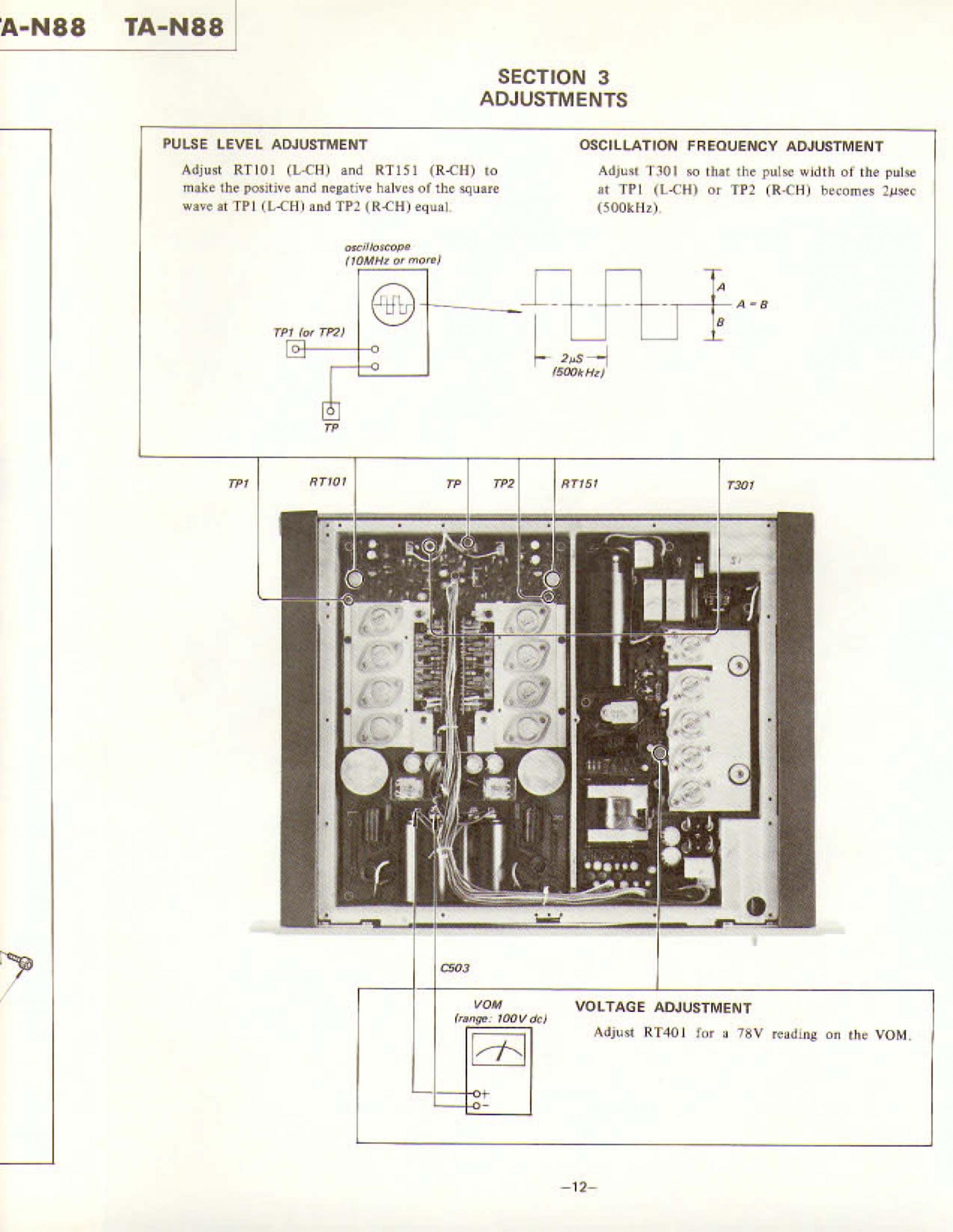

Nice page about Sony class D amp with Vfets
click user or specs for more informations.
Best regards
Sony TA-N88B on thevintageknob.org

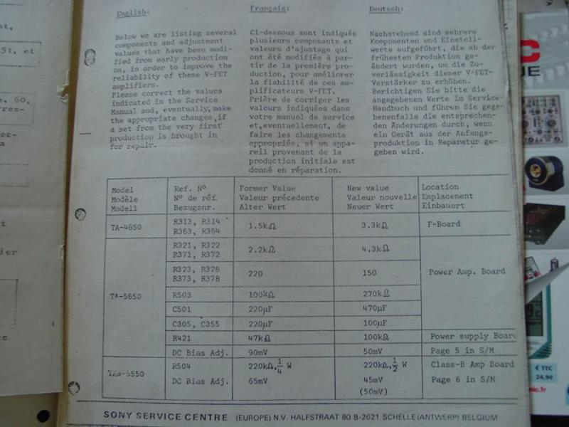

Schematics with Vfets from Japan and one more vintage Vfet amplifier
Sony TA-5650 on thevintageknob.org
Have fun🙂
