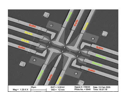

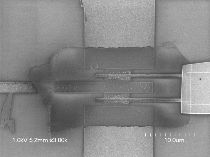

Today electronics have posibility to operate in nano scale.
Carbon nanotube field-effect transistor - Wikipedia, the free encyclopedia
other is a Vertical Slit Field Effect Transistor

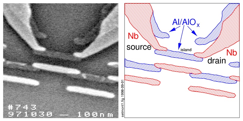

Single electron transistors or graphene be relatively new but miniaturisation and precision is huge to compared with early days and cost is lower...
make mass production of triode like characteristic transistors be very apreciated in audio aplications any news about?
Maybe Linear Systems make them real?
What Yours Science-Fiction-Transistor :bulb:?
