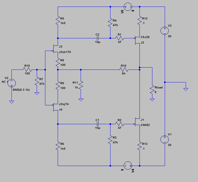

One more with V-fet's amp schematic
This design has two issues to keep in mind:
1) It requires a regulated power supply for bias stability.
2) The bias voltage is subtracted from the output voltage swing.

I always knew that there is some interesting biasing scheme in Universal Tiger , which I can use for SIT

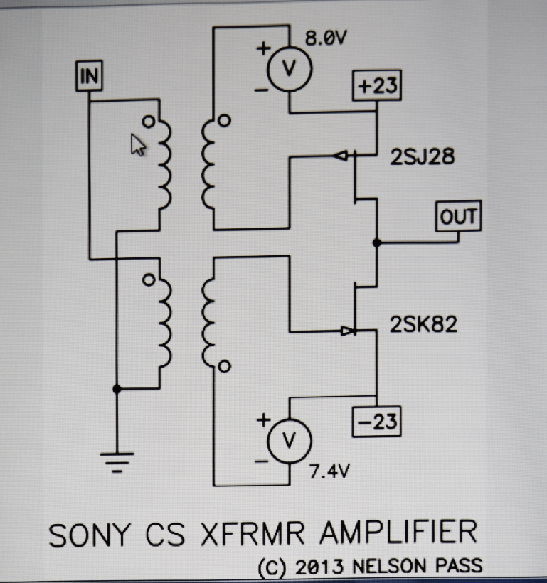

Here we go:
Very interesting, thanks !

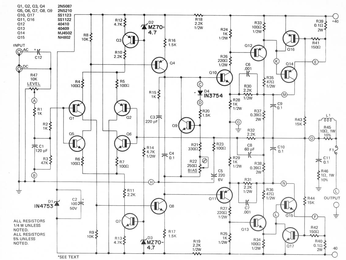

Here are links to the arcticles that describe the schematic posted by Nelson.
Very interesting reading, and confirming what ZenMod figured out some posts earlier than me: interesting bias and protection circuit.
I also like the input stage..maybe with some 2sk170/2sj74's.
Radio Electronics March 1973
Radio Electronics April 1973
