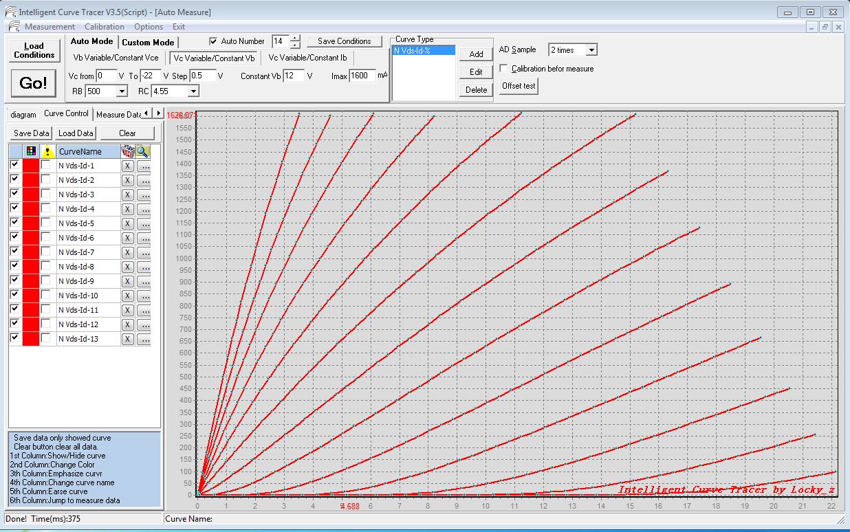

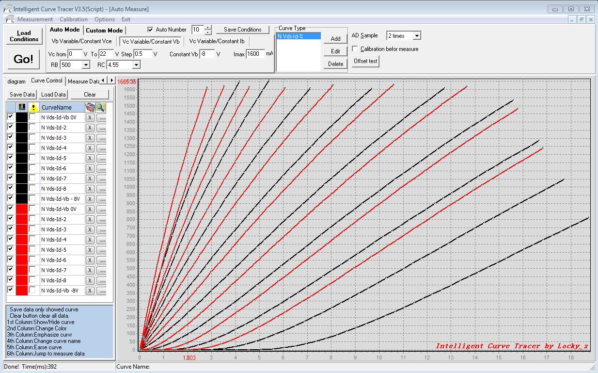

Hello generg. I hope that you are well. Do the plots for the Taobao devices mean that they are still VFETs which are out-of specifications; meaning that they were rejects for use in SONY or Yamaha hi-fi amps?this time I had no good luck…… :-(
I bought at Taobao two pairs of SK82/SJ28, 200 Yuan the pair.
https://item.taobao.com/item.htm?spm=a230r.1.14.140.l4ezPb&id=40300679359&ns=1&abbucket=18
look at the four flat curves, these are the new ones,
the four steeper curves are two pairs from Acronman I already had……
The vendor even lifted the price from 200 to 300 Yuan/pair.
the zeners protect the Sonys, omit them simply and do not jumper them….
Am I right?
Walter asked the same…. 🙂
after some tea and disappointment swallowed away I will look for this…
I suppose they are the ones with less transconductance
2SK60/2SJ18, with one die only…
https://item.taobao.com/item.htm?spm=a1z10.1-c.w4004-11665682645.19.UsLhPq&id=40300123246
offered from the same vendor…..

o.k. more stuff concerning Taobao offer!
the good news: they are SITs!
the bad news: these JE types do not fit in any way to my Acronman stuff, so if you want to complete your Acronman SITs with these from Taobao the chance to get fitting parts to have more pairs could be very low.
When you order only from Taobao, let us say 10-20 it might give pairs as well.
Left picture: two SK82 JE from Taobao source
right picture: one SJ28 JE from Taobao source
