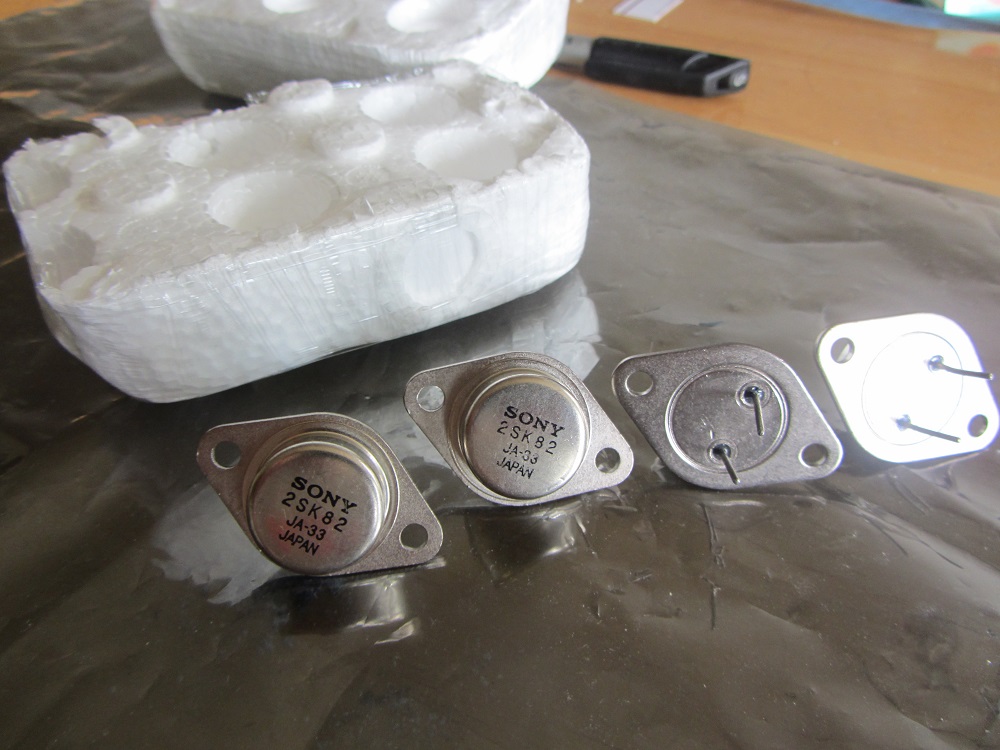

I received 4x 2SK82 from Aliexpress.com : Buy SONY 2SK82 V FET from Reliable fet transistors suppliers on Eternal HONG's store | Alibaba Group today. I was initially skeptical due to the different packaging however they look genuine and measure less than 2 ohms source to drain. I will build frankentracer to check curves. The only thing is vendors photo shows KE-33 parts but these are JA-33 so i'm not sure whether these will work with SJ KF-33.

Hi Fatfreddy, how will deal with any mismatches? Your sample group is quie small so its possible you wont get good matches.
Hi Luke, I already had 6 off (plus 2 in CSX1) SK82's from Acronman, plus did not want to risk too much cash on unknown source.

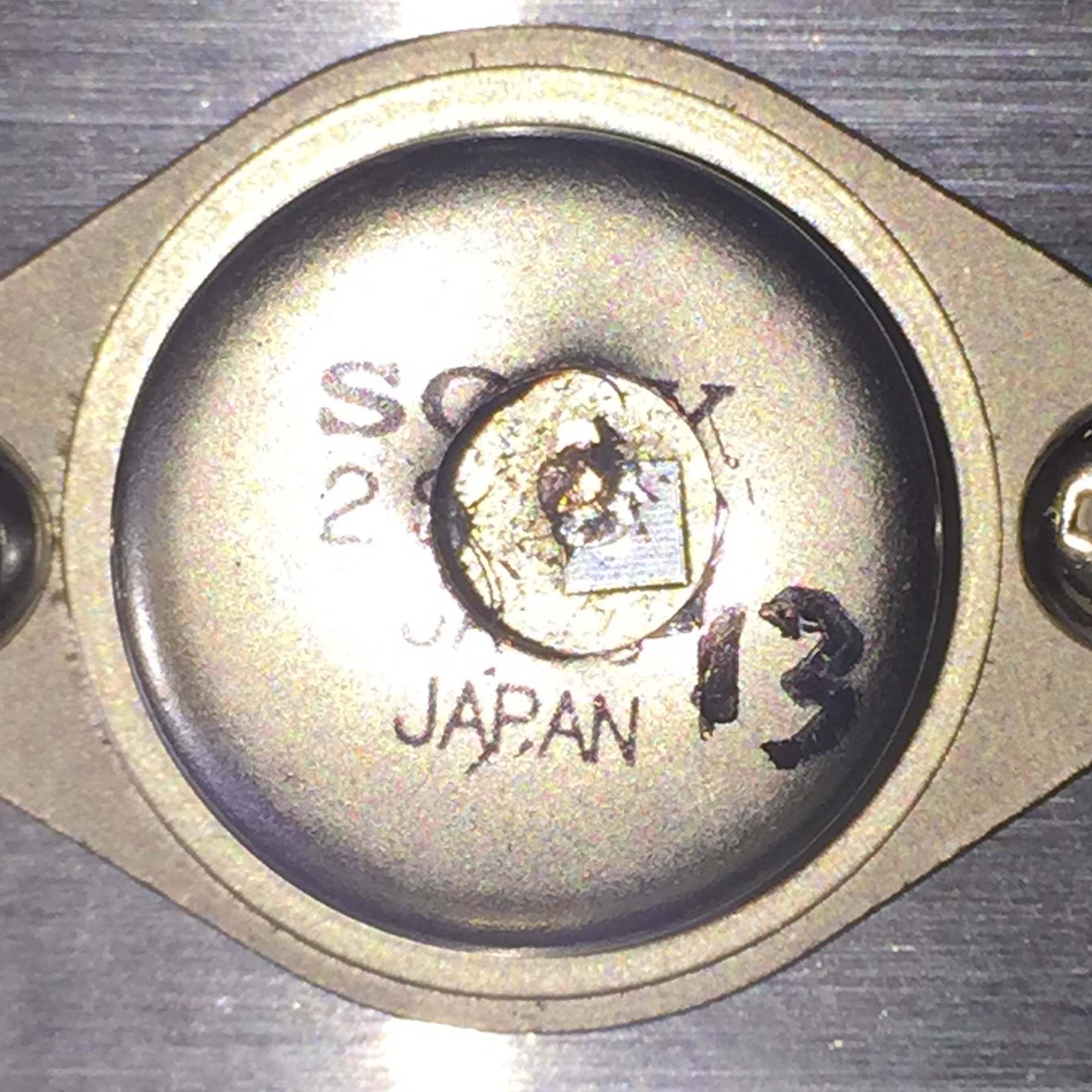

I drilled open one of those JA-33s, here is how it looks (this is a bad part, I don't waste these precious devices 🙂):
How did it became a Bad Part? Is JA-33 in the market now considered OK?
I'm not knowledgaeble enough to tell if JA-33 is considered OK, but I was helping some brave souls to order a few of these, so I tested them one by one before taking them to the post office and one 2SJ28 happens to be bad.
Something I can tell from the dozens that I measured:
- They do display the triode curves of VFETs, I tend to believe they're genuine Sony VFETs.
- As far as I can tell, the JAs are more linear than the KEs and KFs, but they have lower transconductance at the same time.
- With the lower transconductance, I suspected they might be re-badged 2SK60/SJ18. So I drilled open the bad one, but the chip inside seems to be a 4mm chip, so they're not 2SK60/SJ18 which have 3mm chip.

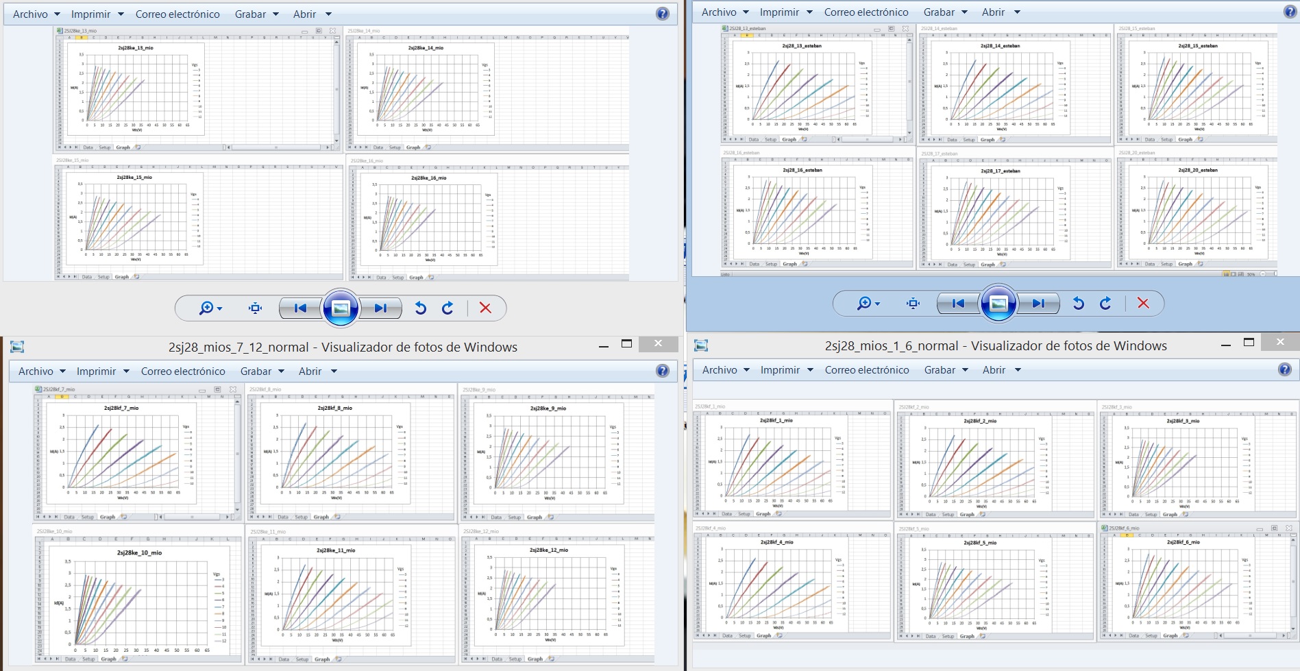

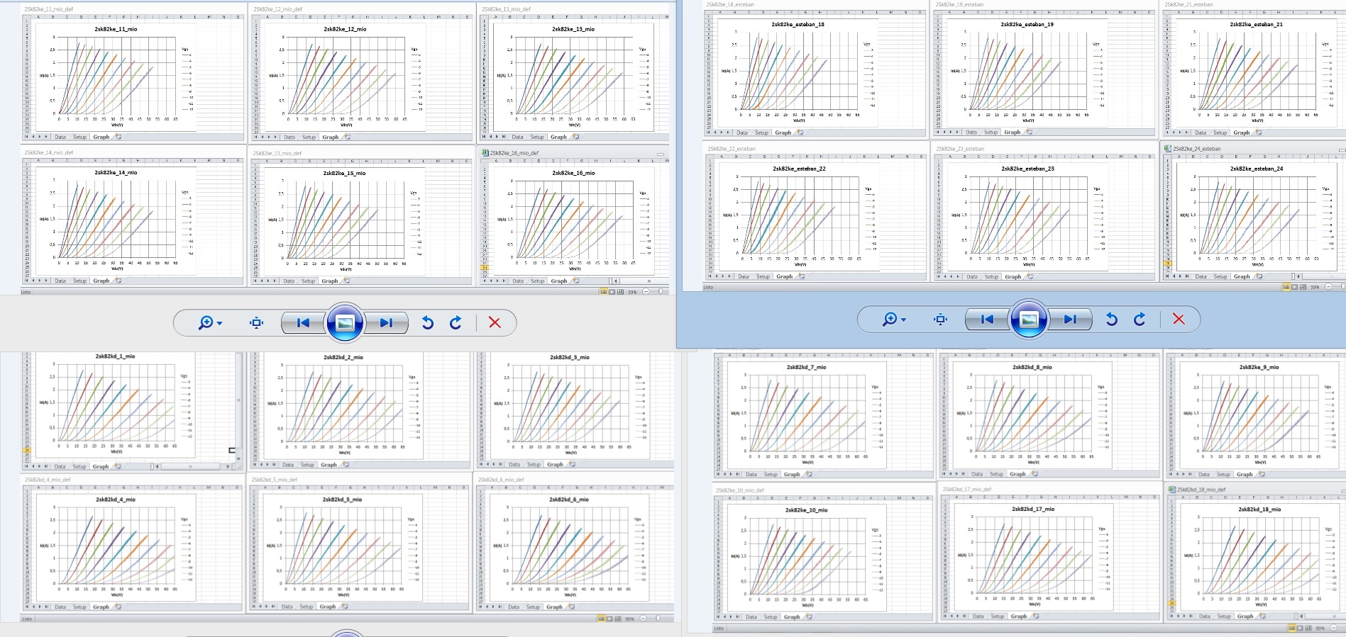

Hello all. I had got a lot of curves (KE, KF and KD types) and I have not find difference between them (types). Variability is big.
If JA type show typical curves, I think they will be good (always looking only curves). But until I receive them, measure and compare I could not be sure they are good (sure they are, Tim does a good job, thanks a lot, Tim). I think letters (KE, KF, KD, JA, ...) are batch productions (I can be wrong).
N type are better (curves) than p types, variability is lower. Look curves.
When I did the same with tokins (180, 182, 183 and THF51), we got a bigger variability than sony types.
Regards
This post suggests they are dual die - can you see a second die inside the package? AudioKarma.org Home Audio Stereo Discussion Forums - View Single Post - A Brand New v-fet design by Nelson Pass?
I remember to have seen a picture of an open 2SJ28 which had two dies, and Nelson commented something like that they are possibly 2 x 2SJ18 dies in one 2SJ28,
So maybe these are rebatched 2sj18/2sk60?
Somebody have to measure them, and post curves or data to compare with real deal Acronmans.

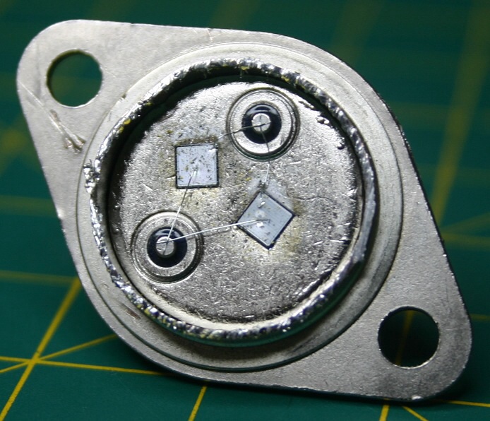

@ WalterW & Diyers
I remember this Mr Rothacher post about 2SK82 inside chips with photo :
http://www.diyaudio.com/forums/pass-labs/201655-lamp-simple-sit-amp-181.html#post3616492
Thanks Michael
@ Cwtim01 hope other chip is just not visible on your photo it need to be cut with saw for metal ?

All of the parts I got from Acronman are dual die.
See my Lab Hangout here, where we looked at them under a microscope:
https://youtu.be/dTqaR5qsT_0?t=19m30s
Try not to be overly paranoid about counterfeits, guys. Most of the counterfeitts I've gotten are pretty obvious, and no one is going to great lengths to make a part "act" like a triode. It's a SIT, or it isn't. Just be smart about your purchases and don't try to scoop up a bunch of expensive parts from an unproven source.
