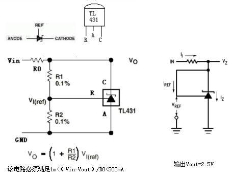

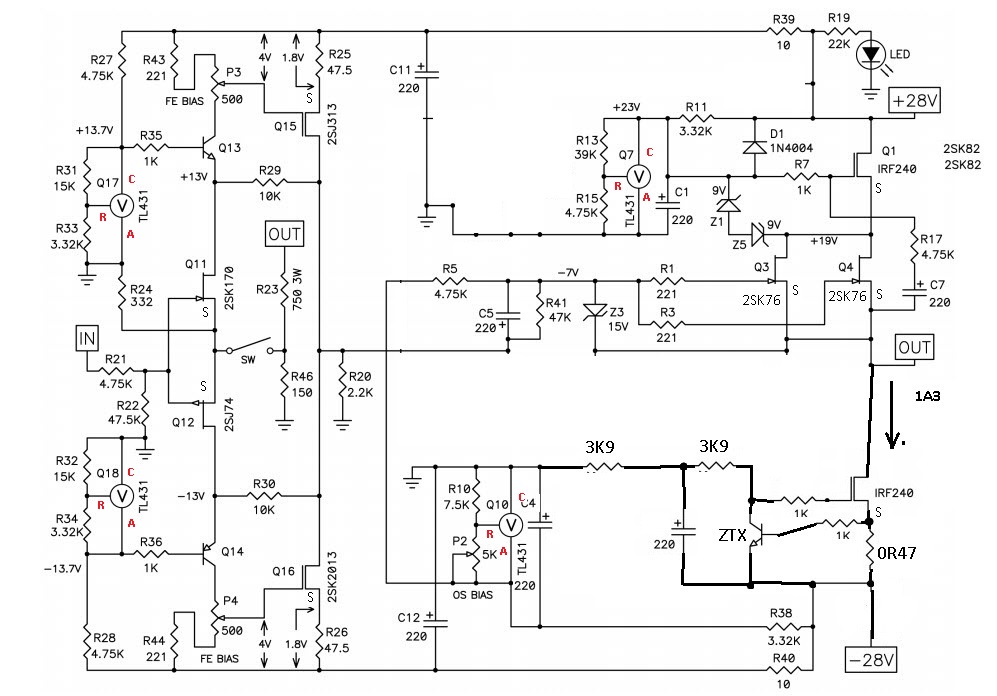

@ Zen Mod 🙂
could you please mark the anode, cathode and reference position of the TL431 in you circuit….
would be very nice!
I still twist my brain with this symbol showing no polarity Nelson uses.
would be very nice!

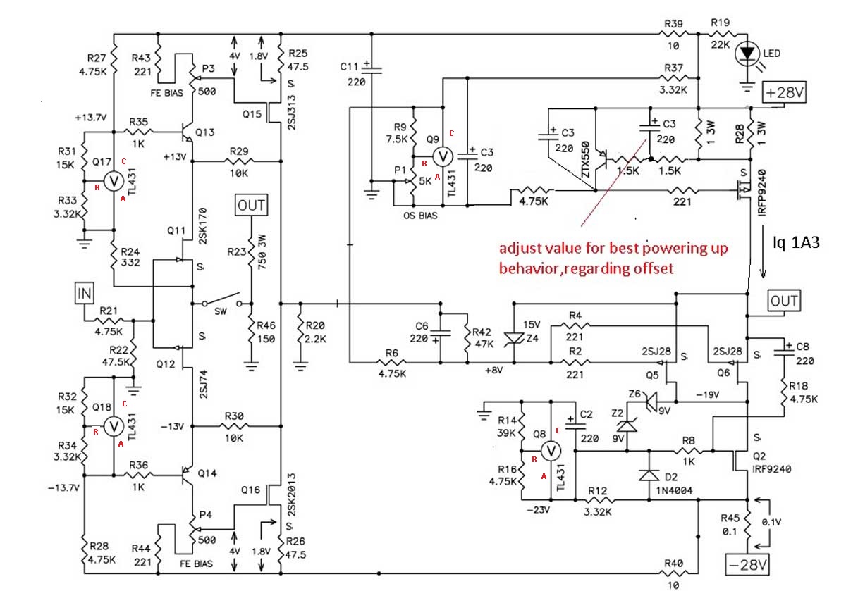

I wonder if two single jfet amps in biamp is a good way forward to get around matching. My preference wold be to build Nelsons original amp.

@ LukeI wonder if two single jfet amps in biamp is a good way forward to get around matching.
If this is your preference you need 2 pairs B grade LS jfets 8 mA Idss
for front end of this original Push - pull Part 2 amp see on schematic.
Jfets are out of stock today but they be back just hang around every day for
Attention little more advanced level project if compare with Vfet Part 1 CSX
or others diy Mr Pass amp's designs.
