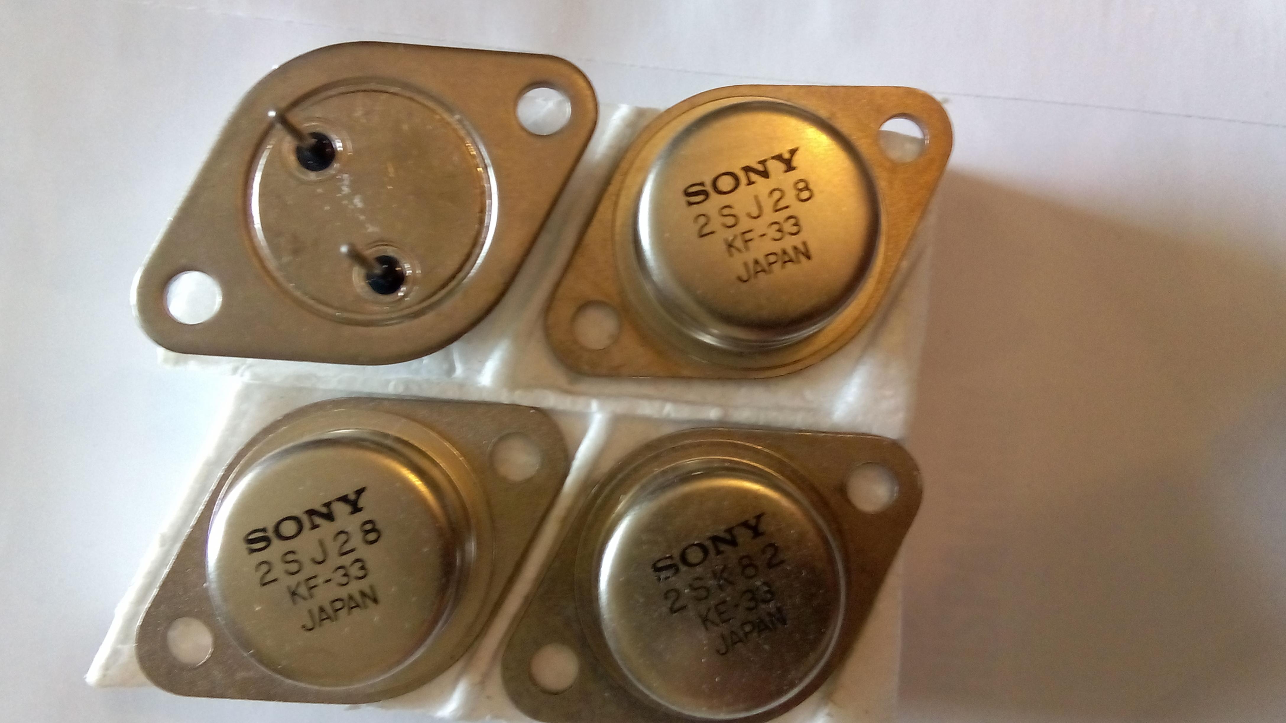

I should make a correction to that comment:
The real Sony's have a ring around the bottom, the fake parts are flat or have a shape like the one shown in the photo.
In both pictures, the real part is on the right.

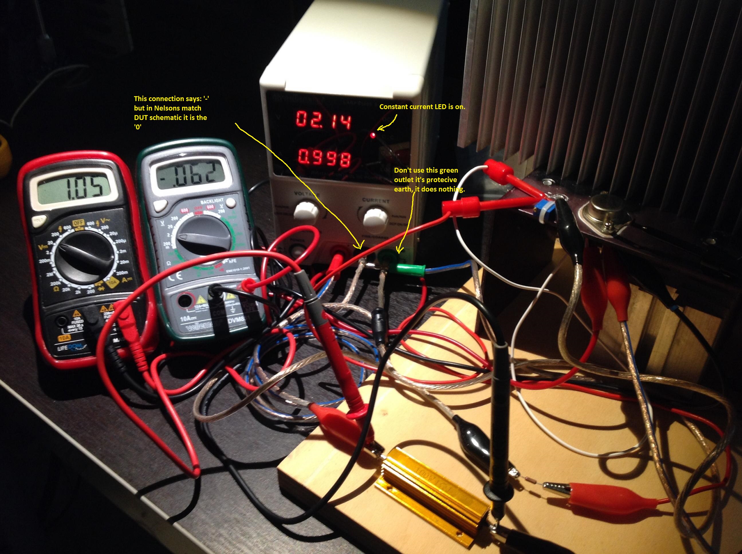

After Vgs DUT Vfet schematic i try mesured Vgs but voltage across 1R don't change
if i tourn trimmer it is because limit max 1 A the current on psu or something else ?
Thanks for your answer 🙂
? strange, do you have voltage across the 1 Ohm resistor? Say 1 Volt then the current limiter is doing it's job. Or don't you measure any voltage across the 1 Ohm?
Pictures maybe?
Pictures maybe?

@WalterW
That my chance WalterW you are on line 🙂
Voici the pictures with voltages connections verified ok.
Greetings

I see only 1 LAB PSU, where is the other?
Oops i have only one lab psu but i can build quickly separate bias circuit
with 15 v transformer ,bridge, caps , 7912, resistors 😀
Is ok ?
Yep, but 12 volt from 7912 can be too low, or better use two 9 volt batteries in series for the bias, much easier.
Psu have (+) and (-) polarity green ground was in my interpretation (0) point on schematic but ok i was wrong...
so now i need separate 19V bias (-) and other19V (+) on drain yes ?
What is (0) point ? Common of multimetre yup ?
Thanks WalterW
Thanks WalterW

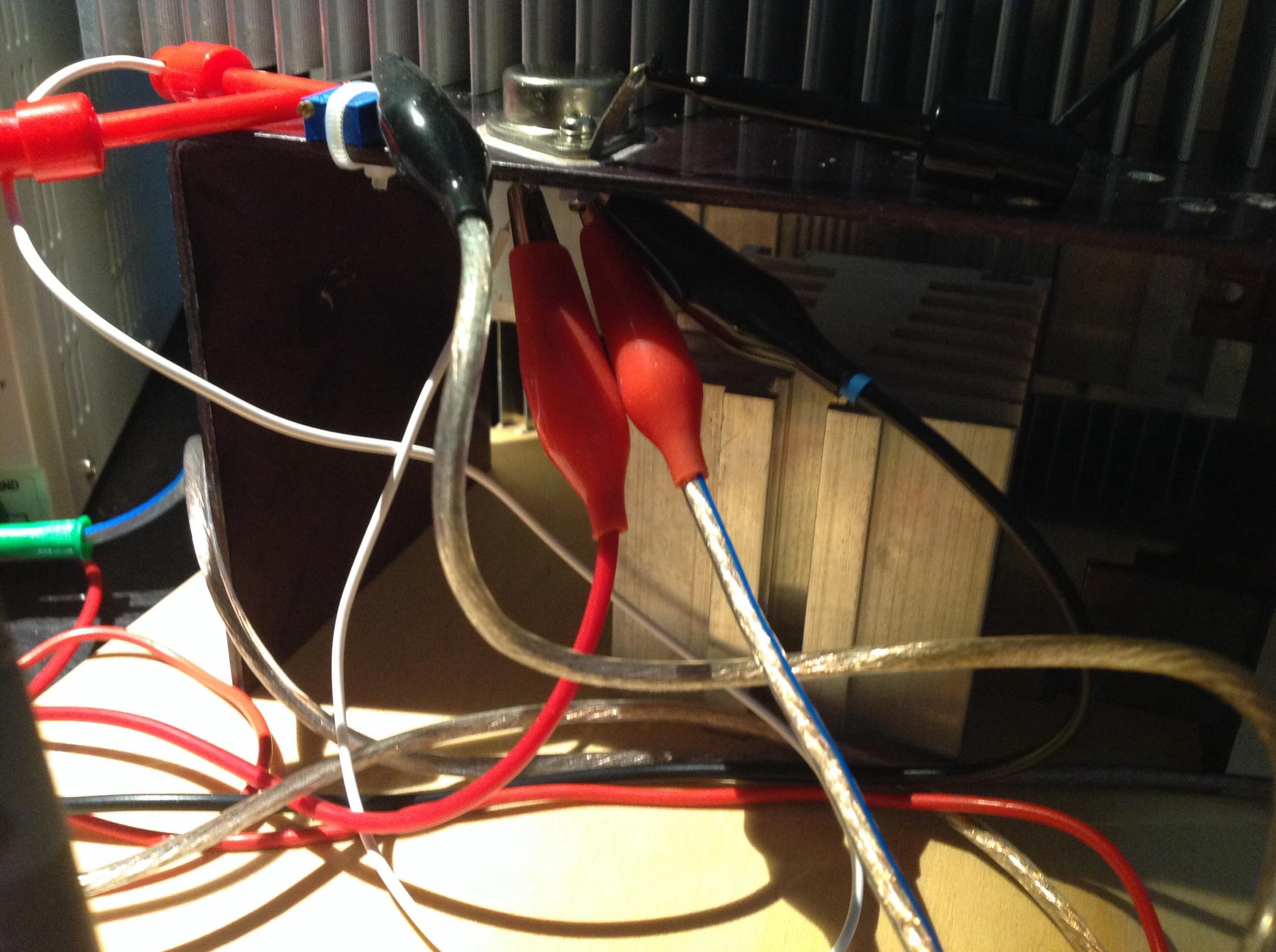

Hi Soundhappy, It looks like you have the bench supply set to constant current mode instead of current limiting which is limiting the voltage to 2.1V. I am not familiar with that supply so could be wrong.
Soundhappy try it this way:
@ WalterW
Thanks a lot
All is clear so i limit current on psu to 1A to protect vfet dut.
0V is (-)(+) node point not common of multimeter or something else
i was " funny" 😀
Yes i try this one with better understanding.
