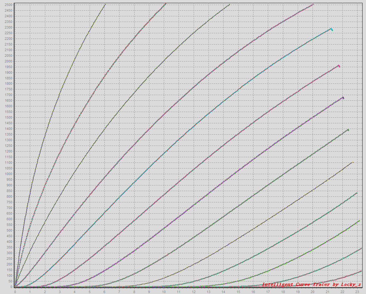

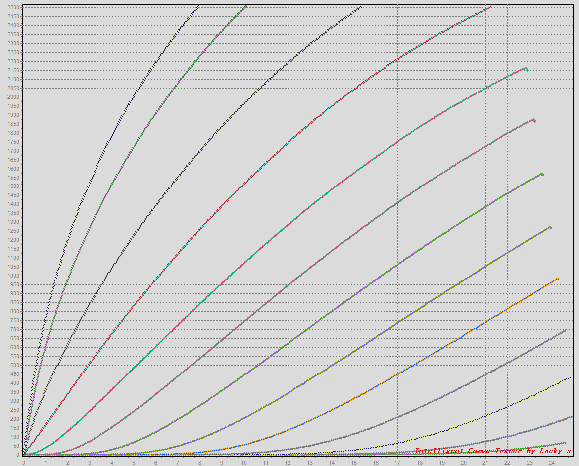

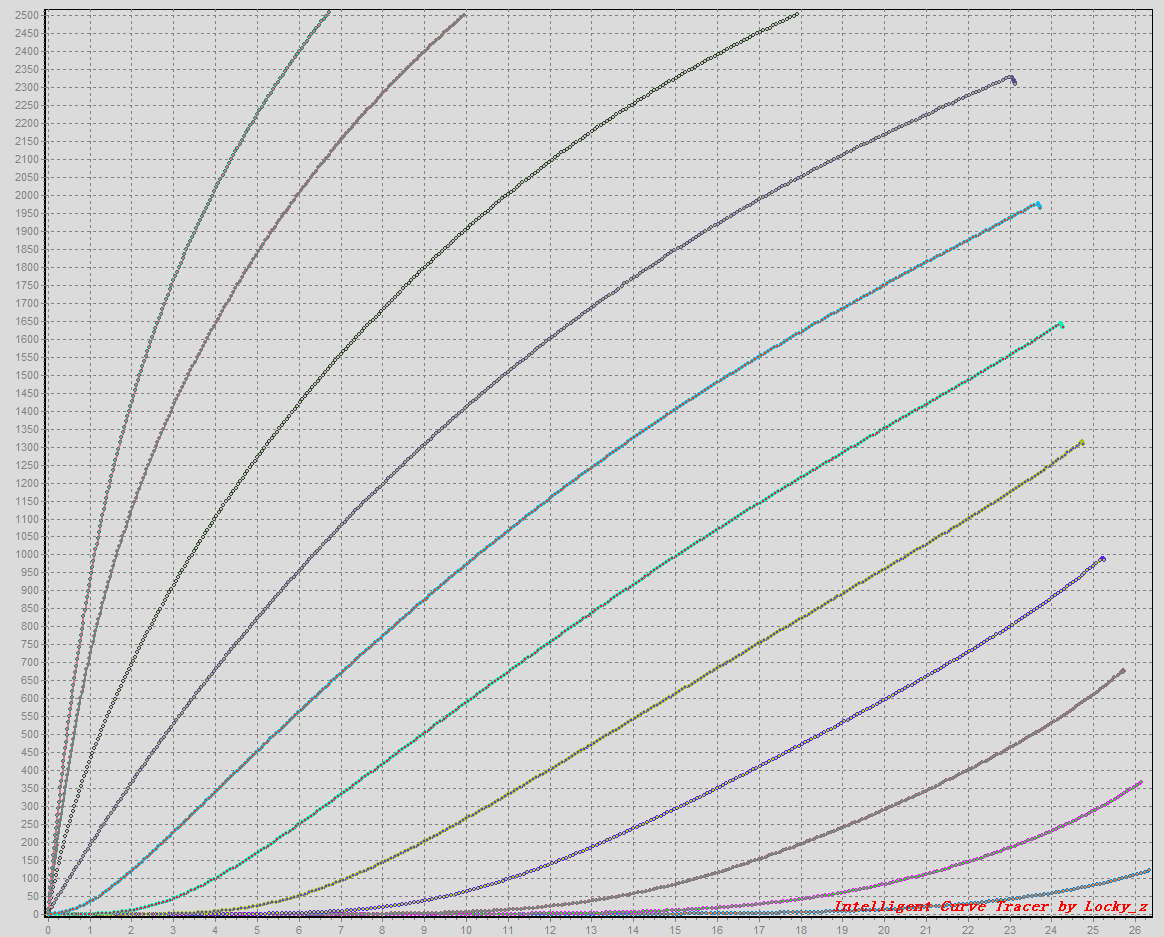

I believe you're referring to the 2SK82s that I sent you. Good to hear that the multi-meter test results are positive 🙂
I don't remember which exact 2SK82s I sent you, but if their marking is JF33 the hand-written number on them must be between 1-4. I happen to have kept their curve data, so here it is for your reference.
They look a lot like the ones I have, assuming similar axis scales.
I haven't run across any samples that didn't work fine, and if paralleling
parts I think you can just use Vgs matching and be happy.

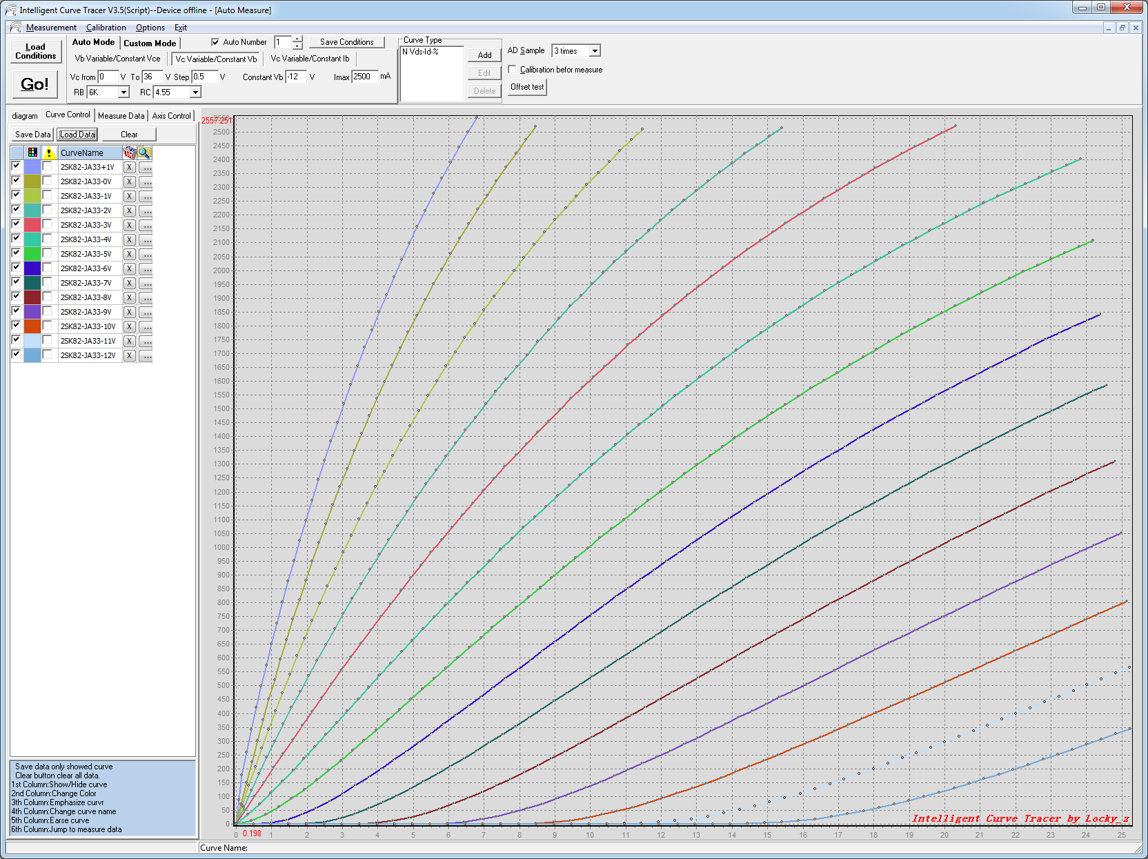

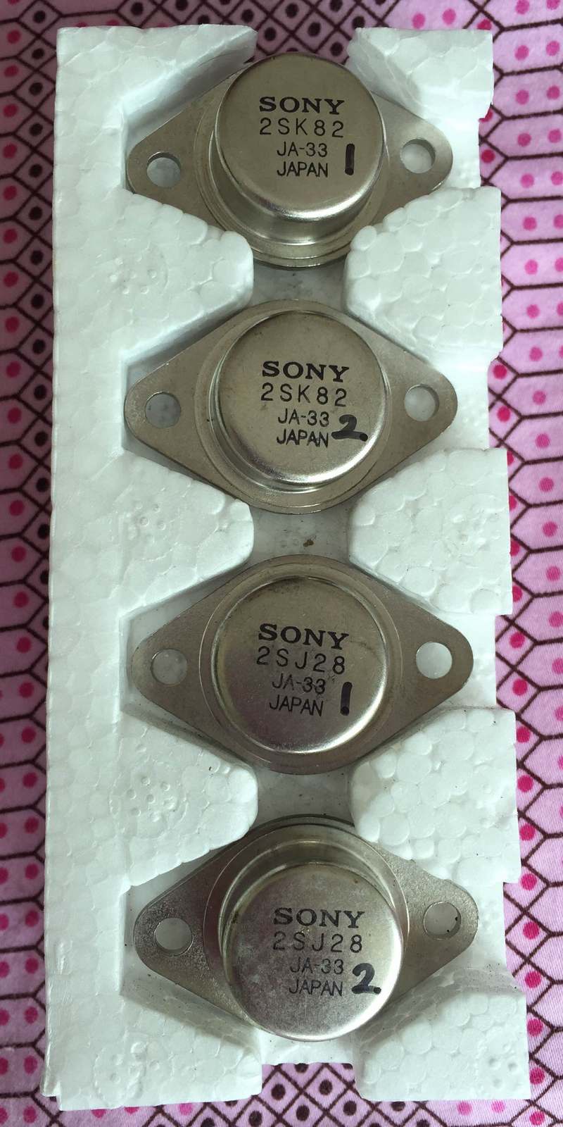

JA-33
... I'm so lucky that i have a colleague worker who is located in china and help me to buy 4pairs (is it enough?), and hopefully they are genuine ...
To be sure I didn't refer a bad source to this forum, I ordered 2 pairs of VFET from the shop that I mentioned in post #76, I received them today and they're having markings of JA-33.
I measured them and they look genuine to me (curve of one sample attached), though the required bias level maybe slightly different with the KE-33s.

I have noticed that genuine Sony parts in general have the markings oriented along the long axis of the part and they are flat (smooth) on the bottom. The fake Sony parts I've gotten from various places, have the text oriented along the short axis and they have circles and other markings on the bottom of the part (because they are re-marked samples of whatever was lying around 🙂) Just FYI, for what it may be worth.
... My sincere apologies!😱
No apology is needed 🙂, it's normal for a buyer to doubt the authenticity of these expensive and obsolete parts. Every time I bought a Tokin, first thing I did is to check if they're fake/bad, and asked for refund if so.
This is exactly the reason I'm afraid to run a group buy, despite it could benefit many forum members, and it's still not very difficult to get these parts in quantity in China.
Thank you for taking the chance and letting us know. Other members

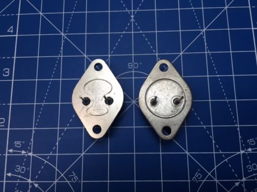

I should make a correction to that comment:
The real Sony's have a ring around the bottom, the fake parts are flat or have a shape like the one shown in the photo.
In both pictures, the real part is on the right.
