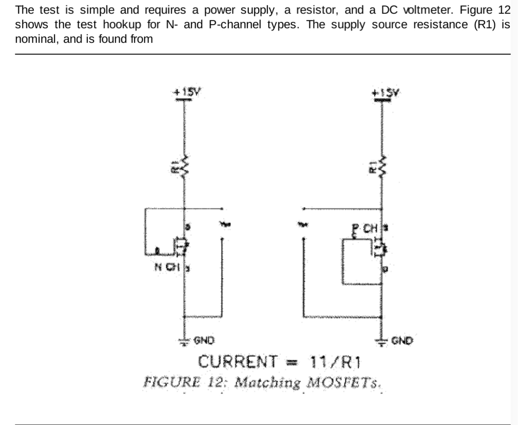

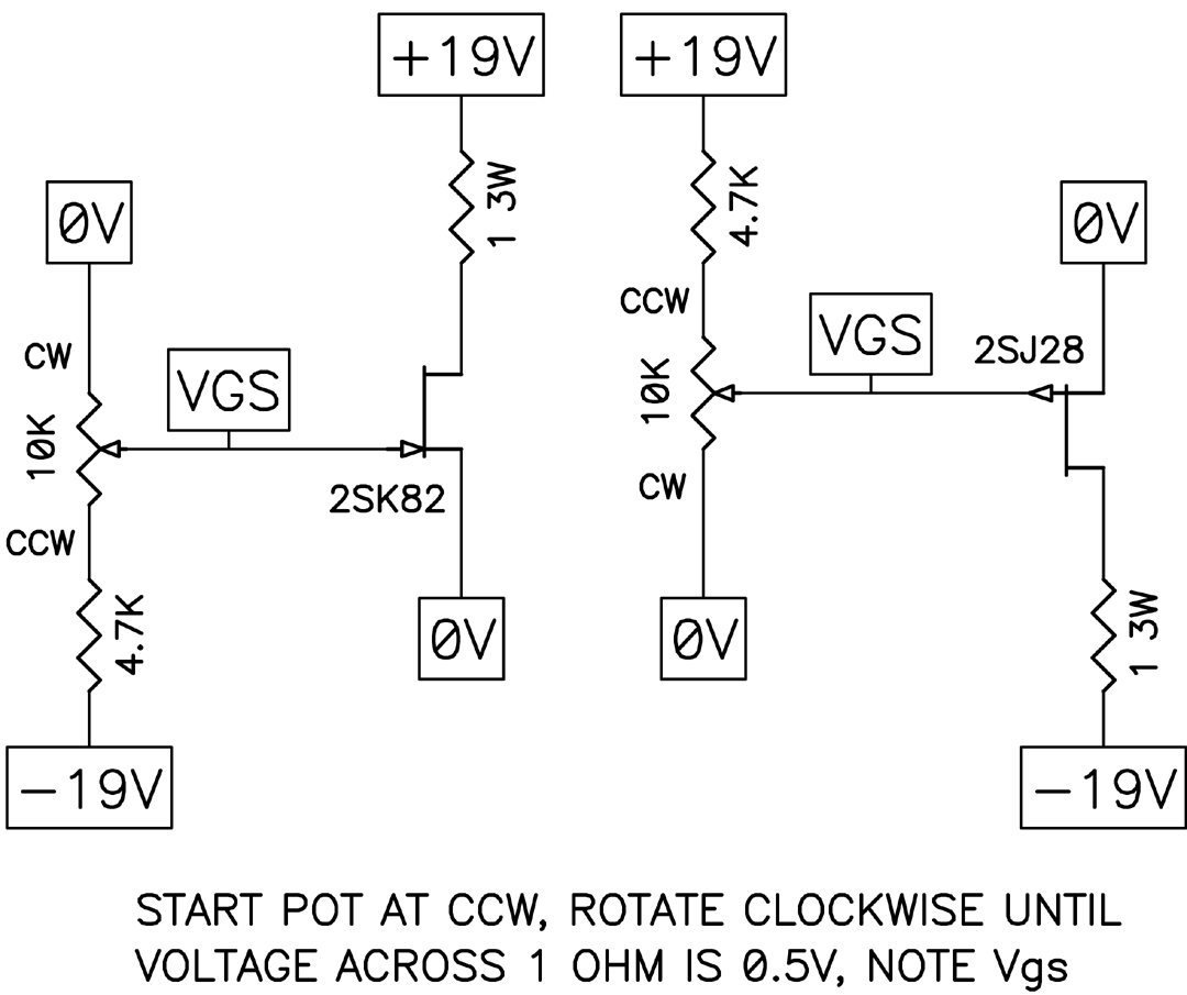

Official DUT schematic for N&P Vfet's Sit's ?
@ Mr Pass and Diyers
Any chance to have official schematic DUT vgs circuits for 2SK | 2SJ Sony Vfet's ?
I know is basic stuff for many people but help me avoid errors or make smoke poofff be highly apprecciated.
It was presented for mosfet's with psu, resistor and multimeter for n & p channel.
Any circuits
Any circuits

Here is an example test setup
Thanks Papa Diy Cool
Kind regards
Ready for Vgs tests 🙂 Sony's are on heatsink with mica & "polar snow"
I collected all parts after schematic and see parameters this evening.
Ccw direction on trimmer show me now 0 R it is ok like start point ? Yup ?
Thanks Mr Rothacher for useful Vfet pictures who help avoid mistakes
Greetings
Maybe a quick check with the multimeter to verify actual resistance set by the trimmer?
Yes i have minimal 0 ohm resistance on trimmer
but maybe we need 10Kohm ? That question :
i know is better to ask and don't cry after rare diamond
have burn or something

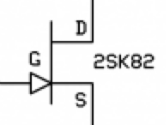

I just noticed that one of the 2SK82 I got to make the single pair version reads JF-33,as compared to KE-33 2SK82s that everone has.
I have no equipment immediately on hand to measure not even a cheap multimeter,but going just by looks,the printing is different compared to the rest of the VFETs, the case is matte,as opposed to the shinier cases of the others and a slight difference in can curvature. Is anything amiss?
I ask because of this-
2SK82 being unobtainum now,will there be any issues in getting this part to work?
any idea what JA-33 mean?
@Luke:
Is the Bath of production.
