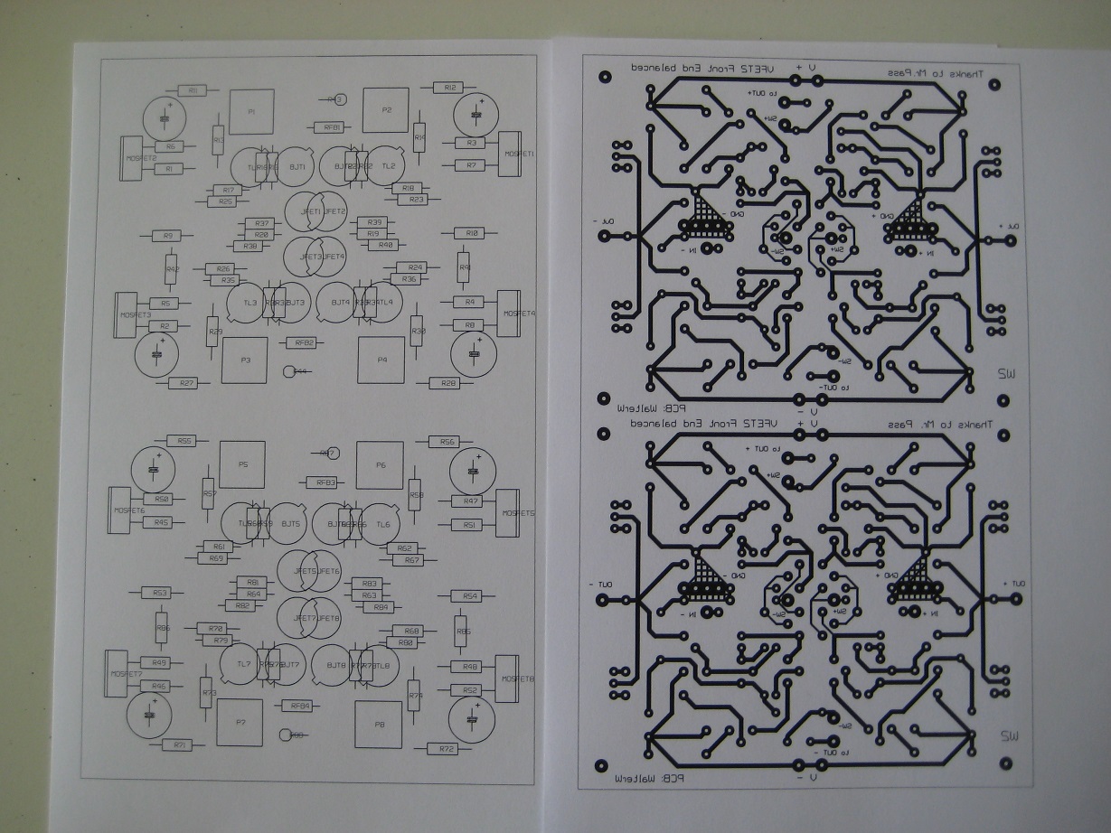

I have single layer PCB layout ready for a balanced or stereo pair, and will be etching my own boards. It's on half a 'eurocard' size ( 10 x 16 cm).
Is there a 'USAcard' size also 😀😀
I made it with a very old freeware program, LAYO1PCB, so I don't know how to share it with you...
Walter

Would there be a benefit to having both channels of j313/k2013 fets in the row ( like the pumpkin ), as opposed to on opposite ends of the board ( like the BA-3FE? I ask only because I already have a galaxy 2u dissipante I could put this in and mounting all the matched fets to the same sink seems convenient, at first glance.
