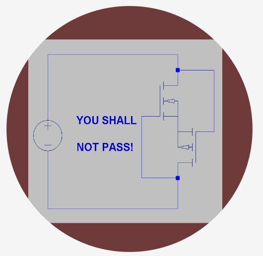

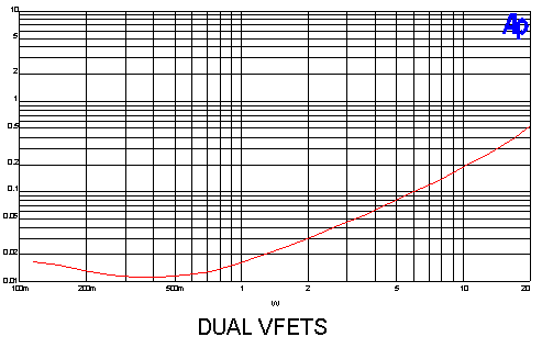

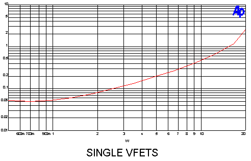

The question of single vs dual VFETs is germane, and I pulled up some curves
made some time ago for 8 ohm distortion vs power without feedback.
Keep in mind that the horizontal scales of the two curves are not matched,
and there is noise in the test setup on the singles.
You will notice about twice as much thd, but applying feedback will take that
down arbitrarily.
