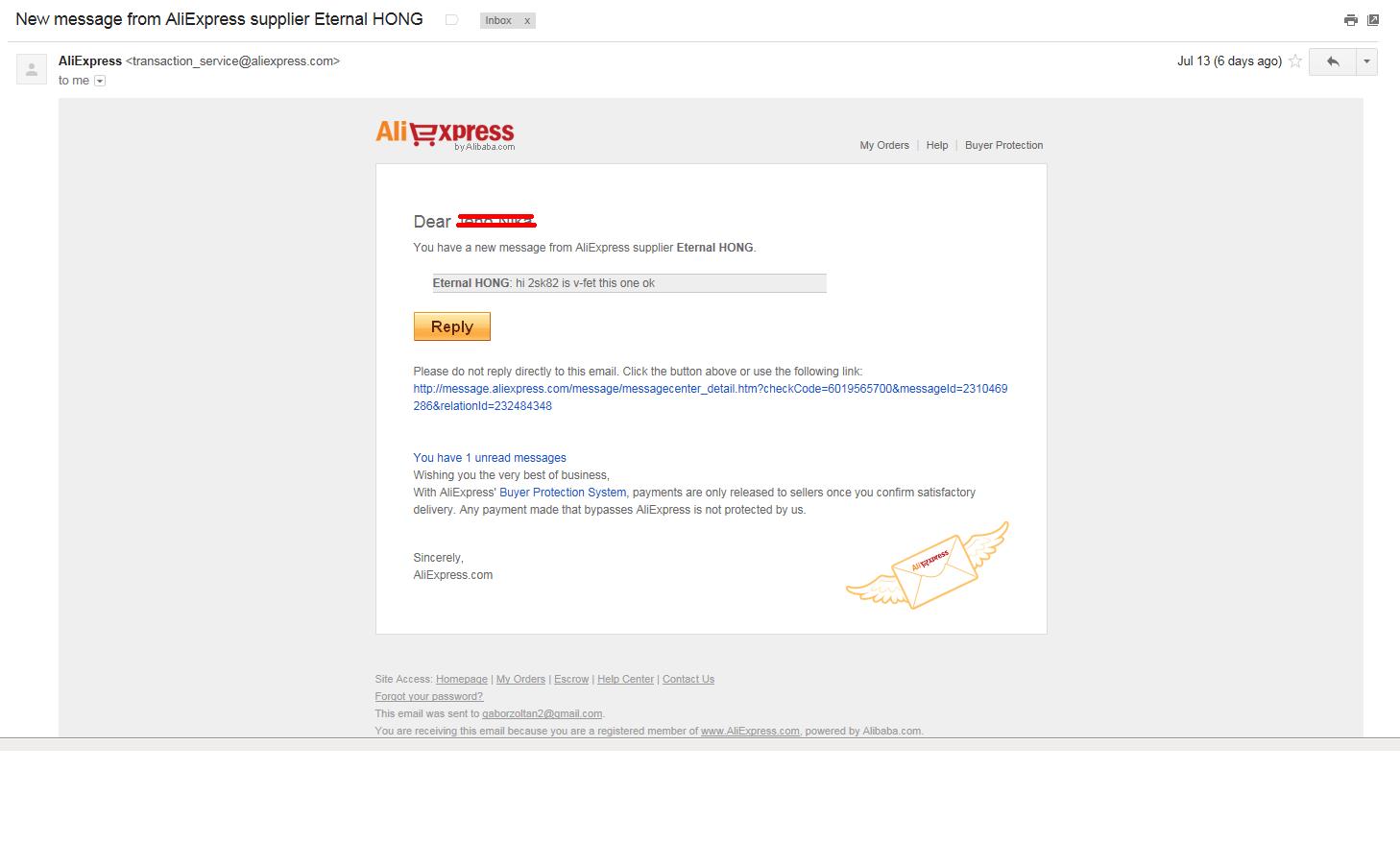

I did contacted with the seller. I ask more picture from the actual item, from the other side to. Yes he wrote back but I think he does not speak English at all, or just I don't know...............
His answer had no meaning, he did not provided the requested information about the originality of the items etc.
In a short sentence (broken English) he asked me to go on and place the order.
Right now I do not have $100 plus shipping cost plus import tax fund to risk on items I'm not sure about.
I would not organise GB or participate until not sure if is orig or counterfeit......
There is no 100% money back guarantee, and what I heard to Visa you need to prove the item is counterfeit to act in your behalf.
No PayPal option

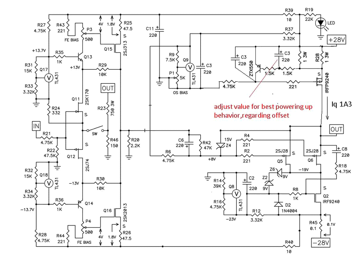

upload is working now , file deleted from DB , attached here
desired Iq set as 0V65/Rs , where Rs is value of source resistance in CCS
as drawn , 0V65/0R5 ~1A3

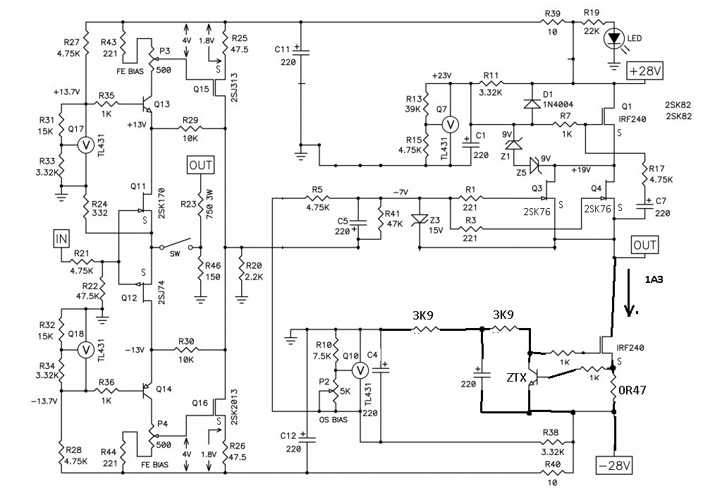

Kdi asked for upside down iteration of SE , with 2SK76 in output
so , previous iteration attached , too
ignore few differences in resistor values , not relevant
