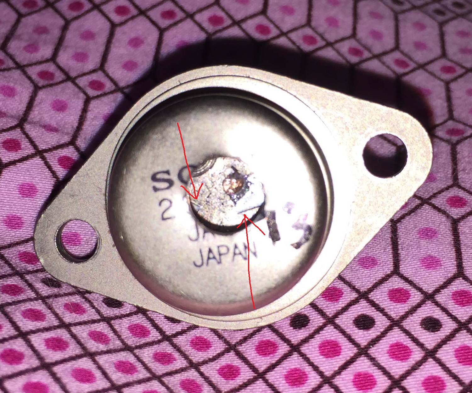

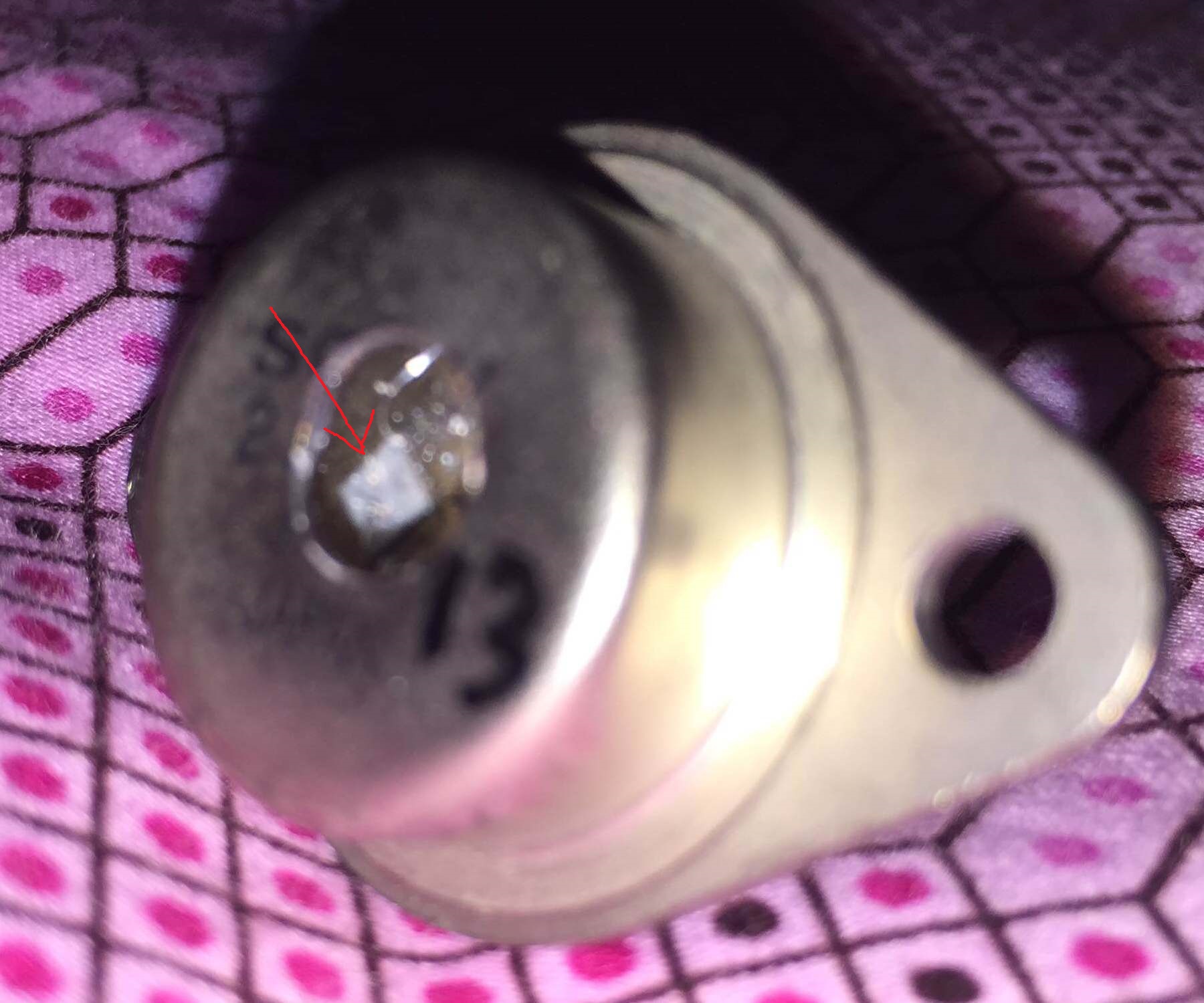

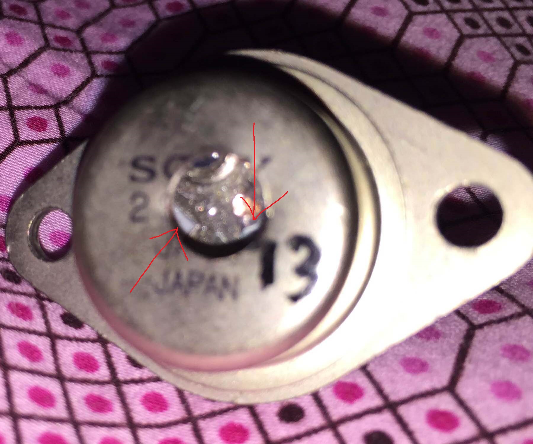

... @ Cwtim01 hope other chip is just not visible on your photo it need to be cut with saw for metal ?
There are indeed a second chip, see the pics 🙂

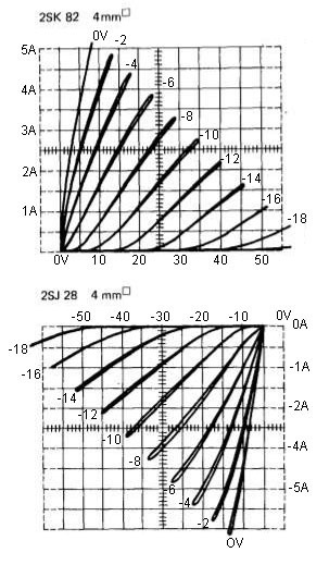

From 20 pairs (mostly from Acronman, some from other sources), I got 5 matched pairs (within 0.1V) for 2SJ28, a bit more for 2SK82.
Attached the Vgs_Id distribution (@19V Vds) of the 2SK82 (left) and 2SJ28 (right), you can see that the 2SJ28s are spreading across a wider Vgs (only 15 pairs shown here, I have not kept the data for the ones that I sold).
I think based on the amount of parts I have, the varation is likely identical.

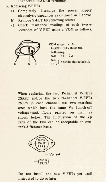

If we compare vfets after Sony documentation 33 is the Vp rank
so JA -33 perfectly compatible with others 33 🙂

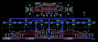

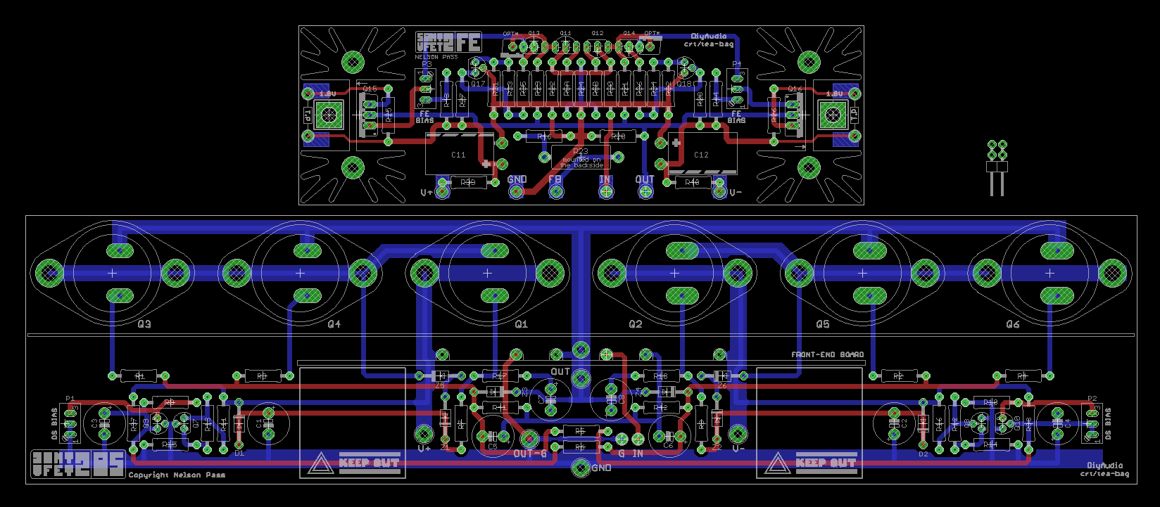

Okay, here is a taste of a possible board(s) to work with here. Critism welcome.
I am hoping that Nelson doesn't throw the baby out with the bathwater and re-invent the thing on the next rendition, but if so, I'll move on.
Here is what it will look like kind of mounted. Similiar to Permanders board, with a more modular front end.
edit: added attachment so one can see it bigger and better.

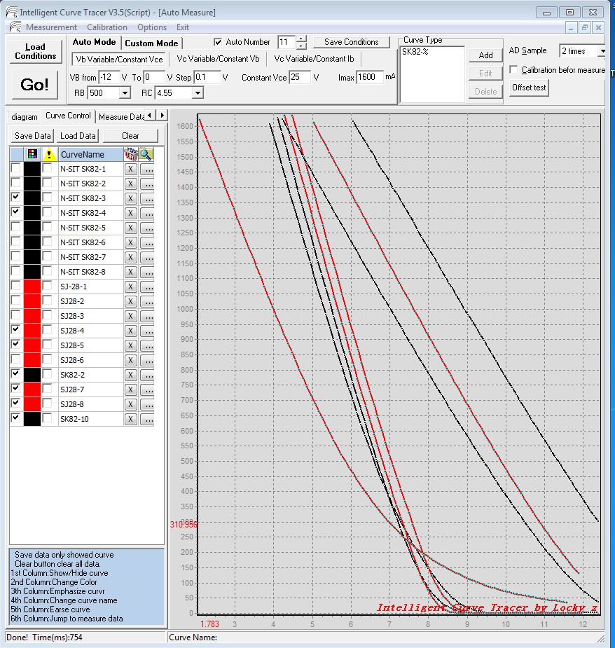

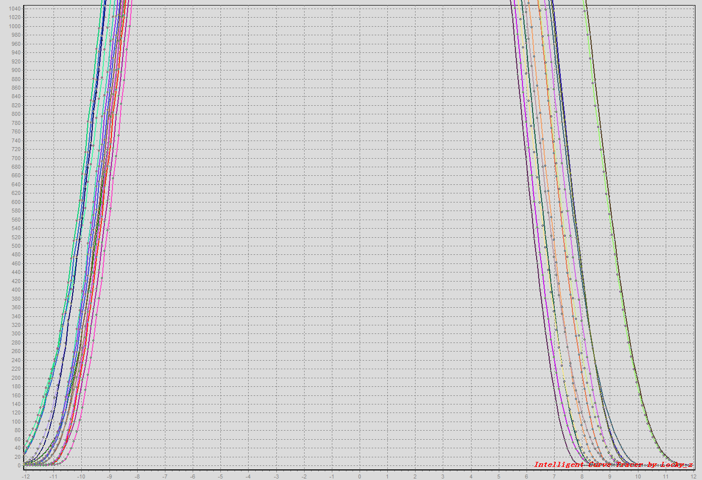

this time I had no good luck…… :-(
I bought at Taobao two pairs of SK82/SJ28, 200 Yuan the pair.
https://item.taobao.com/item.htm?spm=a230r.1.14.140.l4ezPb&id=40300679359&ns=1&abbucket=18
look at the four flat curves, these are the new ones,
the four steeper curves are two pairs from Acronman I already had……
The vendor even lifted the price from 200 to 300 Yuan/pair.
