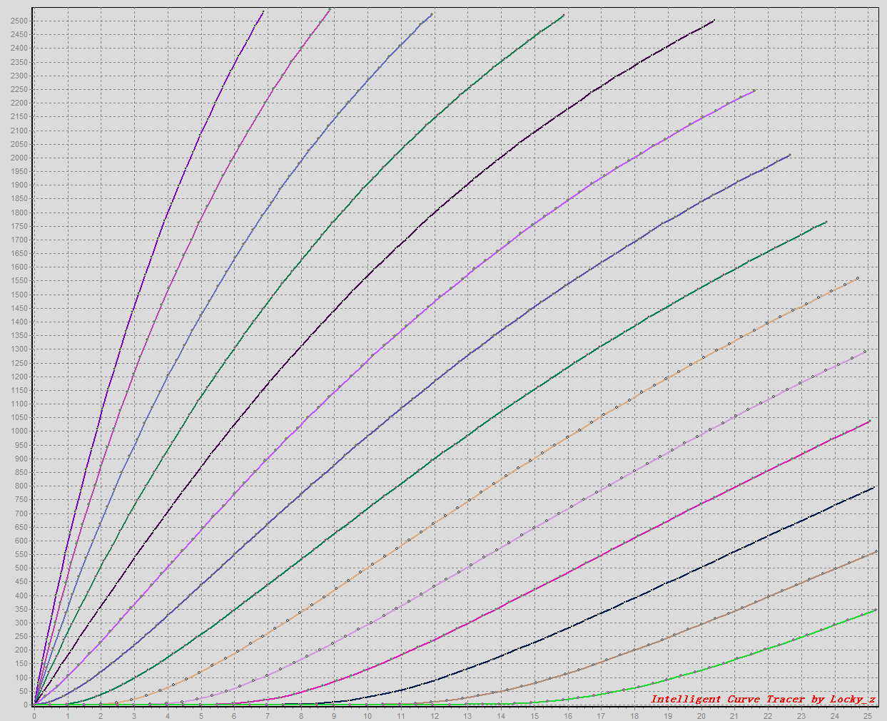

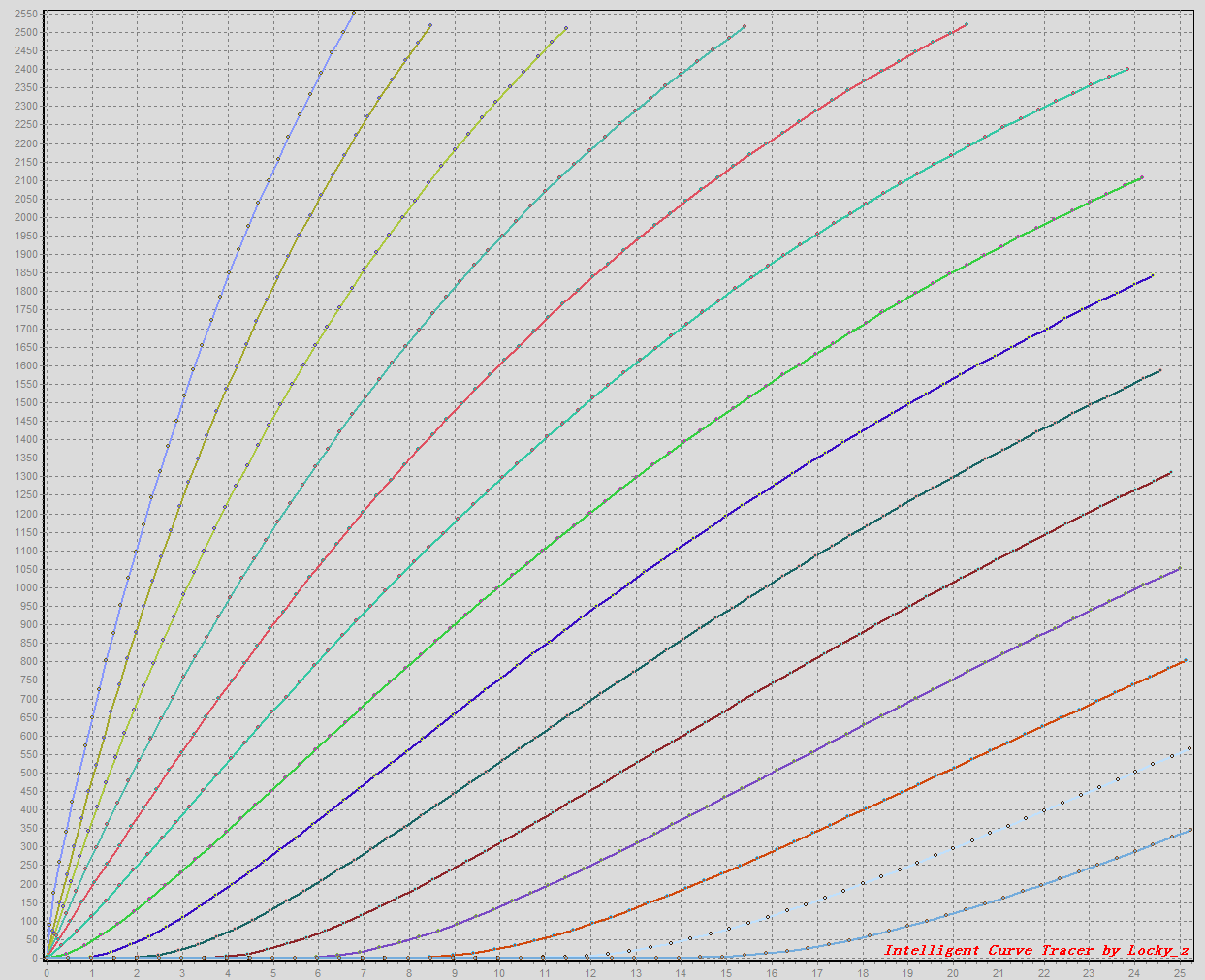

the good news: they are SITs!
the bad news: these JE types do not fit in any way to my Acronman stuff, so if you want to complete your Acronman SITs with these from Taobao the chance to get fitting parts to have more pairs could be very low.
Something I can tell from the dozens that I measured:
  • They do display the triode curves of VFETs, I tend to believe they're genuine Sony VFETs.
  • As far as I can tell, the JAs are more linear than the KEs and KFs, but they have lower transconductance at the same time.
  • With the lower transconductance, I suspected they might be re-badged 2SK60/SJ18. So I drilled open the bad one, but the chip inside seems to be a 4mm chip, so they're not 2SK60/SJ18 which have 3mm chip.
Hi generg,
Your observation are same as mine before. They're certainly SITs, and quite linear actually (first 2 curves as samples), but the JAs have lower transconductance (flatter slope, red and green from last pic are KE/KFs from acronman, blue and purple are JAs).
This characteristic is very consistent for the samples I've measured, to the extent I doubt they are re-badged SITs of other model. But VFETs in Sony style casing with dual chip - I can't think of any explanation, except that early 2SK82/SJ28s (JAs are much earlier than KFs, by the alphabetical order) may have a characteristics somewhat different from latter ones.

Hi generg,
Hi cwtim,
thanks for your understanding that I made possibly some irritation with my first posting concerning the JAs…..
I was so disappointed that I could not use them to make more pairs with my Acronman devices that I first thought that they might be fakes….
They are not and you explained possible reasons, thank you!

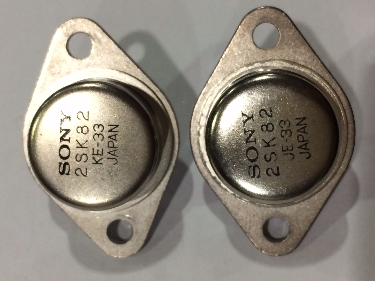

I have some K82-JE-33 that look and measure genuine but the transconductance is about 50% higher than that of KE-33's!
I think not, until someone posts some curves or measurements. We only have seen they look good ( 2 dies inside of 4 mm ) and measure good, with the multimeter.
