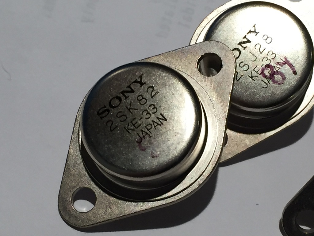

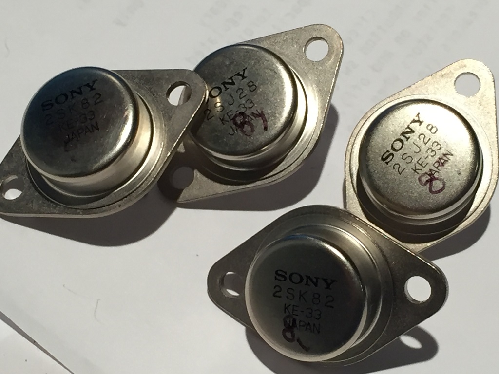

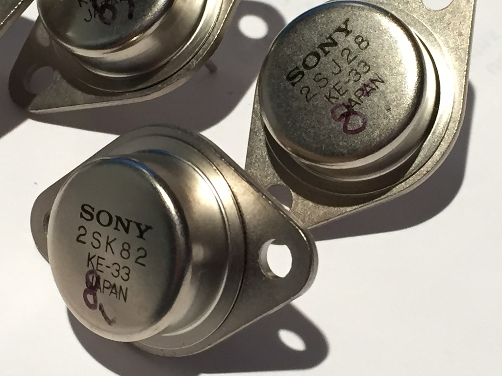

Can you show us a photo? If we still can't make it out, then you would set the
bias voltages at 12 volts, which is about as high as they go, where there
will be little or no bias current and then adjust them down, watching the
current draw and the output DC offset, just like the normal procedure.
Better late than never! LOL
Here's a few pictures. We can clearly see at least one of them being 87 I believe, so the rest should be quite close...

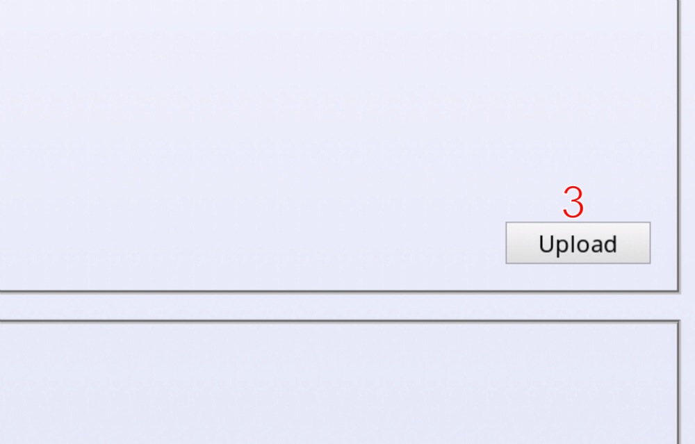

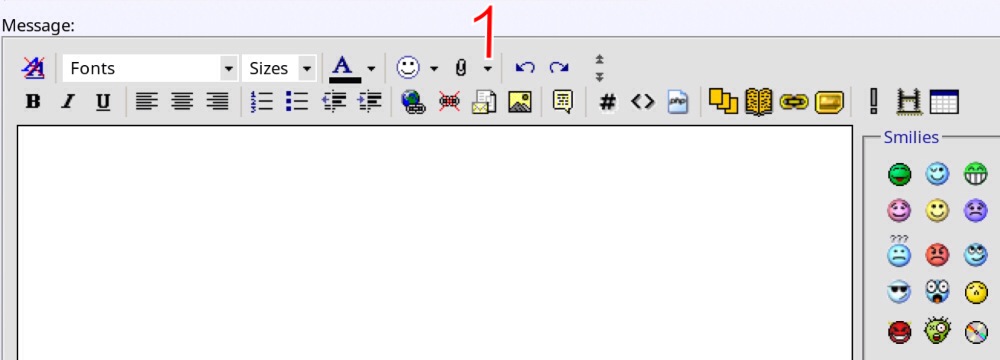

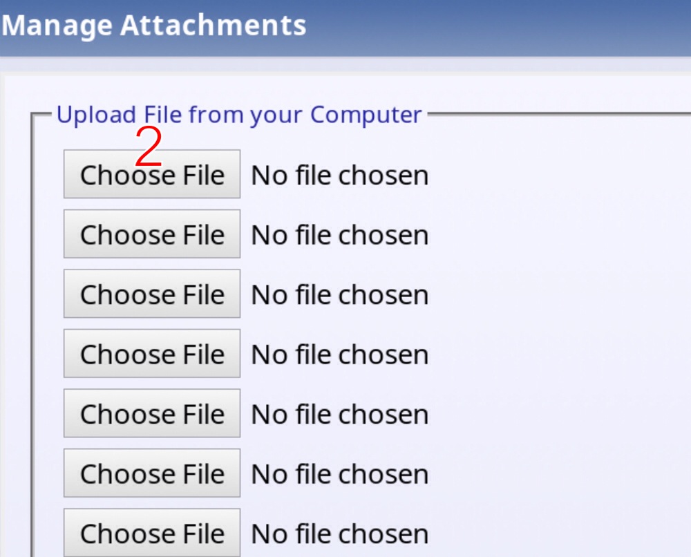

You can try upload pictures directly from your computer.
See and click in 1~4 order. Make Attached Thumbnails
That the best method if you use other method your images is only for some days visible and disappear after.

Joined 2002
Hi DO,
Nelson's original suggestion will work just fine. The exact initial voltages are not important
as long as they are high enough to keep the Vfets from drawing much current.
Given your pictures seem to show the labels to be 8X, you can pretend they
are 90, and set the initial voltages at +/10V.
Dennis
