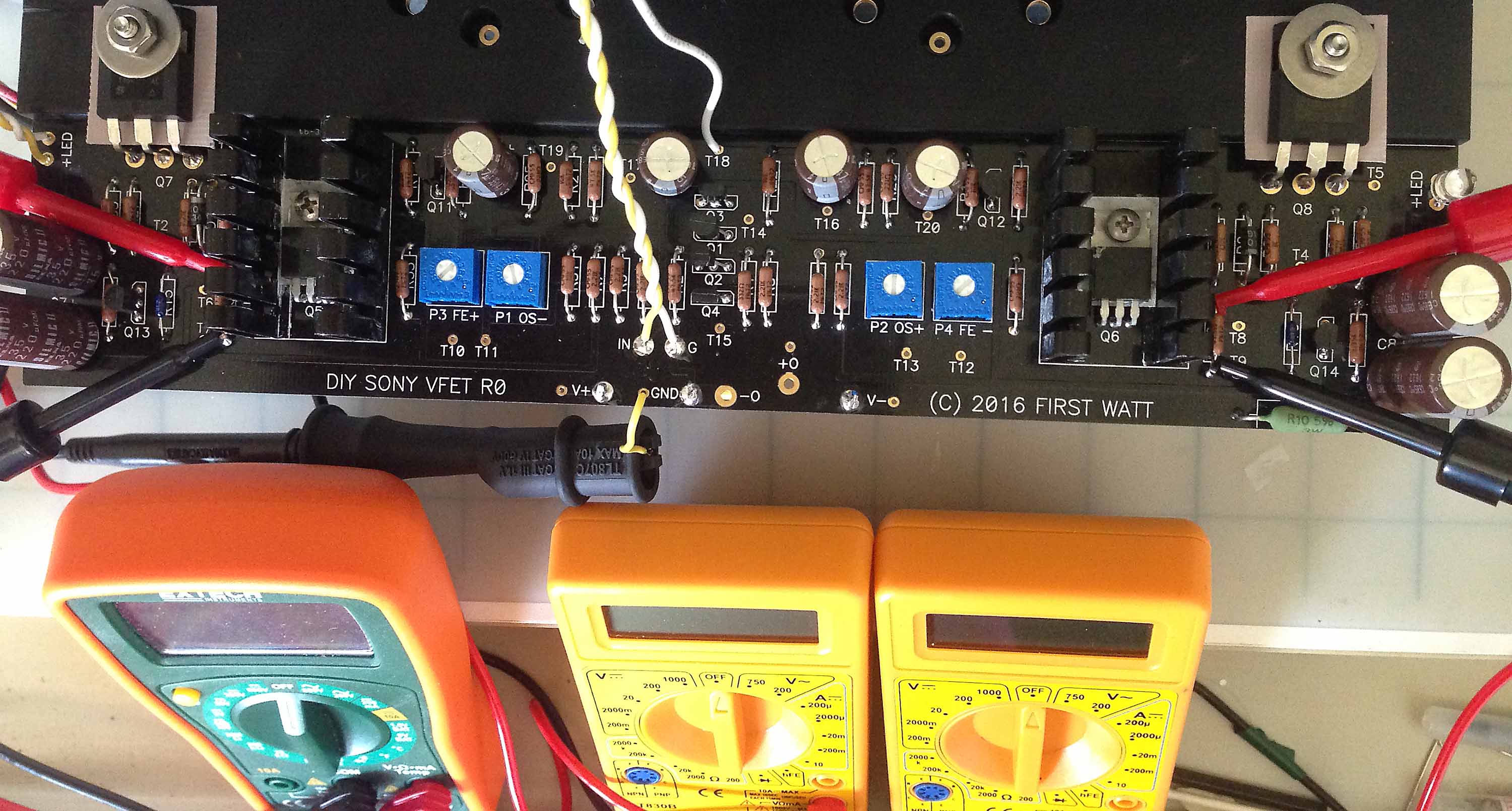

So I finally got to try again last night and I'm getting the same thing. My T18 DC offset isn't very stable. I can get it to around zero with 1.5V on R5,6 but it can move over 130 mV +/- back and forth, even after running 30mn. Perhaps that's normal and I can move on to installing the VFETS. I am attaching a zipped 20 sec movie showing how it changes. I just want to be careful everything is OK before installing the VFETs. The other question I had is if the Mosfets are supposed to get warm at all, because mine don't get warm and I can't remember if they did while I was biasing the FE of the first channel. That channel works fine.
Nelson suggested measuring current draw across the 0.1 ohm resistor by measuring voltage. I got 1V but I'm not sure how to calculate the current draw (Sorry, still a newbie but getting there slowly).

Hi everybody,
I was able to build and bias front end and vfets on the 1st channel with no problems but the second channel seems harder to me. Resistor check was OK. Voltages good as well except for T6-T11 and T8-T13: +8.2V and -7.9V instead of ~5V. When I finally get to about 1.5V on R5 and R6 with as close to zeroV offset(T18-G) as possible, the DC offset doesn't seem that stable. After more than 30mn at 1.5V the DC offset runs up and down between about +120mV and -140mV. I can just sit and watch it go slowly back and forth over a span of about 15 minutes. Is that amount of fluctuation normal?
Another thing that seems funny to me, but I didn't really notice while biasing the first channel, is that the heatsink and the MOSFETs don't get warm at all. The only difference, build-wise between the two channels is that I used some keratherm pads instead the mica ones since I had cracked one of the mica ones. I checked and there's no continuity between MOSFETs and chassis. So don't think the insulator difference is a problem.
Also I should mention that at first I thought that fluctuation was caused by jfets, so, since I had an extra Diyaudio store matched B grade pair I switched them. Didn't make any difference.
Any help would be greatly appreciated.

I think you're OK. If the VFETs aren't installed, then there is no feedback
to the front end - you are seeing the offset "open loop", and the level
of accuracy on DC is as good or better than you should expect.
This should clear up after the VFETs are installed.
Nice job stuffing the board, I might add.

dbis:
That 1V across R32 seems a little bit huge. It means 10A, if R32 is 0.1Ohm as in schematic.
I=U/R
dbis:
I=U/R
Hi Gyuri, Yeah seemed a little funky to me so I think I may have measured it wrong. All my resistor and voltage checks before applying power to the front end were ok. I always use a dim bulb to power on for the first time and that was fine too. Thanks.
