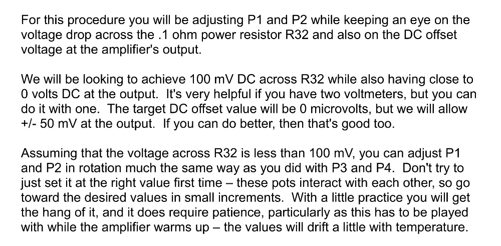

Nelson's original suggestion will work just fine. The exact initial voltages are not important
as long as they are high enough to keep the Vfets from drawing much current.
Given your pictures seem to show the labels to be 8X, you can pretend they
are 90, and set the initial voltages at +/10V.
Dennis

You can verify vfet's bias value and output offset.
Normaly with the trimmers and DMM you can find if all is perfect ?

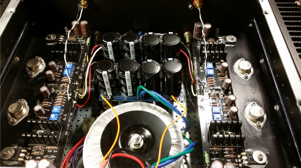

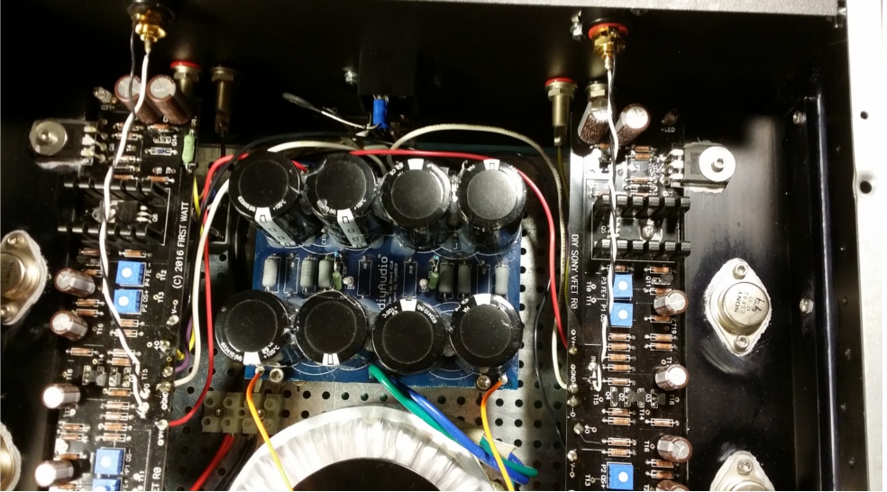

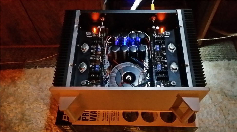

I finally finished my vfet build. Nothing very different. I used the deluxe steel 4U chassis which looks nice with the handles. What took me so long was trying to figure out how to get the nuts attached to the perf mounting plate under those pcb's that stick out so far. I used an Antek AS-4222 with the old style PS boards from the diy store, which I could fit in the space. To get more capacitance, I soldered the caps with some space off the pcb so that I could solder two 10 mF on top and one 15 mF on bottom for each quarter to total 70 mF per rail. I used hot glue to hold the caps more stable. I followed the directions exactly and even though it was a lot of work, everything went smoothly and as expected. Sound will be described in next post.

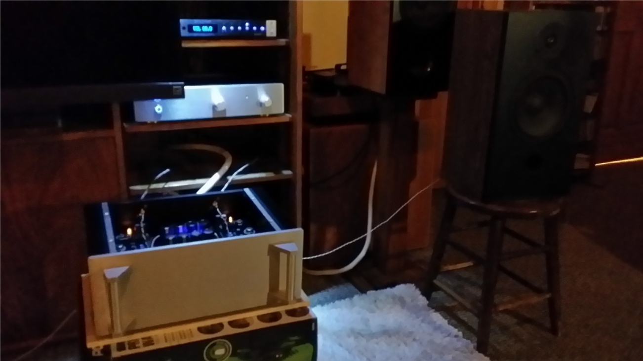

I wanted to set up a second system to try out new builds with so I rebuilt some old speakers. A little digression...in the 1990's a company bought out the Dynaco speaker name and offered two speakers, a 6" 2 way and an 8" 2 way. They called the 8" the A35 model, which sold for about $400 back then and sounded good for that price point. After 20 years the woofer foam surround was cracked and a paper cone tweeter had a small hole. I called Madisound and we found an 8" Silver Flute woofer and a Morel tweeter for reasonable cost that were direct drop-ins to the existing holes. They also provided a crossover schematic which I used. So for reasonable cost I ended up with some great sounding speakers. Only the cabinets stayed the same, but I can say I have Dynaco speakers (in front on the stool). After about a week of the amp and speakers breaking in, I sat down to some very enjoyable listening sessions. Everything sounds fantastic, the lows, mids and highs. This amp is definitely a keeper! Many thanks to Nelson, 6L6 and the diy audio store.
Yes, bias and offset are done. everything is OK.
