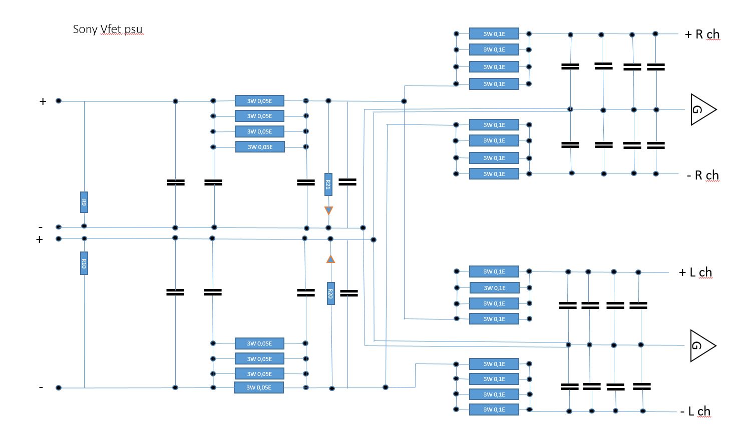

One transformer - dual supply?
If you have one transformer with dual secondaries, 2 x 22Vac, each secondary connected to a bridge rectifier, and then the rectifiers connected to the cap banks, is it then possible to make a rCRC + dual rCRC powersupply? The left and right channel will then have separate capasitors for the last part of the powersupply, but have do you go about for audio and supply "ground" and for return currents to the transformer windings. Maybe not the best solution? I tried to make a sketch to explain:

andRookie, take a look at the 2012 F6 talk over at FIRST WATT ARTICLES which is showing such a PSU.
Thanks! I read that you could "split the RC networks out the each channel separately" but I am still not sure how to do it regarding ground and return currents to transformer secondary. I`ll try to do more search here and at the power supply section.
