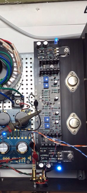

Cantilope has gave his blessing allowing me to answer questions for him. Yes he did use the store PS boards. We both ordered the same parts for our amps together. I do not remember the exact brand of caps but they are nothing special, just good relatively inexpensive 15K uf brands. Tucked under the boards are 4 40uf motor run caps. If you have to know the exact ones I will have to go to my purchase order to find out.
He did a tremendous job fitting two transformers and two PS into one case. He is the first I have heard that has built essentially mono V-fet amps. I will almost bet that Might Zen's build will be something similar if not monos. He took Zen's advice about the wire wrapping as well. Very professional neat clean looking build. Mine is an ugly box but she is sweet inside.
It looks really nice indeed!
I was just wondering about the dimensions of the capacitors, they can't be too tall or they will hit the amplifier boards.

My amp is fully setup, burned in and has been making good music.
R32 and R5/R6 are all spot on. Device temps all seem similar. DC offset at the outputs is only 1-12mV at temp. All normal and good.
At this point is there any significance to T18 vs. gnd? One channel is ~125mV and the other is ~2.5V. The latter one has a marginally less stable DC offset at the output (but still under 12mV) in that it slowly drifts and seems more temp sensitive for example with the cover on/off, etc.

I really do not understand what you mean when you say T18 Vs gnd etc. If the worse DC offset is 12mv you have no worries. If your DC offset is too much you will hear it in your speaker turning on or turning off. Under 50mv is considered satisfactory.
2.5V at T18 (the output of the front end) should be much closer to 0V. Any
offset here will be deducted from the output swing, so you will clip at 2.5 V
earlier than you would like. A little DC here is OK.
All four pot adjustments are involved and have some influence on each other,
so you want to tweak the DC bias through the front end, the DC at T18, the
bias current in the output stage and the output DC. Do it in small baby steps,
iterating through all 4 pots so as to get it right.
