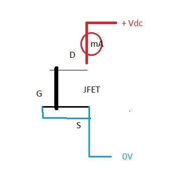

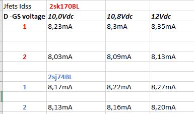

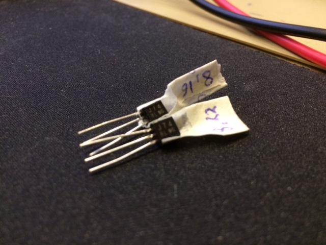

I have some jfet in my drawer from when I built my F5 some years ago. Two 2sj74BL and about 12 of the 2sk170BL. I wanted to see if I could use the two j74 and two of the k170 as matched pairs in the input stage of my VFET amp. By testing Idss at tree different voltages I found two pairs that are quite close to each other. I have been trying to read up on what is a match, but could you guys comment on if the pairs I found are close enough not to diminish the quality of the VFET amp. Compared to jfet pairs/quads on sale here at diyaudio.com I see that my two pairs are a bit apart on Idss.
I hope my notes are comprehensive.

Your Jfet are close enough to use. (they are actually pretty good match) The front-end bias pots will make up for any difference. 🙂

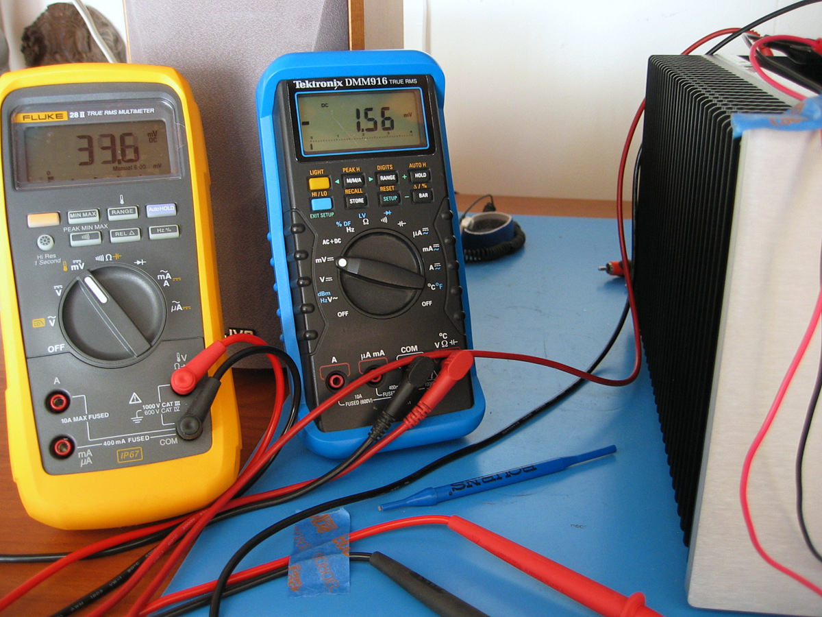

Thank you, Nelson. Your pdf instructions at the end are clear about "checking and adjusting the other bias values as you go along", but I had neglected to go back and reset T18. Now I understand.
With some very careful work and multiple meters, I was able to get <2mV output stage offset and <40mV front end offset. All at terminal temp. I'm thrilled with that.
But wow, it was like balancing marbles on the head of a pin and one channel was more of a handful than the other. My trick was not to actually make perceptible turns, but to apply just enough pressure to deflect the trimmer mechanism and see what direction things were heading and then figure out which combination of trimmers got things to converge in the right direction and not opposite direction. A bit like a 3D puzzle. The single-turn units were quite a challenge!

With a N/P pair like this, with trimers in both phases (P3 an P4 in this amp), a match within 10% is more than good enough.
0.1mA is really quite close. 😀

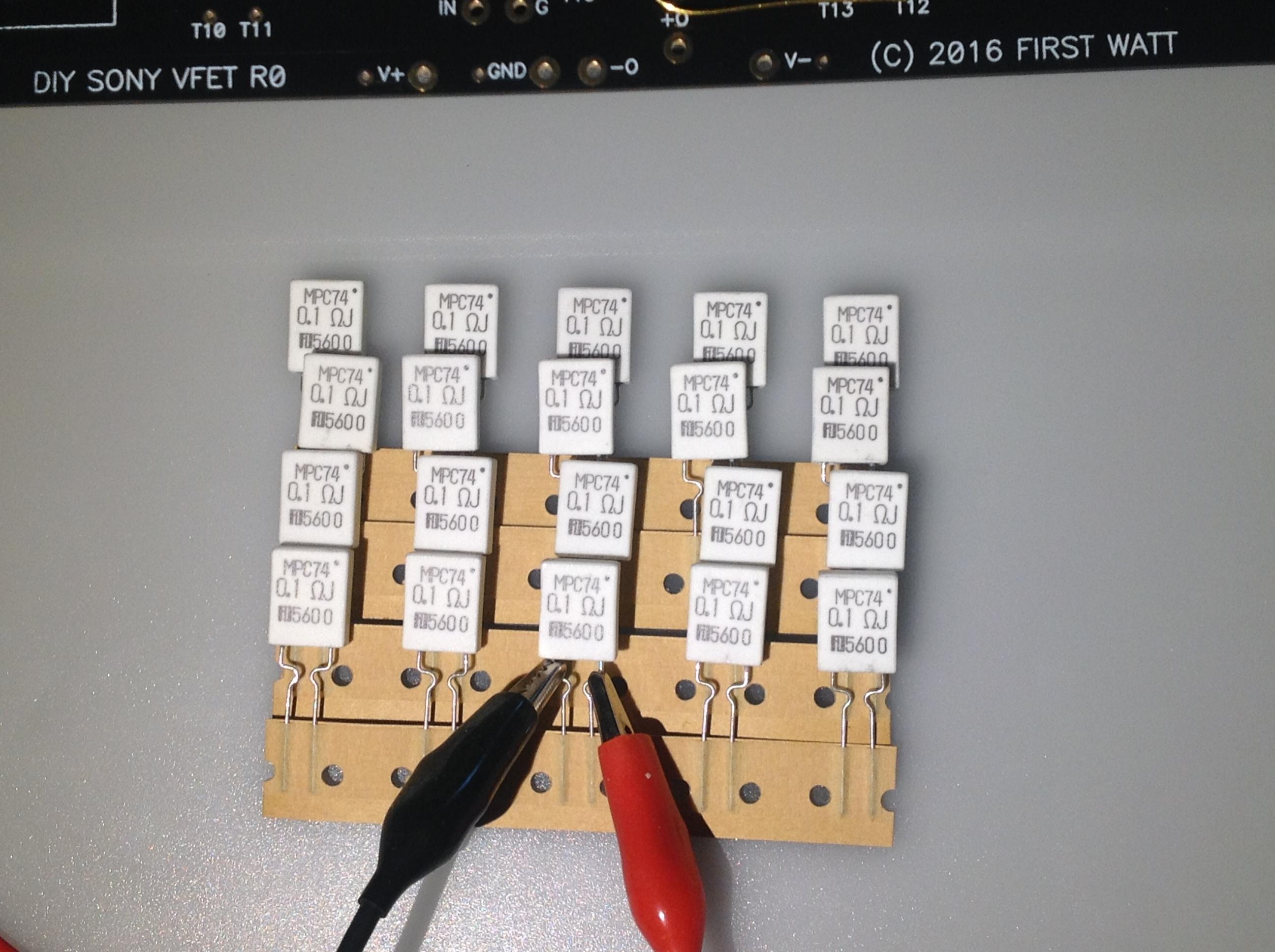

I am ready on work bench and match MPC74 Futaba 0.1 | 5 watts resistors
and the other interesting components is in shipping now

If you're looking for 2 mV offset, yes it is. I usually bother above 20 mV.
