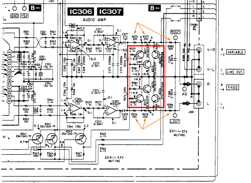

Also - unless you've already modded the muting circuit, I would remove the various transistors (as highlighted in the attached schematic) and replace them with a relay. Additionally, the combination of resistors (required for the transistor muting circuit) push the output impedance up to around 1k ohm which is rather high.
So in addition to a muting relay, I would bypass the 220 ohm resistors, and then change the 560 ohm to 56 ohm.

These kind of mute transistors are rather unique in that they will operate (at low voltages anyway) without regard to C-E polarity. They have 'gain' with either polarity configuration... so never swap them for ordinary small signal types as they won't work as well.
What to do as an alternative? Well years ago I came across this thread (look at post #9 and onward) and can confirm that using suitable JFET's as a direct replacement works well in most cases.

@Mooly - the transistors used for the actual muting are standard 2SCxxxx types. They in turn are switched by those special transistors with built in resistors.
That they have used three transistors per channel with appropriate limiting resistors suggests they had issues getting the mute silent enough. A relay would likely have been cheaper!
@12Bass If you're not sure how to bypass the muting circuit and fit a relay then perhaps this is not the task for you.
But in basic terms, the muting is controlled by Q341, Q342, Q343.
You only need to make use of one of those - and use it to drive a another transistor (pref. darlington) to switch the relay, which you would place in series with the output. You could also place it in parallel, but then you would need to retain the series resistors which would defeat the object to some degree.
You need a low output impedance here.
The current high(ish) output impedance might be why you are hearing differences between opamps (depending on the capacitance of your interconnect as well).

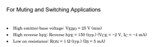

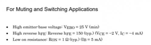

The transistors used in the CDP790 are these which were rather special (although common enough in this type of application):
Muting Transistors
They have a high hFE of around 150 when reverse biased at -2 volts.
It looks like the ones in audio_tony's player are more general purpose devices.
