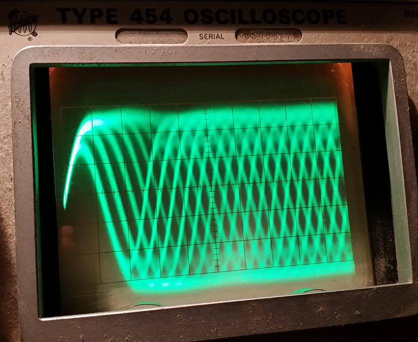

In the older CD players, there used to be exposed test points for the C1 and C2 error flags. We used to monitor them. However, the best looking eye pattern with the least amount of jitter would correspond with the lowest error rates. The same exact thing applied to DAT transports and any other serial data stream. Newer CD players hid these flags so they couldn't be monitored. Too bad, because they are instructive to watch.
I had modified a few CD players to have a buffered eye pattern output jack that would go to an oscilloscope. That way a recording studio could determine that a CD they just burned with the day's mixes was good or not.
The eye pattern is much like a blood test. You can determine a lot by observing one, but this comes with experience. When it comes to aligning your CD player, have a professional do it. Often we have to deviate a little from the manual, or even shim motors or slide rails in order to get the mechanical alignment right in the absence of mechanical adjustments. The very best transport I have ever seen was in the Nakamichi OMS-5 / 7 CD players. You could adjust the mechanical alignment bang-on. Then setting the servos up resulted in an eye pattern that looked like a picture. The quality of eye patterns has declined over the years to a point where I'm surprised that a CD player can play without serious audio issues.

Here's the eye pattern from my X111ES. Scope set for 5mV/DIV with a 10x probe. Not sure if I'm measuring correctly, but it looks like ~0.3Vp-p, which seems low. It reliably reads CD-Rs burned with my Lite-On burner. The ground lead was connected to the chassis and a clean, good quality pressed CD was used for testing.
Comments/suggestions?
That eye pattern looks normal (to me) but I expect the pk-pk amplitude should be around 1v or a little more. If it really was as low as 0.3v I very much doubt the player would be reading discs. The lowest amplitude I've ever seen from a Sony pick-up that was still reading well would be around 0.8v.
Are you sure it isn't set on 0.2v/div making the pk-pk amplitude about 1.2v?
