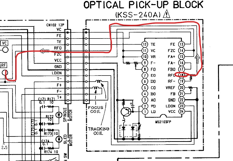

Mooly, thanks for the thread - it's still valuable years later! Using it to check my Arcam CD92 eye pattern. I don't think i'm hitting the right test point (i have been using 'ADATA'). I'm getting to grips with using a new digi scope at the same time, so i wanted to check i was on the right track and my scope would actually do it. I checked my Arcam Delta 170.3 and i can get a nice pattern from it - so i know i can do it and the scope will show the trace
Level seems pretty high on the CD92, so I don't think i've got the proper point, but it is a KSS240A mech.
Pleased to hear you are finding the thread useful 🙂
ADATA certainly sounds wrong. The RF on the KSS240 is as shown here and any player using this pickup will be the same. The RF appears on pin 18 of the chip on the pickup and is available on pin 4 of the ribbon.
Thanks Mooly, i'd only seen the smaller schematic from the service bulletin for the KSS240A, so that expands on it quite a bit. The CD92 schematc is a bit weird as it doesn't seem to ID the RF line. I'll cross check the CD92 schematic to the KSS240A and see what i can find.
The connector on the KSS240 is standard and so you should be able to pick the RF up on pin 4 of that connector no matter what the model of player.
