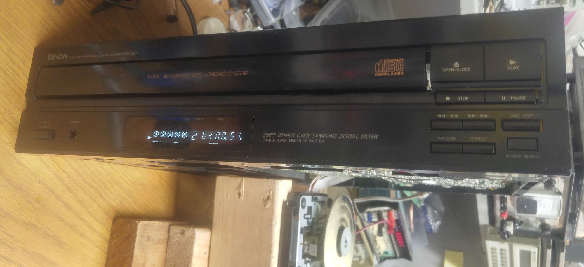

I just scored another success with an $11 USD generic KSS-240A.
I have this Denon DCM-320 5-disk changer:
It had a rather odd fault. Focus search and initial spin-up of disk worked fine every time. I could even see a decent RF signal of about 1.2V P-P for a second or two. Then, at the point where a functional CD player moves the sled to the first track, this machine would stall out. The RF signal dropped in level and got totally random. I don't think the EF tracking signal was getting out of the pickup. Occasionally it would actually start working, maybe one time out of 10. But not for long.
So I tossed in one of my $11 USD generic KSS-240A pickups.
Bingo!
It now works perfectly and steadily.

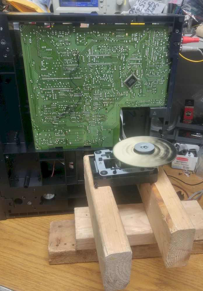

I was able to improvise some cribbing to hold the transport while bench testing it:
CD changers are always a pain to bench test because the transport is buried underneath the changer mechanism. Fortunately this one has long cables for the transport.

Oops! Not so fast! The replacement KSS-240A performed flawlessly for a whole day.I just scored another success with an $11 USD generic KSS-240A.
Then the exact same original fault returned:
- Focus search is fine.
- Disc spins up at normal speed.
- RF signal amplitude & eye pattern is perfect for 1 second.
- But in this machine the RF signal amplitude drops 50% & gets very noisy as viewed with the scope.
- The sled never moves.
- There is an audible hissing sound from the transport.
- The spindle motor RPM begins to vary & eventually speeds way up or stops completely.
- Perhaps there is no tracking error signal coming out of the KSS-240A?
- Or the later sections of the servo system are failing to process it?
- Or perhaps the sled drive motor has a “dead spot?”
BTW this Denon DCM-320 5-disc changer still has an old garage sale label on it:
“$10 - works sometimes.”
I set it aside years ago because this fault was so intermittent. I inspected & re-inspected the main PC board closely for bad solder joints but found none. Checked all electrolytics (they were all fine). Measured power supply voltages & ripple (also OK). Tried a different flex cable between KSS240A and main PC board (no change - still had same fault).
-EB

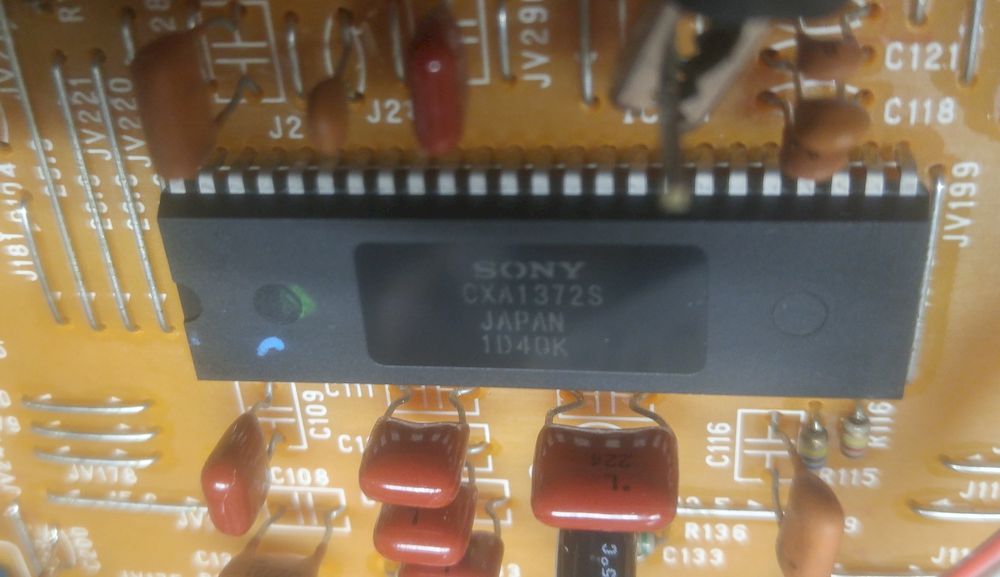

Update on my Denon DCM-320 5-disc changer restoration:
I confirmed its CXA1372S servo IC is intermittently failing:
It's likely that one pin goes open-circuit intermittently.
Giving the top of the IC package a very brief dose of "freeze spray" instantly fixes the intermittent every single time.
I've repeated this experiment more than 10 times.
Nothing else corrects the fault.
I haven't tried to identify precisely which pin is intermittent.
I suspect one of the data input pins (DATA, CLK, XLT).
Working together these 3 pins receive 8-bit serial commands from the MCU.
However answering this question this doesn't really matter.
I just need to replace this IC. Hopefully I have a parts machine to get one from.
So... I will set this unit aside for a bit.
I'll continue with 2 other multi-disc changers which are on my shelf:
To keep this thread on-topic I'll only post here about CD players which use the KSS-240A.
I'm still surprised this Denon DCM-320 actually has a bad IC chip.
IC chips don't fail at anywhere near the rate of stretched belts, dirty lenses, dry solder joints, bad electrolytic capacitors, bad motors, or faulty optical pickups.
This particular IC chip doesn't even get warm during operation.
There's no real reason why it should fail now, except that it may have been like this ever since it was manufactured.
One potential weak point with IC chips of this vintage is their incredibly thin "bond wires" which connect metalized pads on the silicon die to the external pins. The probability of one faulty internal connection rises with the number of pins. The CXA1372S has 48 pins.
