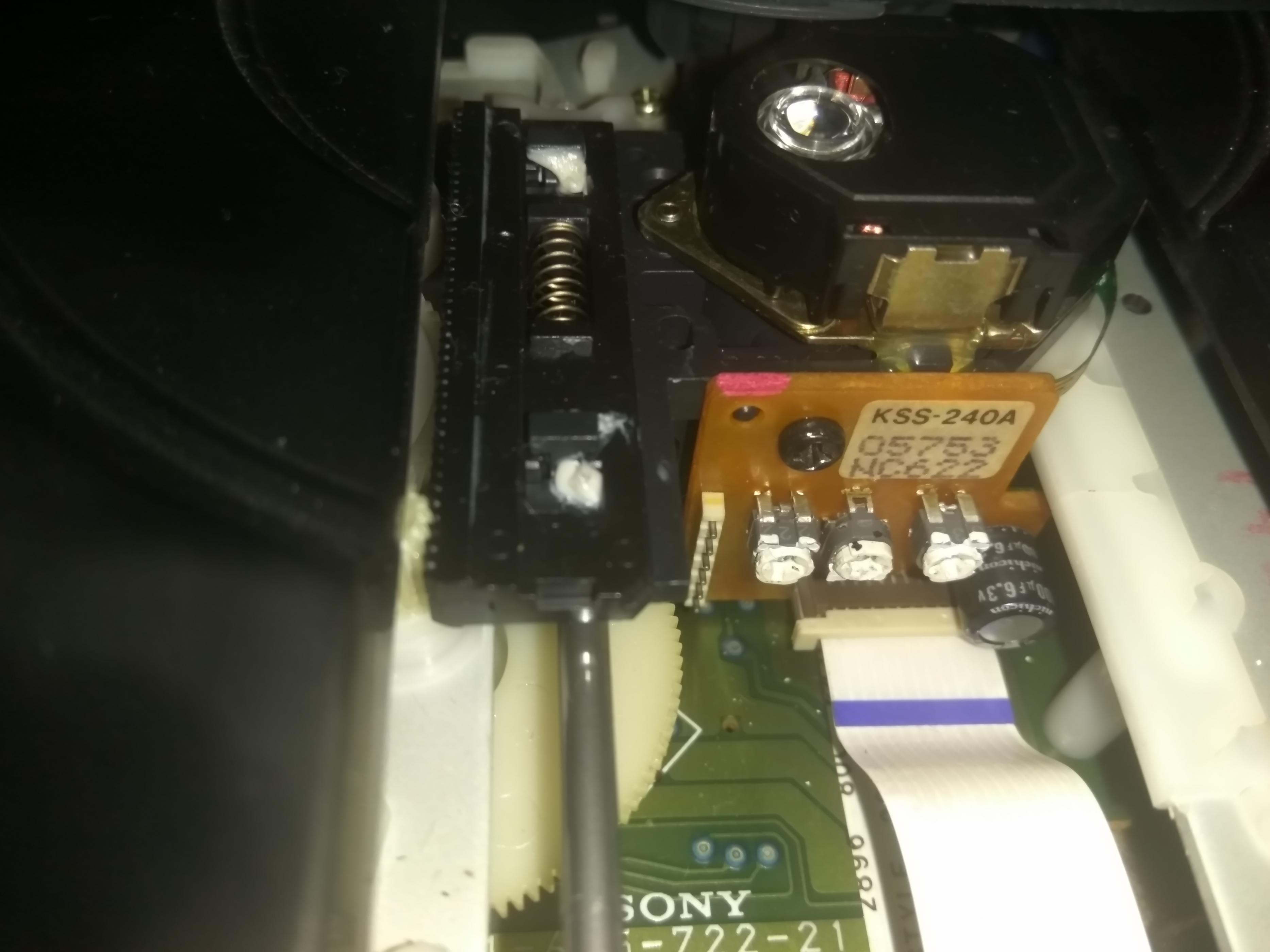

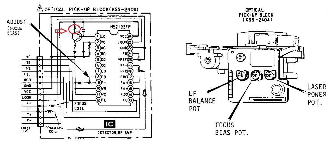

Hello.I bought a Denon DCD-625 with the problem of not playing discs.I opened it put a disc in,it makes a small turn and then stops.
I checked the laser ,there was a small dark red light coming out.The laser is a KSS240A..someone must have messed with the 3 trimmers because there were some tiny pieces of broken plastic same as the trimmer.The laser power trimmer was fully turned in one position and the focus bias and tracking balance were almost at center position.i turned the laser power trimmer a bit to be almost at the middle and the focus trimmer a bit and it plays the cd now without issues,no whining,no strange noises.

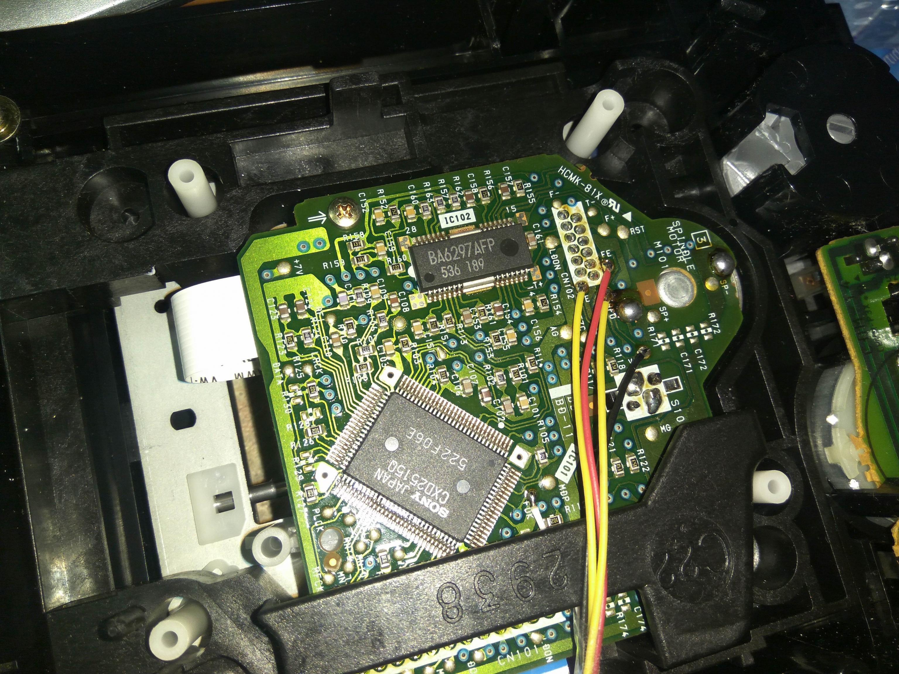

I soldered some wires to test points of the pcb to perform future adjustments for focus ,eye patternt,tracking as described in the service manual when i have access to an oscilloscope.
But now how can i adjust the laser power trimmer to be on its original position? the label says 62.2ma.I guess i have to dissassemble the laser unit and solder some wires on this resistor to measure voltage drop while playing a CD...

...or just be content that by setting the presets for best eye pattern and adjusting the power to give around 1.2v peak/peak signal it is going to be pretty much correct. Be sure to use a good commercial CD (clean and normal reflectivity) for adjustment and never use CDR or RW for alignment.

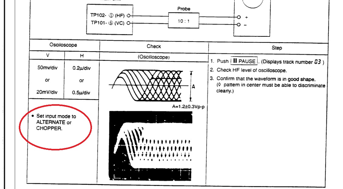

Looking at this service manual says to set input mode to alternate or chopper thats why i am asking.Havent done such a measurement before and i am a bit confused.

Well you would normally turn the second channel on the scope off (so it behaves as a single beam) and then the Chop/Alt don't apply. The eye pattern is a single measurement that can be done on a single beam scope.
The difference if you have both traces running is that Alternate traces out first channel 1 and then channel 2 and so on. Chop displays both together with the traces literally 'chopped' as they scan left to right.
It makes a difference at really low sweep speeds where you want to see both traces together and not have one trace disappear while the other traces out.

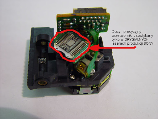

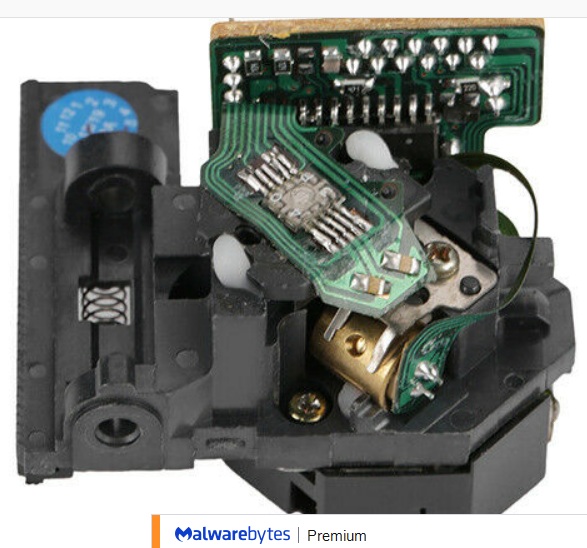

Today i received the kss240a i ordered 1 month ago for my denon-dcd625.The original kss240a loooks like the one below on the left but what i received had a 10pin ic instead of a 24pin and another extra ic that the original doesnt have.( picture on the right).When i bought it from the seller ,the photo corresponding to the item was that of the one with 24pins and so i decided to buy it but i received one with 10pin ic.
Is this of inferior quality?

As far as I know none of the replacements are genuine Sony parts and haven't been for nearly 20 years now.
All you can do is fit it and see how it performs. Its a totally different design electrically but as long as it works to the original spec then it should be OK.
Another difference you will notice is that original parts have the sintered phosphor bronze bearing shells whereas the replacements use moulded plastic.
