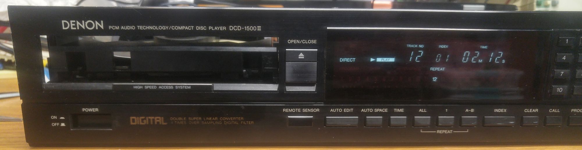

Well I went slightly off-track with my KSS-240A restoration project when this item showed up on my doorstep:
Denon DCD-1500II
This was an ebay purchase.
USD $50 with free shipping.
Advertised condition: "For parts or not working."
Shipping alone would typically be >$25 USD, considering how much a Denon DCD-1500II weighs (more on that later in another thread).
Although I'm attempting to reduce the size of my vintage CD player collection, I could not resist this opportunity.
For many years I've admired the Denon DCD-1500II but (until now) never owned one.
I was also eager to check out a CD player which contains the legendary KSS-151A optical pickup.

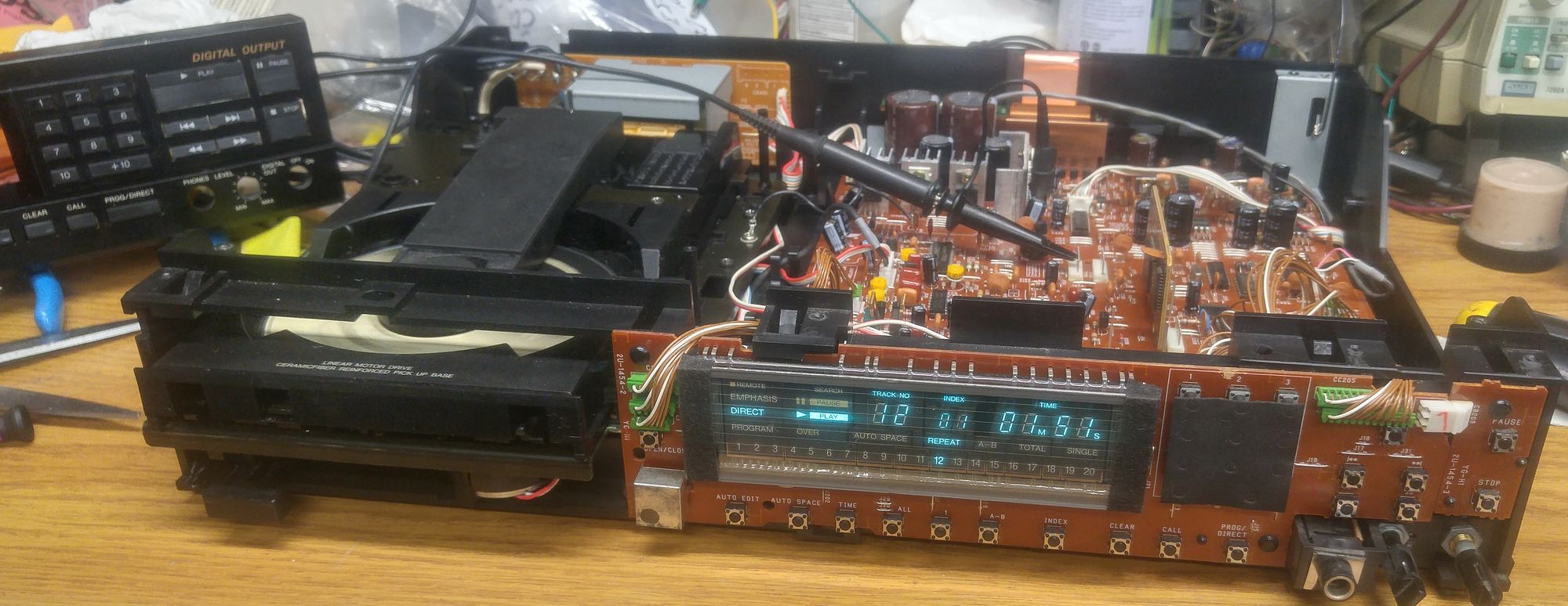

The unit arrived with a zip lock bag taped to its top cover containing random sheet-metal screws, most of them not original hardware. But the player itself was relatively unmolested with the exception of its tray drive assembly. This machine uses 2 different sizes of square cross-section rubber drive belts. Neither appeared to be the correct size, although both looked new. Oddly there was white "plastic lubricant grease" on both the belts themselves and all over the pulleys. Of course the tray would not open. I'm thinking someone obtained a "belt replacement kit" from ebay but didn't understand how to install it. So they gave up and sold off the CD player.
After thorough cleaning and installation of proper size belts the tray began to move very smoothly.
The only remaining problem is with the clamper arm.
The rotating clamper itself rubs on the arm which holds it.
This prevents the CD from rotating.
This player uses a magnetic clamper but the arm which holds it is rather long and the mechanism which raises and lowers it is a bit ungainly. There are no places where its height can be adjusted easily. I temporarily added paper shims to reposition the clamper arm so that the disc can rotate freely.
Voila! It plays!
RF level is slightly >1.0V P-P with a nice looking eye pattern.
I played several discs all the way through.
I was immediately impressed with the "musicality" of its sound, even though I'm only using modest bench-shelf monitor speakers.
Compared to my recent stack of Sony "pulse DAC" CD player restorations (which sound pretty good in their own right), there is "something special" about the way this DCD-1500II sounds.
I can't wait to hear it in my upstairs audio system. I'm envisioning a 3-way comparison between the Denon DCD-1500II and two other CD players which I recently restored: Mission PCM4000, Sony DVP-NS999ES. I'll soon start a thread about this.
-EB

I just got a Denon DCD-2560. The dampers had to go since they were solid. I need to figure something out for these, foam would work. I have replacement output coupling caps coming, op amps have been replaced and that allowed me to adjust the LSD for minimum distortion. I am thinking of upgrading the DACs at this point, but there are 4 of them. Performance is now limited by the DAC chips and not the analogue stage like it was.
The laser current is 4% high. Magnetic clamp (GREAT!!) and spindle motor is coming for it. Aligning the tracking offset and removing the dampers made a huge difference in tracking. No surprises there.
Very happy overall.
-Chris
