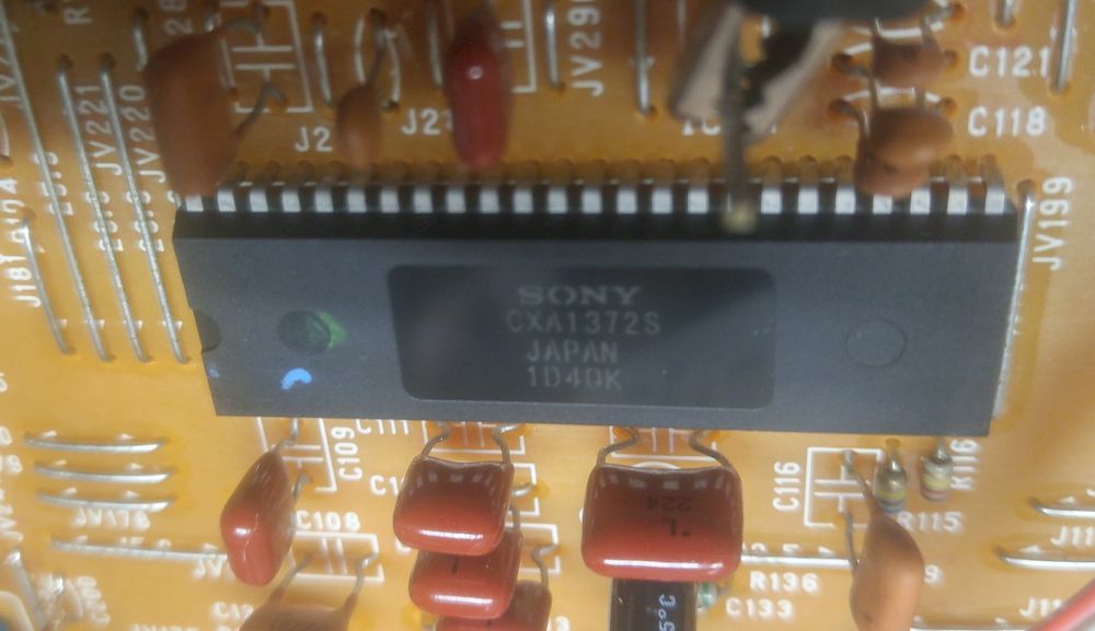

Abother update for my Denon DCM-320 restoration:New CXA1372S servo IC installed (eBay purchase from China).
I put the player on repeat with 5 discs in it. It is functioning perfectly.
Also: This machine sounds really great. I don’t think I’ve heard any other multi-disc player sound this good.
-EB
It is still operating perfectly after playing 24/7 on “repeat 5 discs” for 2 weeks, confirming the original CXA1372S servo IC was faulty.
And it continues to sound great playing every disc I put into it.
I think I will call this restoration “completed.”

This Denon DCM-320 currently has a new "generic" KSS-240A in it. But I think the original factory pickup is still good. I put the old pickup into a different CD player and it works fine.
Everything points to the fault in this Denon DCM-320 being the failed CXA1372S servo IC:
RE: "Generic" low-cost KSS-240A pickups, here are my observations after installing several:
- If anything they work better than the originals.
- Only one new pickup required adjustment of its trimpots: Its RF level was too low (only 800mV) and the laser current was also quite low (35mA). Raising the laser current to 42mA provided the desired 1.2V of RF.
- These generic pickups rarely skip when tapping on the CD player (even with very robust tapping). In comparison many of the original KSS-240A pickups skip when tapping on the CD player. Perhaps the actuator/lens assembly in the generic pickup has lower mass?
-EB
