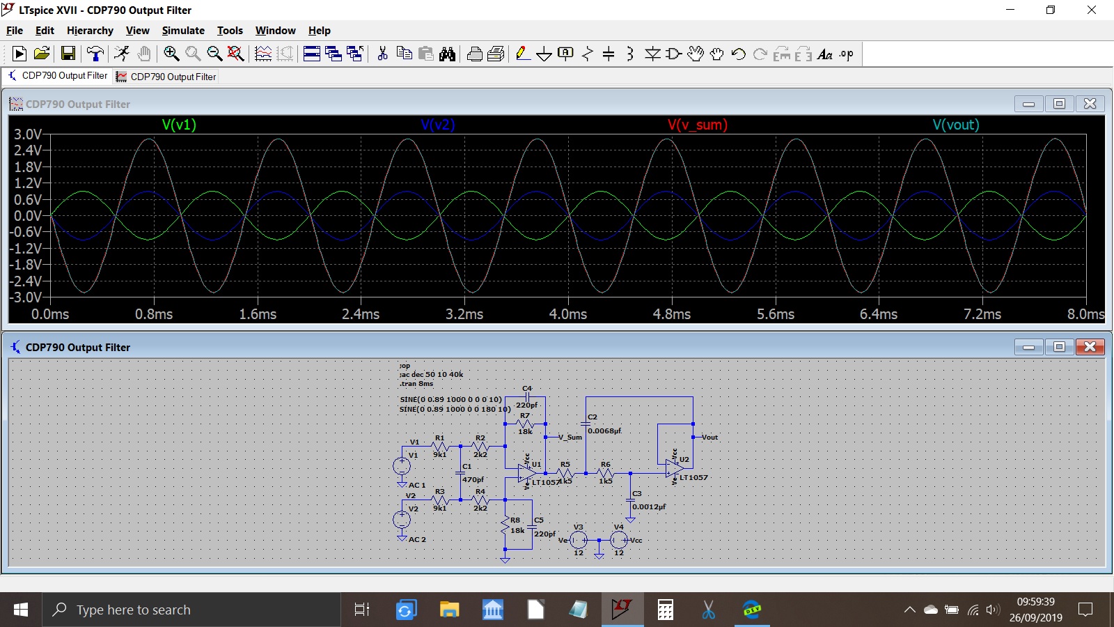

The TL082 is used as a conventional differential voltage converter. You can see the voltage levels for 0db output in this old simulation of the CDP790 stage. Vout and Vsum overlay each other at 1kHz.
Choice of the TL082 is probably down to commercial (cost) reasons as much as anything.
Definitely do not try and increased the shared rail voltages as that would likely cause problems/damage to the servo and pickup circuitry. Purists will argue the shared rail will have some HF noise it from the digital sections... is it a problem... only a blind AB test of a different setup would say for sure.

Thinking that the rail-to-rail OPA211 won't be a problem for headroom at +/-5V but not sure about the ADA4627-1 (which is my favorite sounding op amp).

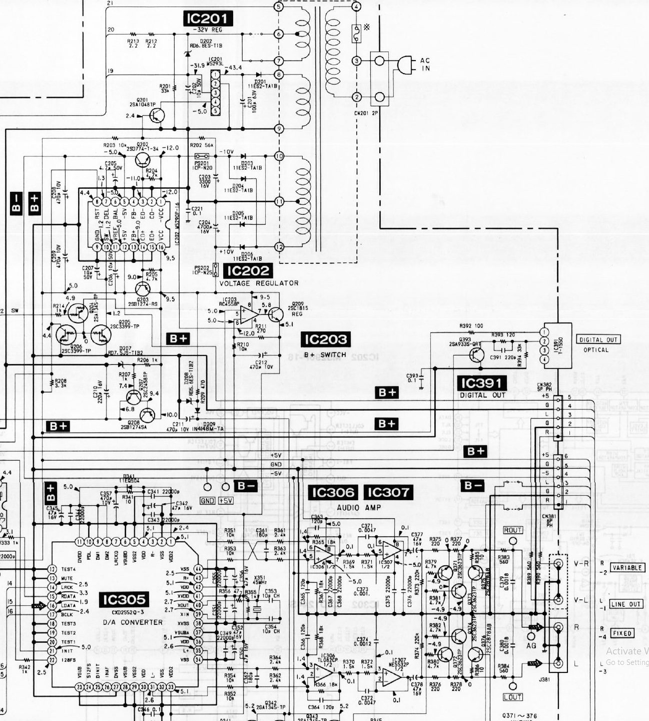

Separating the supplies with a new PSU board with the right voltages for opamps will make this device a lot better. No crossfeed, no HF and no headroom issues with low cost. An hours work including the drilling. I won't start about the clock but you can have mine for shipping costs. It is a 45.xx MHz Tent on a separate PCB with PSU. Best would be to give it a separate transformer too to avoid GND loops.

It is another way of looking at designs. Shared rails between digital and analog electronics are technically undesirable and such can easily be measured. +/- 5V is a known design error by Sony which you can eliminate. It is too restricting for best results. Both drawbacks are added in this device. For me it is a no brainer to solve design errors first and then try different caps. Trying out opamps when the supply voltage is at the absolute minimum might set you on the wrong foot. Loosing time on marginal things when the basis is not OK is futile. Trying to "get away" with least effort techniques will not work out, the manufacturer already did so.

The most plausible way to run higher voltage to the op amps would seem to be by drawing +-10V (unregulated) from the output of the rectifier bridge, just before the input of IC202. That would require cutting the +-5V traces going from the regulators to the analog stage. Is there another way, a better way, for test purposes? Also, would it be detrimental to feed unregulated power to the output op amps (noise, ripple, etc...)? I have a variety of electrolytic capacitors around for extra supply bypassing, but no regulators.Its hard to say what any audible differences would be, or if those differences were strong enough that you could pick them out in blind testing. That said, there could be a valid case for running opamps at higher voltage. It should be easy enough to alter the board to do this as a test.
FWIW, I'm not saying that there's no difference if adding a separate supply with higher rails. Rather, I'm just trying to get an idea how much of a difference there might be and whether or not it would be worth doing. I haven't made a mod like this before.
2.5V RMS output equals roughly 3.5V peak-to-peak, which could be pushing it for 5V rails. Not sure if this player is that high, or closer to 2V nominal.

What about using the existing +/-10V unregulated rails to feed two LD0 9V regulators for the op amps? I'd like to avoid adding another transformer if possible, in part because it would complicate the power switching, requiring further hacking. Looking at the circuit, I'm not even sure how I'd switch the power to an additional transformer.
A separately regulated and well decoupled analog supply from a common transformer may not be as good as using a separate transformer, but still should be significantly better than running analog and digital circuits off of the same source. Also thinking that +/-9V ought to be enough to guarantee sufficient headroom, no?
