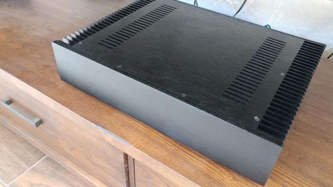

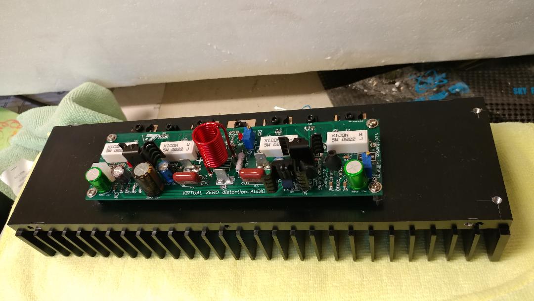

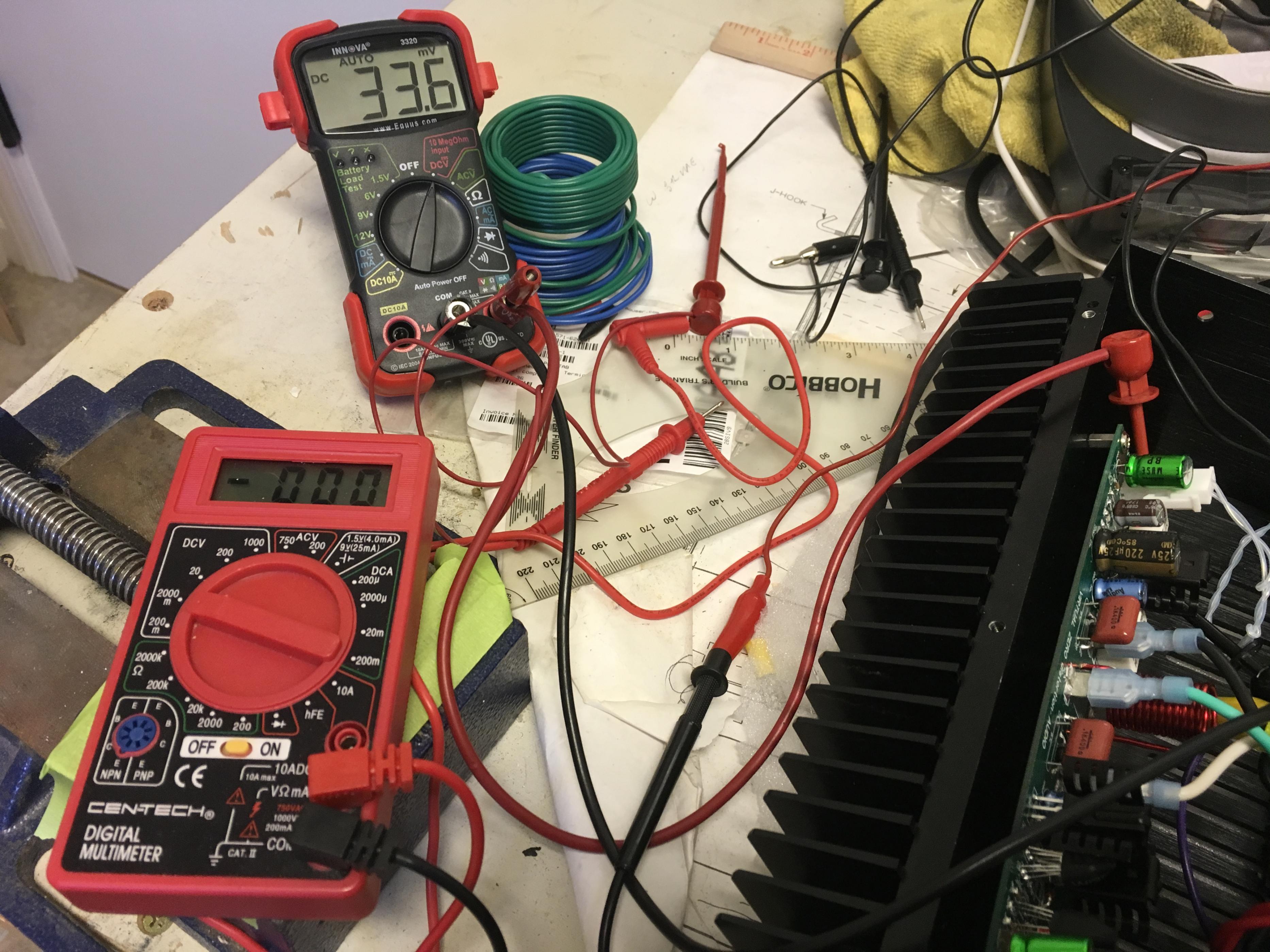

VHEX biased at ~33.5mv, offset came right out. Very good design. Ground loop breaker was accomplished with a CL-60 in series between clean and dirty ground, one star for each channel.
This amplifier continues to amaze me with incredible performance. I did Some boutique parts, but only in the signal path (Simics, Nichicon KG). Cardas bonding posts.
Capacitors are passive devices, therefore, they do not have as much impact as active ones, but they do make a small difference.
Nichicon, low ESR, high ripple caps were used in the PSU boards.

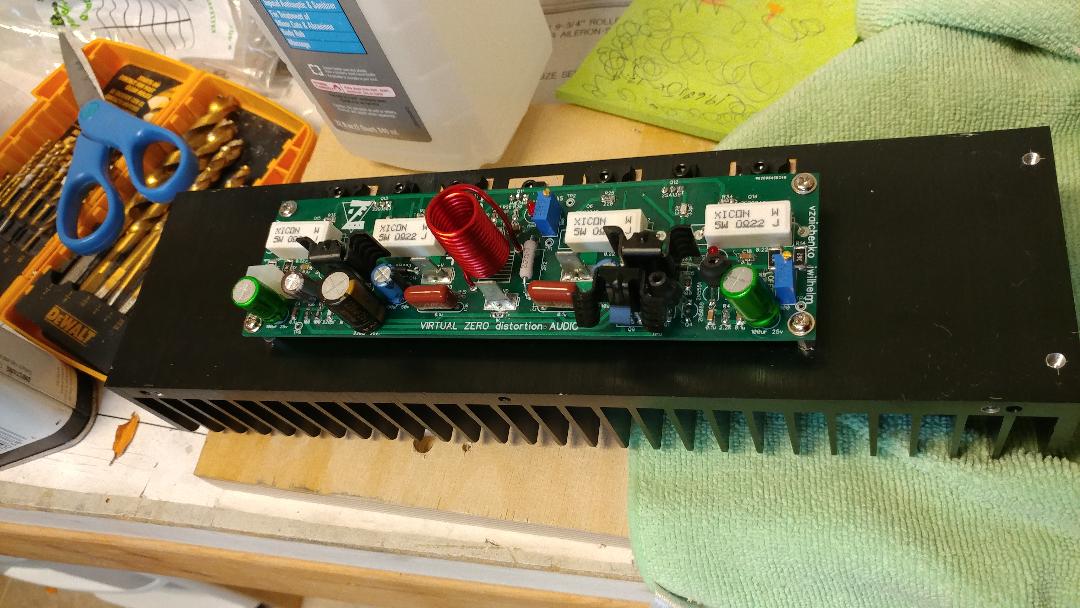

This amp is a sonic blockbuster. Bias-wise, it takes about 20 minutes for the amp to reach stability. However, the sonic difference between cold and warmed up is not that much. I usually preheat heatsinks with hot air prior to biasing but with this amp I did not. First bias at 10 minutes, second one at 20 minutes. Last at an hour.

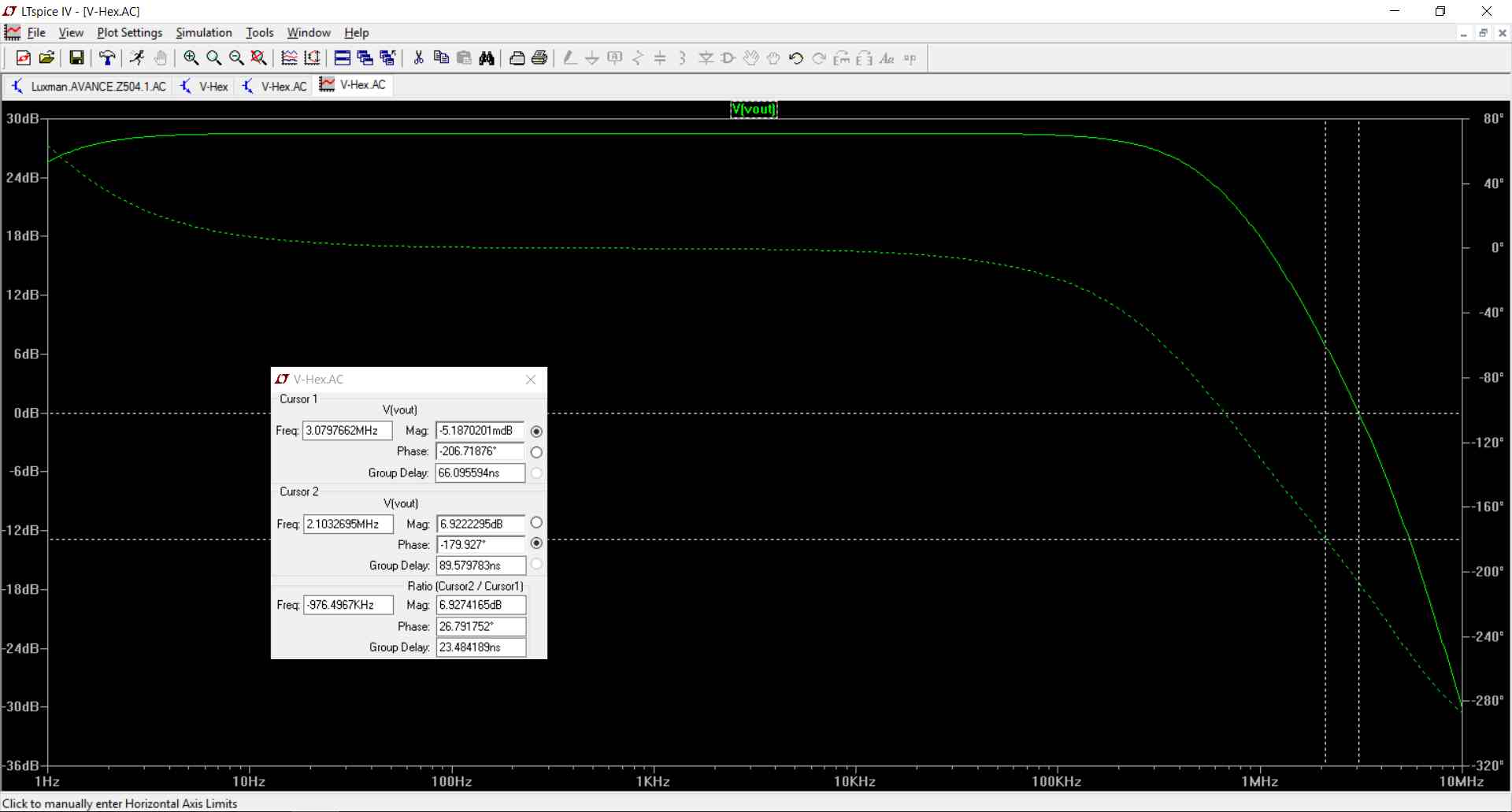

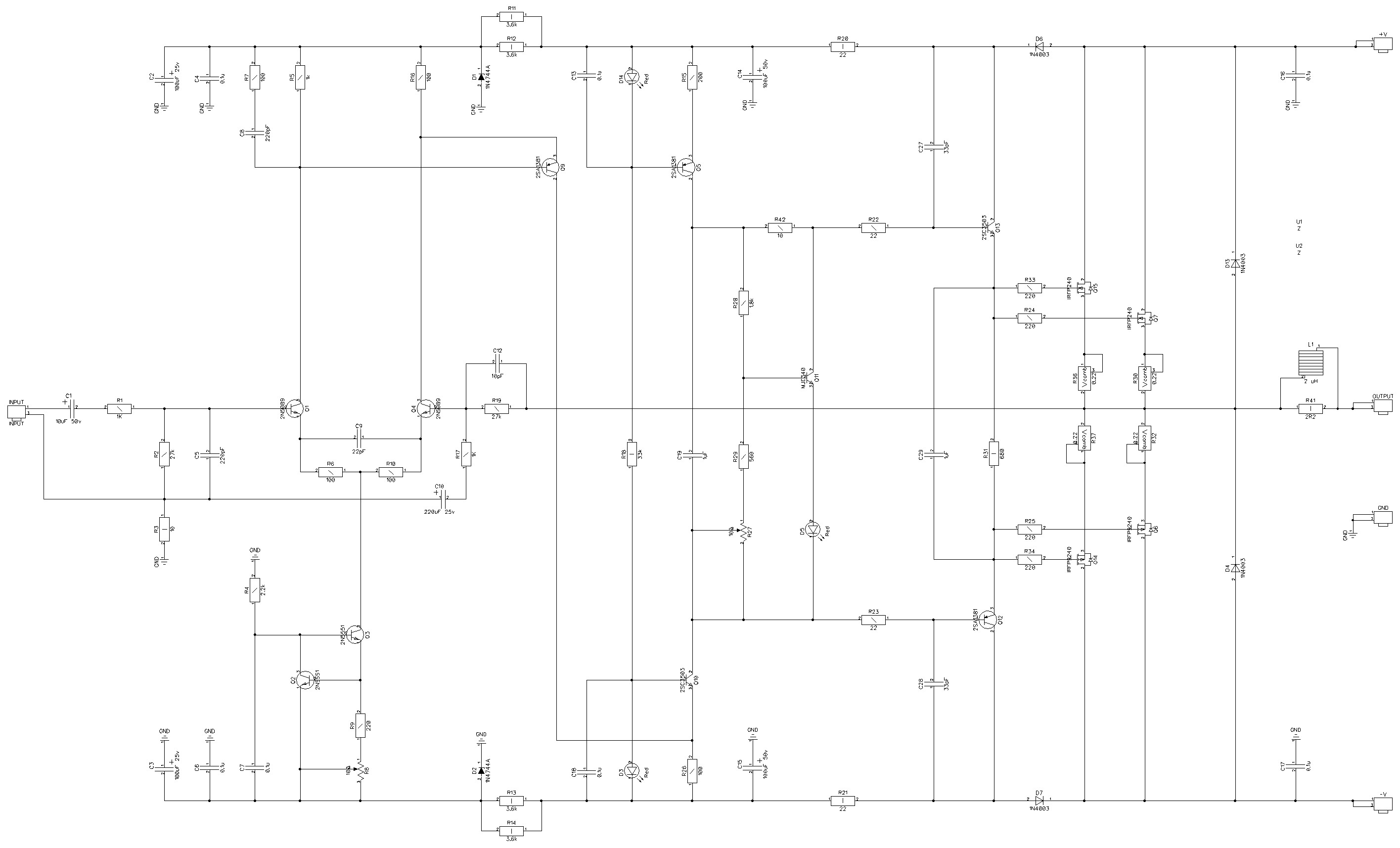

OK, here's the V-Hex sim.
Except for the bode plot, which does not seem to fulfill the stability requirements, THD and Square Wave look quite good I think.
The Models I used are all Cordell's, which probably other LTSpice users have.
I'm relatively new to LTSpice, so more experienced users are welcome to try the files and run them. And please do tell me what are your findings.
One thing I have wondered, since I knew about the potential stability Bode plots show, is how does it manifest itself.
If amps have already been built with this schematic, and they work fine, then something should be wrong on the simulations. And I would certainly like to know about that.

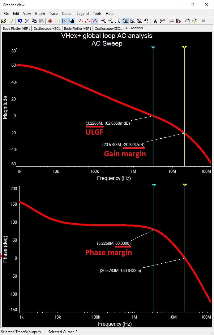

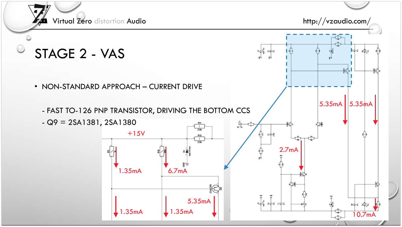

Hi Carlmart,
In order to see the stability margins, you need to analyze not the amplifier's bode plot, but the feedback loop bode plot. Normally, the Tian probe is used for that purpose in LTspice.
1-st picture is what the feedback loop analysis shows (Multisim presentation):
- gain margin = 20db;
- phase margin = 80 degrees.
2-nd picture shows the key currents in IPS-VAS sections.
Rails voltage for "as-is" configuration is +/-48...52V DC.
Driver stage idle current is 12mA, output transistors' idle current is 80mA per each output pair - roughly 36mV across 2 x 0.22R resistors in series.
Valery
P.S. It's important to set the trimmers in your sim in the right positions for having zero offset and 80mA idle current per output pair for the sim to show the right results.

Valery,
First of all you should know that my knowledge of LTSpice is limited, I am learning how to use it. That's why I uploaded the asc files for anyone who knows more to run them.
The bias trimmer I had set for the current you told me (85mA), though I didn't know it was for each pair. The total idle current now, after readjustment, turns out to be 197mA. Each MOSFET has to dissipate 3.84 W. Is that correct?
The DC offset is 286uA with the trim I used, which is quite close to zero.
THD @ 1KHz is 0.00075%, which is very good, at 95W into 8 ohms, using +/-48v.
I do not know how to use the Tian probe, so I would love to have someone show me how to, and how to read the results.

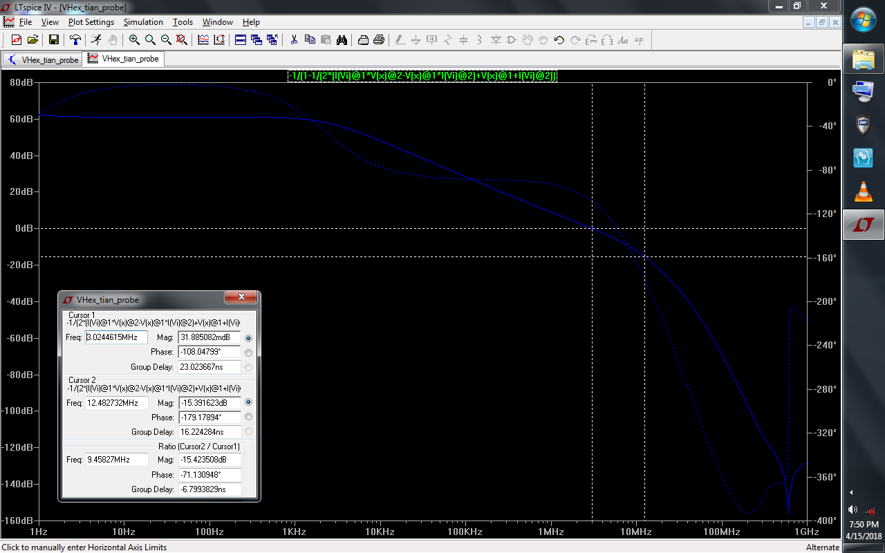

To measure phase margin and gain margin with LTSpice using the Tian's Method:
. No signal input
. Insert a Voltage Source and a Current Source in the feedback path as in the attached .asc file
. Define AC analysis from 1 to 100MHz .ac oct 500 1 100Meg
. Add spice directive .step param prb list -1 1
. Run simulation and plot this expression:
-1/(1-1/(2*(I(Vi)@1*V(x)@2-V(x)@1*I(Vi)@2)+V(x)@1+I(Vi)@2))
I have also attached the plot setting file (rename .txt to .plt) with the above defined expression, so if you run the simulation you have the result directly.
In this case phase margin is 75° and gain margin is 18dB and so in normal use (closed loop) the amplifier will be stable.
