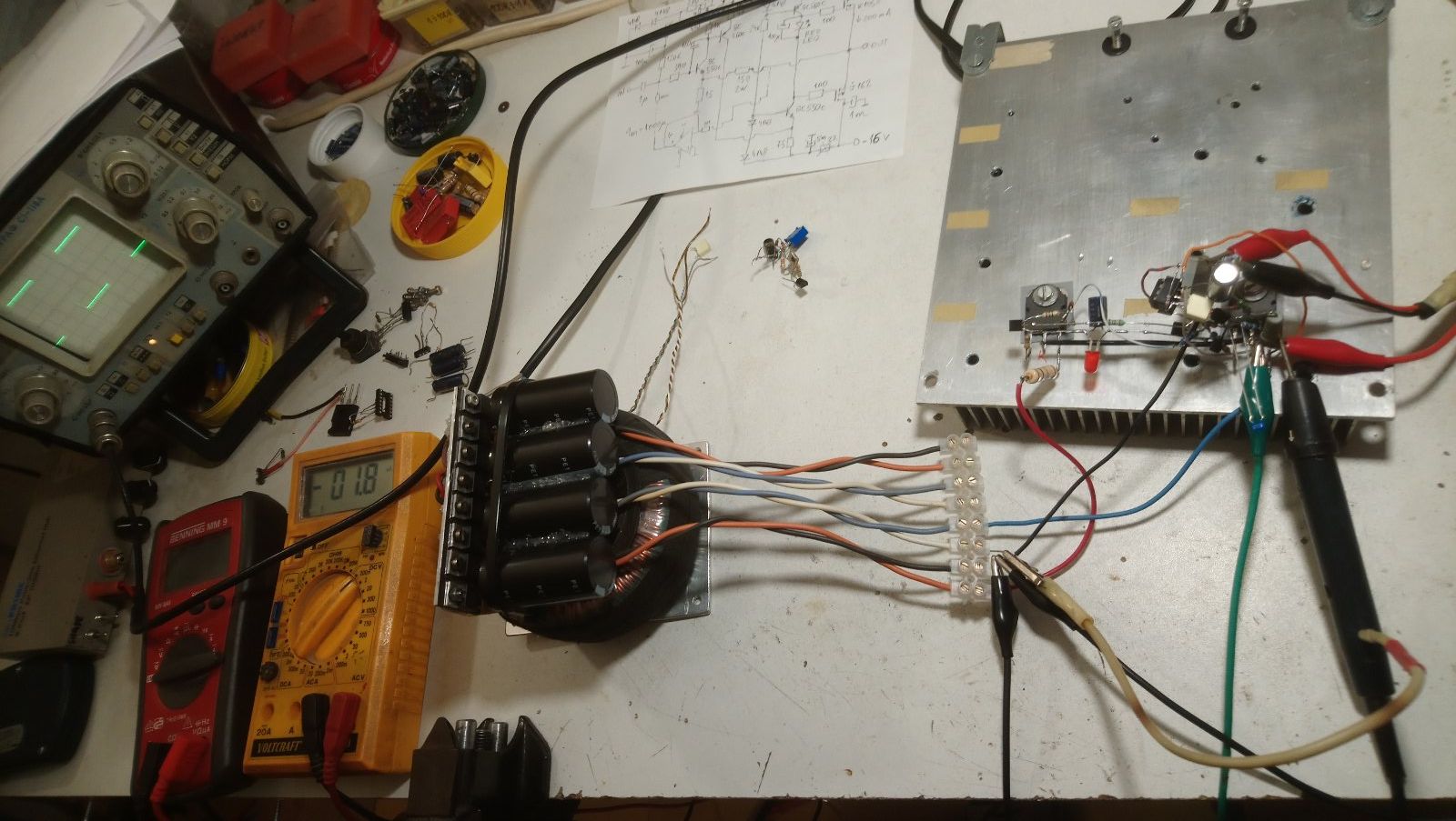

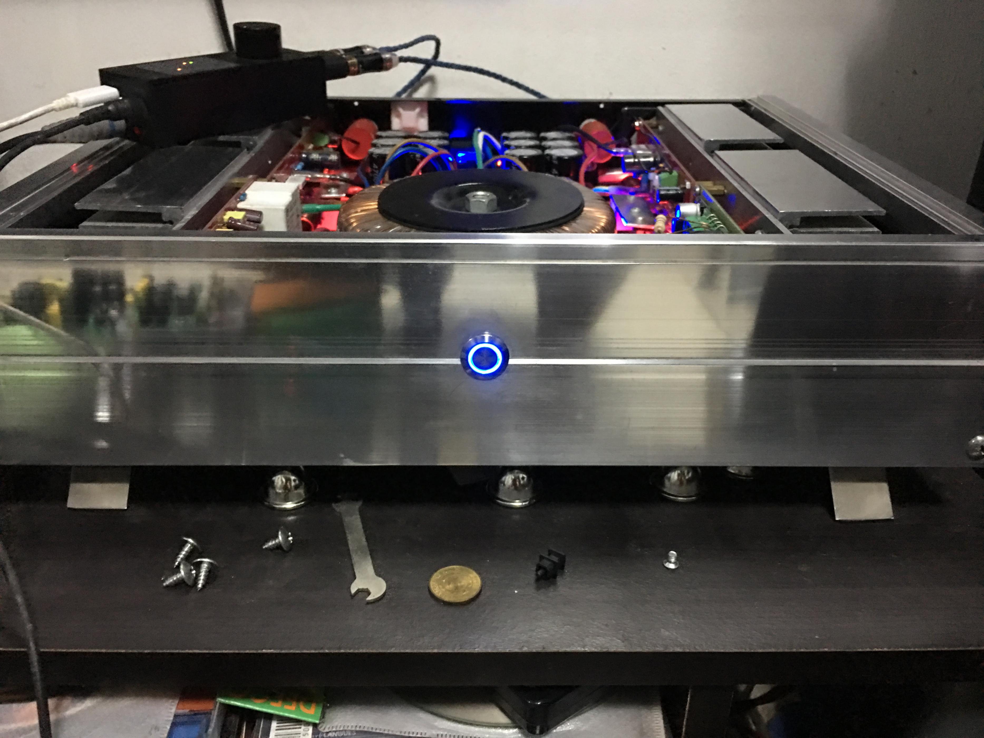

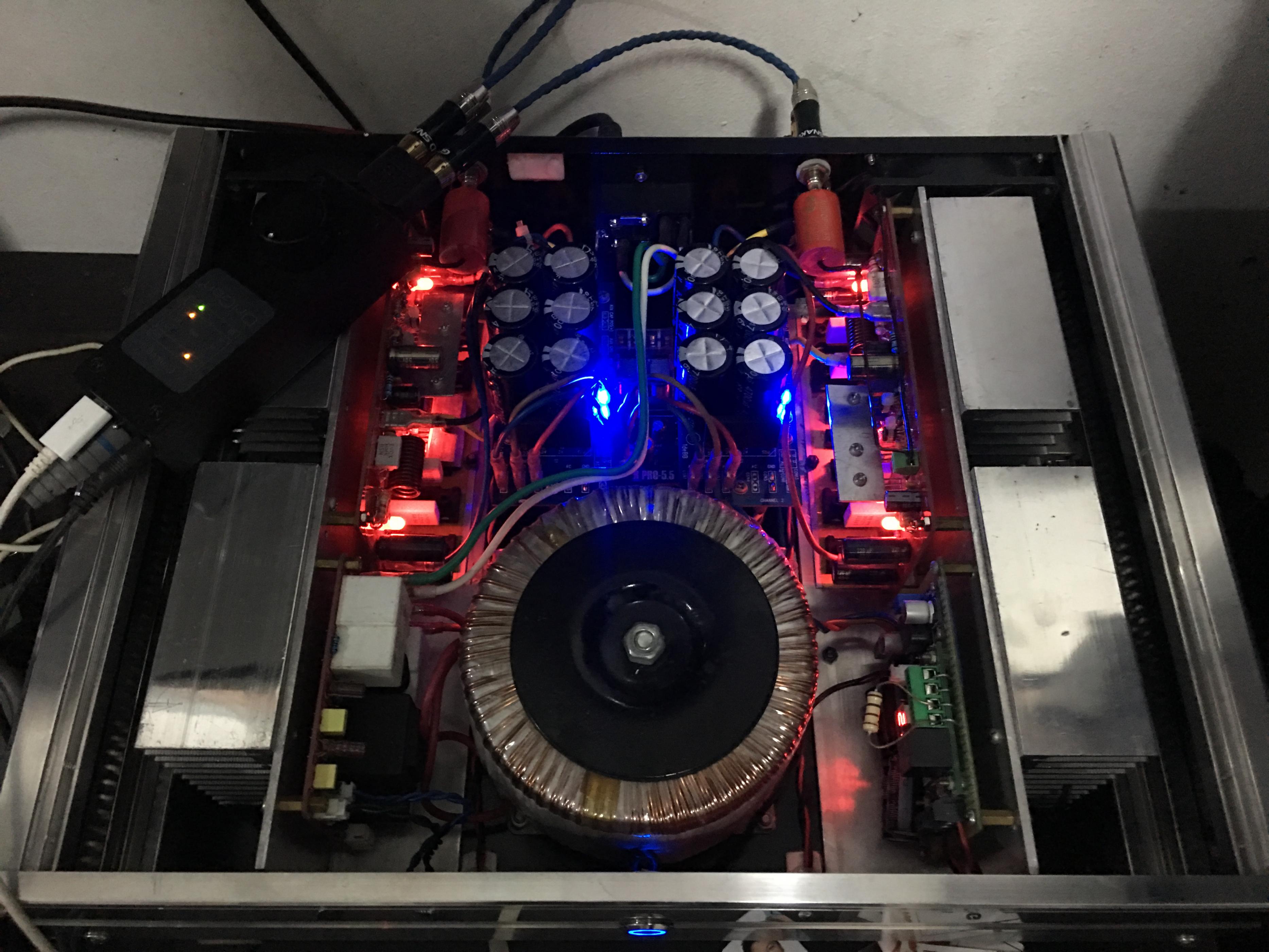

Hello Valery,
My long overdue VHex+ project, a close friend of mine built it. My board design seems a little bigger because I am using parts locally available (Toshiba devices). In the actual build R24 was changed to 680r to accurately adjust idling current. Build is still in progress.
Cheers!

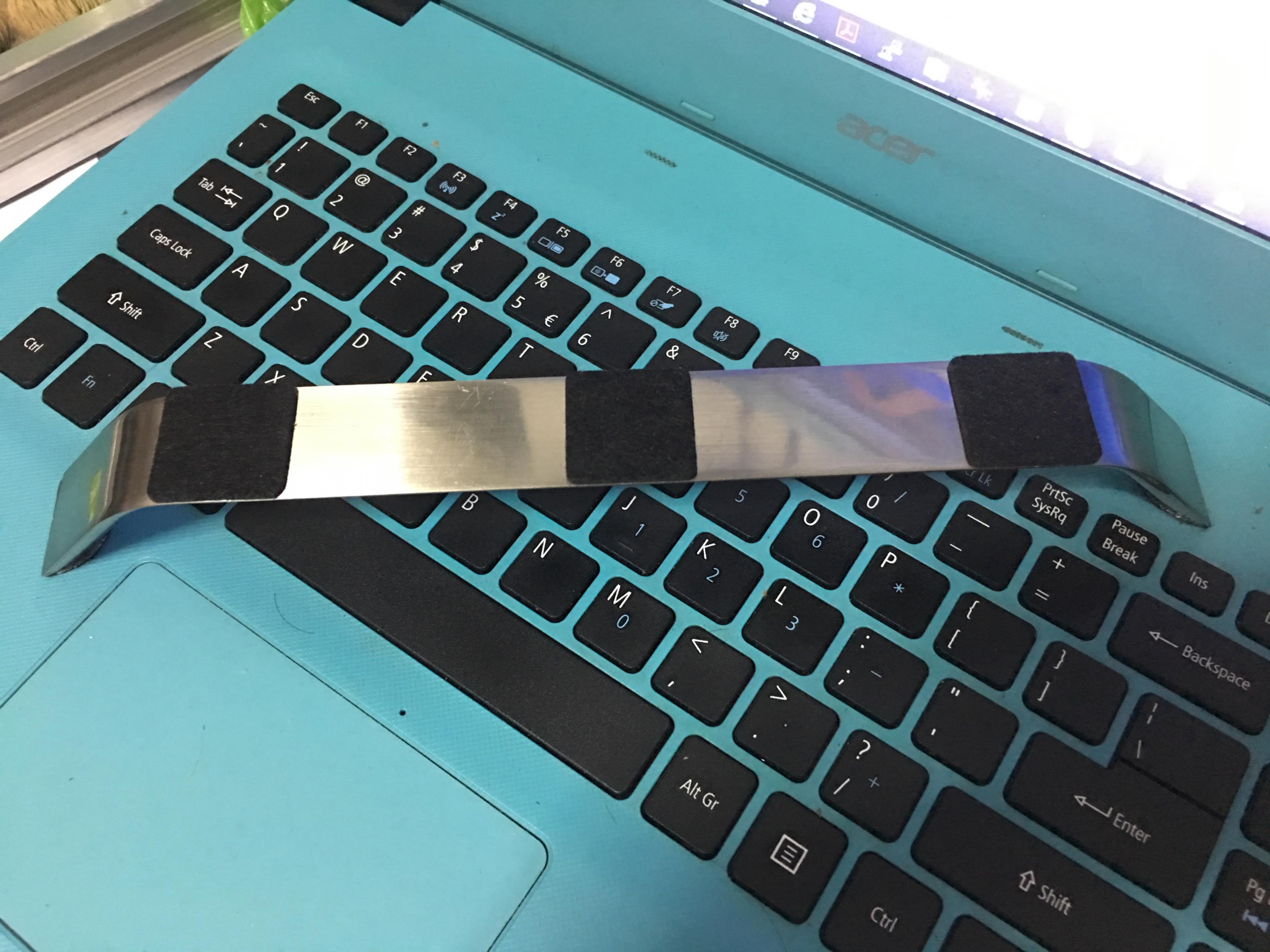

I was backreading when I found this. 🙂 I wasn’t aware Albert posted it here. Here’s the completed build. The amplifier sits on a pair of stainless steel drawer handles.😀😀
Hi Rough512,
Thank you for sharing - a beautiful build! Solid PSU, nice compartment
Valery

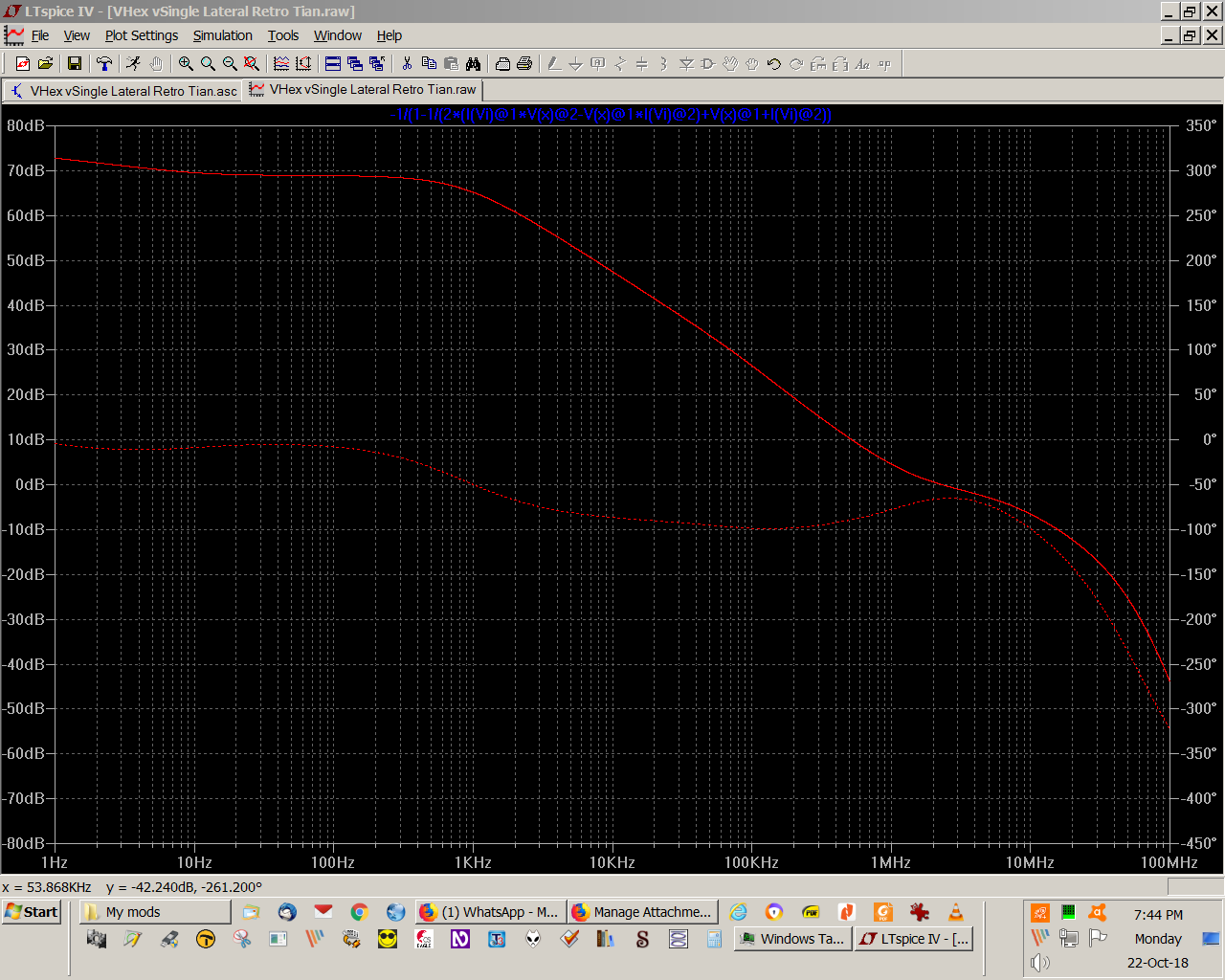

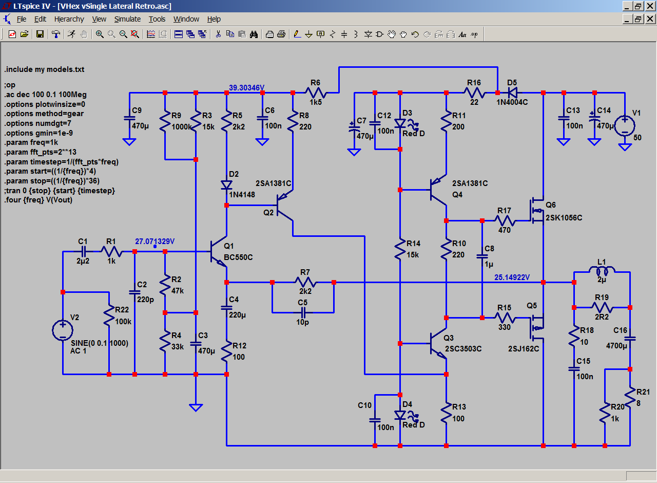

Dear Valery,
Using the latest Topology of current subtraction instead of Voltage subtraction, your Vsingle is ideally suitable for Retro mod. Please see the files enclosed. Is the project viable ? Can you please check the stability of my scheme? Any values to be changed ?
I am particularly interested in your comments on values of R7, R12 & C5.
--gannaji

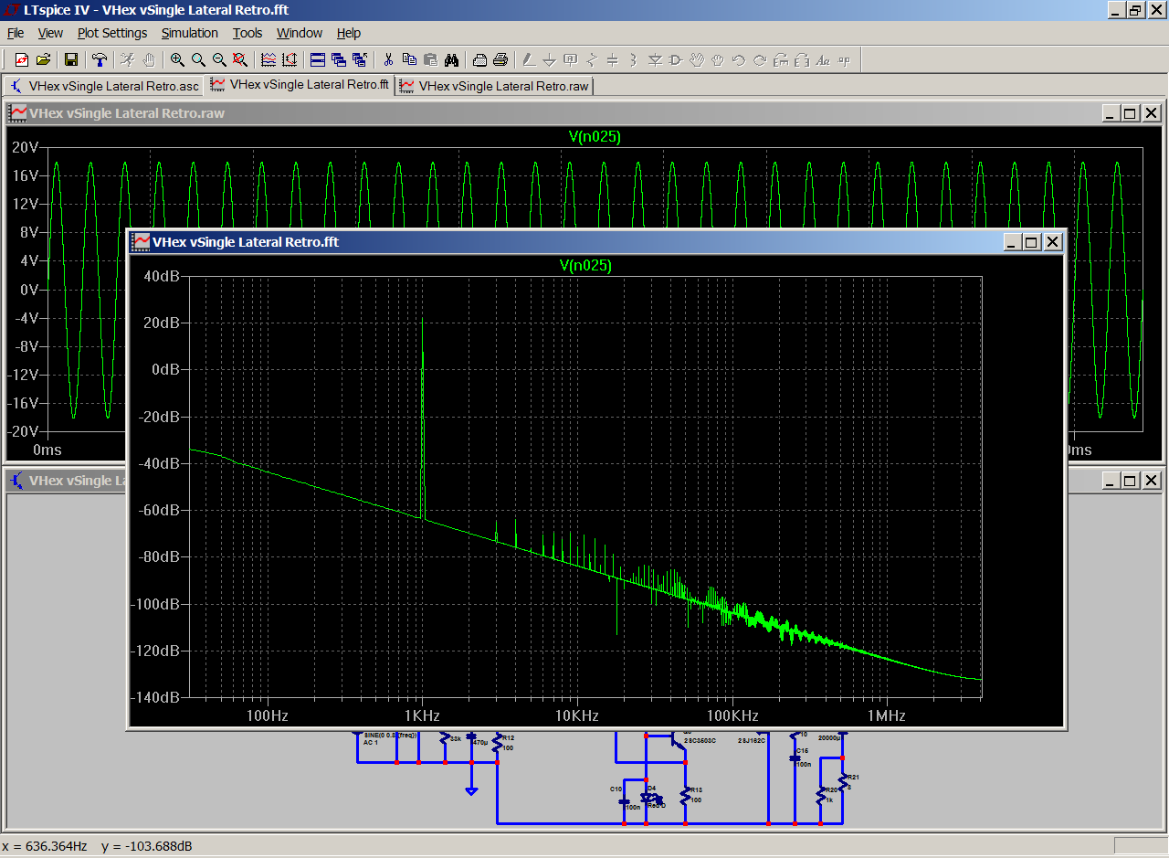

Hello All,
A very simple front-end desidn, based on the same principle, as the first VHex front-end. The critical, most non-linear piece is a single-transistor transconductance stage at the input (Q4). All the rest is driven by the current - highly linear current conversions.
Open loop 1KHz THD is less than 0.05%, with 40db NFB it comes down to 0.0005%, showing around 0.001% in combination with VHex+ OPS (2-nd picture is showing the Fourier analysis at 50W @ 8 ohm, +/-50V rails). 2-nd and 3-rd harmonics are dominant, all the rest are significantly lower.
Simple light compensation, good stability margins.
The VAS output stage can be easily adapted to any swing (OPS rails) - just adjust the value of R16 for having around 3mA through it.
PSRR is lower than the one, shown by the balanced designs, so I recommend to use regulated +/-15V supply (or at least having the good cap multipliers).
The layout is going to be rather simple - a good exercise for somebody who'd like to try 😉
Valery

Hi Gannaji,
Sorry for delay 🙂
I like the idea of such a simple configuration
Valery

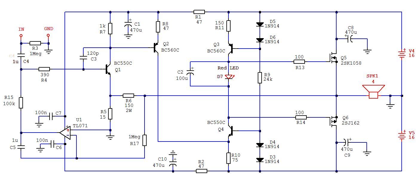

Hi vzaichenko,
I saw your vSingle front-end (post #409 of this thread) and liked the idea so I experimented with it, changed it somewhat and built a nicely working prototype of 8/16 W (at 8/4 R) amplifier.
The amp is very tame and stable (capacitive load test - 3R3 || 1uF). R6/R5 sets the gain (~20dB) and D7 biases the OPs (Lateral MOSFETs) at about 200mA. TL071 holds the the output DC offset at 2mV. PSRR is not bad either - ear to the speaker detects no noise so I guess output noise is about 100uV or less.
PSU has 4 x 12Vac/200VA toroid, schottky rectifier and two 22,000 uF caps.
As for the sound, I built just one channel so I listened mono only. Nevertheless, the presentation is surprisingly pleasant, tonally coherent and clean - very enjoyable (even large orchestra) and that's why I'm reporting the build.
I won't develop it further or build the stereo version (many projects are waiting) but it's nice to know that this topology performs well.

Excellent work, juma.
This is one of the greatest virtues of current driven TIS. This is why VHEX+ is one of my favorite amp. Are you planning to build it with a higher supply voltage?
