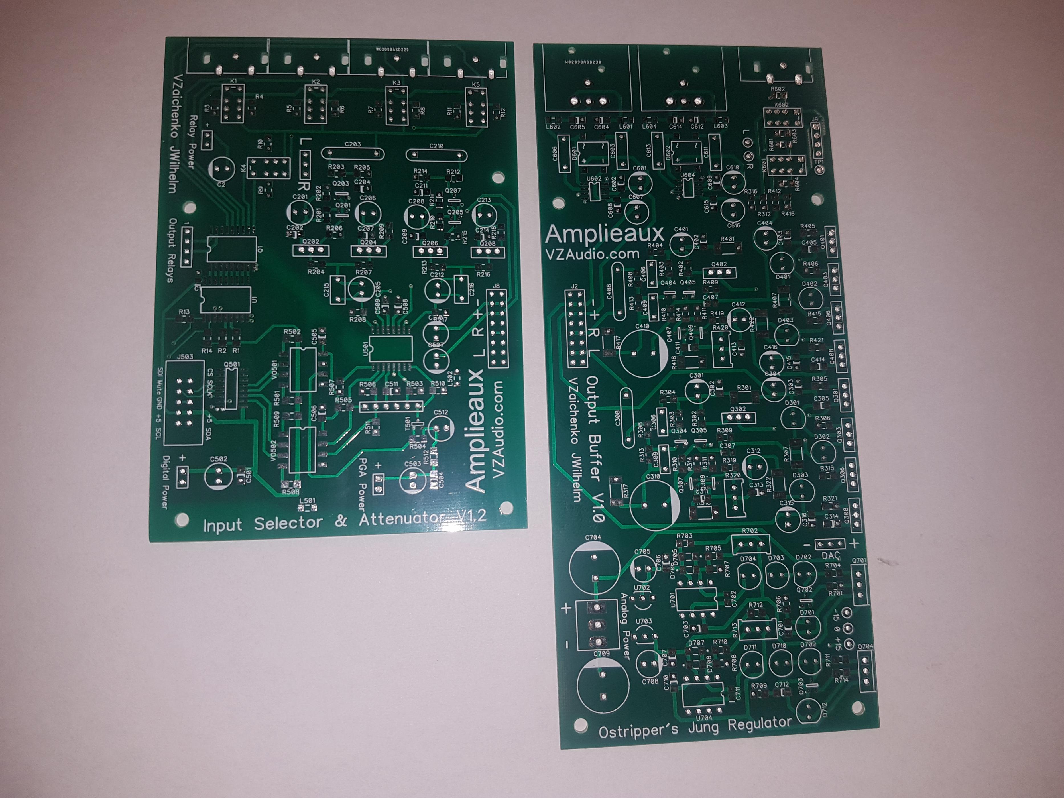

Here's the first stage of a preamp using a modified version of the Ampliwire input. it also uses Ostripper's version of the Jung regulator for the analog supply.
Where are the schematics for these pcbs?
Once this project progresses a bit farther I'll start a new thread in the analog line section of the forum. I have the boards populated and debugged and have done initial testing looking good and very quiet so far.

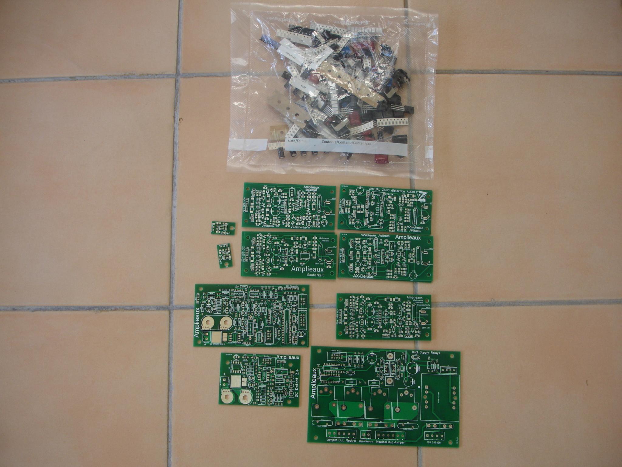

Boards received
Jeff,
Received the VHEX+, protection, and PSU boards. All arrived safely. Woohoo! Now I just need to get those BOMs ordered.
The customer service with you guys is awesome. Very fast to respond to all of my emails: VZaudio is very good to deal with!

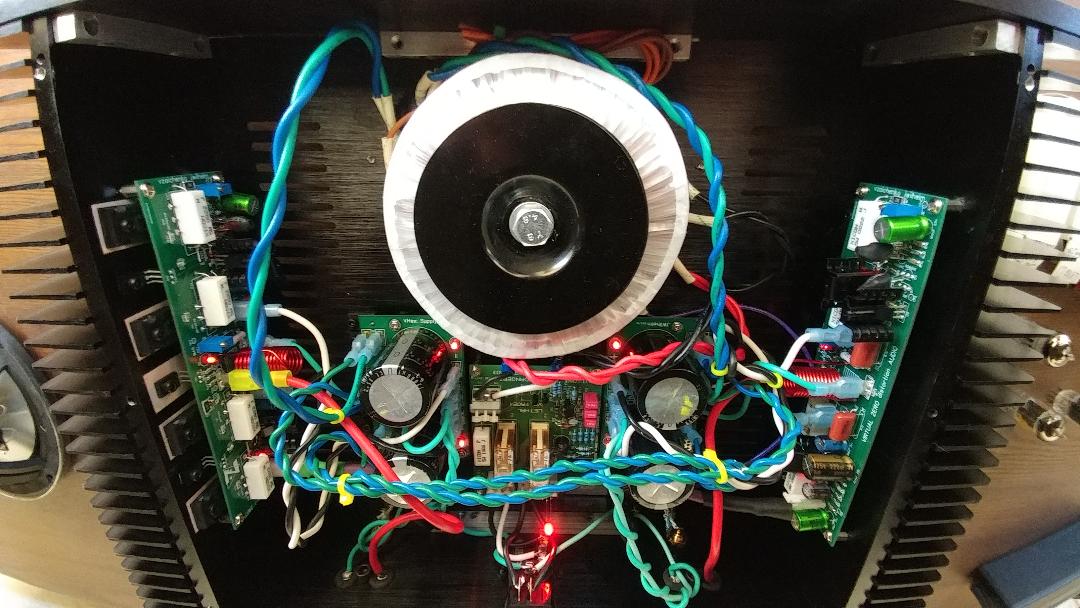

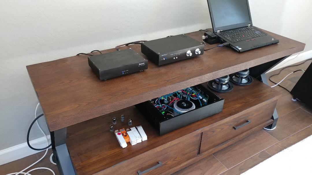

My VHEX+ build
A big thank you to Jeff and Valery for my build!!
Jeff was awesome at answering questions, and always available and quick to respond. Not possible without him.
Just finished it last Saturday.
Will post a full-build post later.
Making fantastic tunes at my house with the Martin Logan Montis. This amp is a sonic blockbuster. Period.
