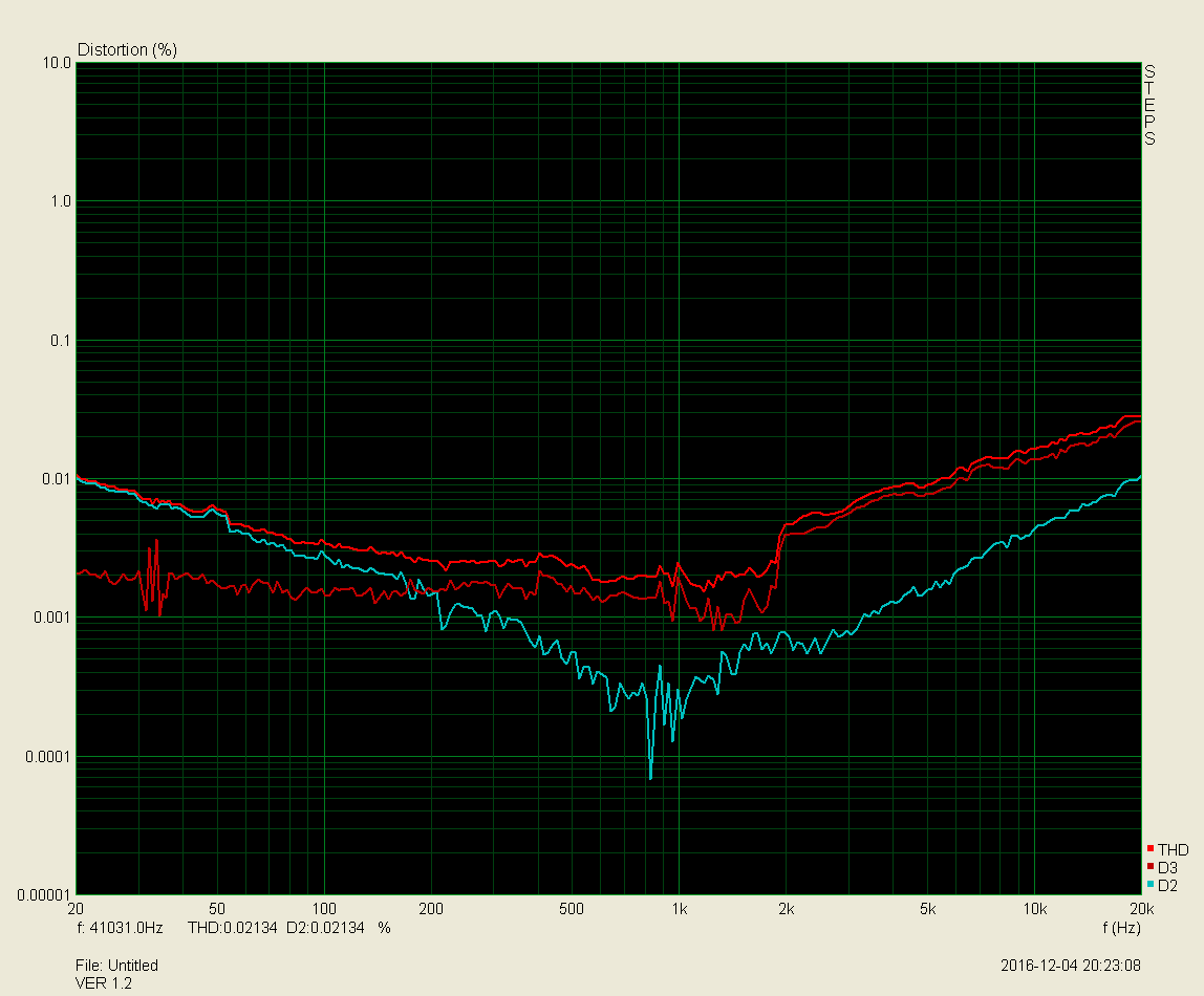

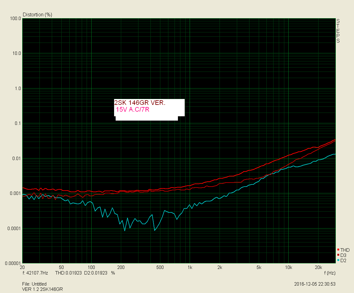

Better overall DC balance leads to lower distortion, especially below 1KHz.
Interesting result 🙂 One more proof that matching really makes sense, especially in the input LTP.
The other interesting find is that matching input fet ONLY is enough for 0V d.c offset IN THE MIDDLE OF TRIMMER.Better overall DC balance leads to lower distortion, especially below 1KHz.
I've been doing a quick match with a cheap meter for all the VHex input transistors. I rarely need to adjust DC offset at all. They all seem to run nicely within 3mV.
i'm guessing the 2sk146 having a lot more transconductance at the operating current probably helps the distortion too.
Folded cascode is helping mitigate distortion increase as frequency increases, in spite of much larger capacitance of 2sk146. It's a large geometry part, famous for large gain, very low noise and high cost, when you can even find them.

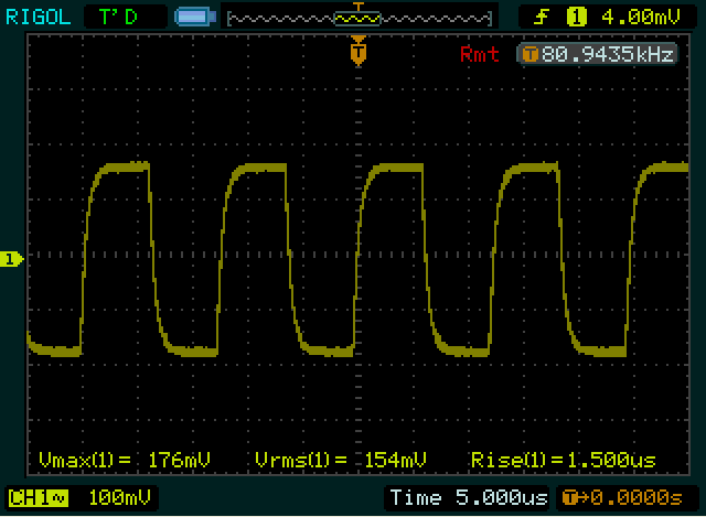

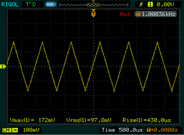

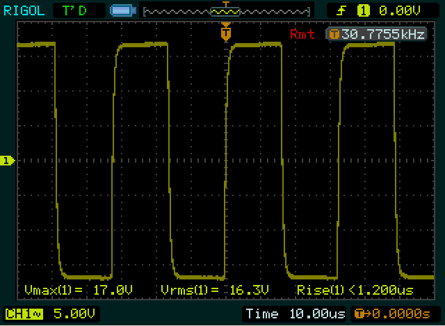

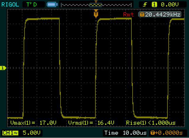

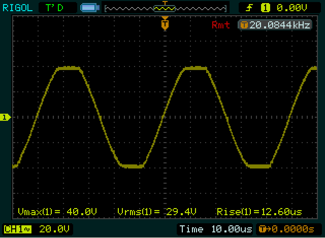

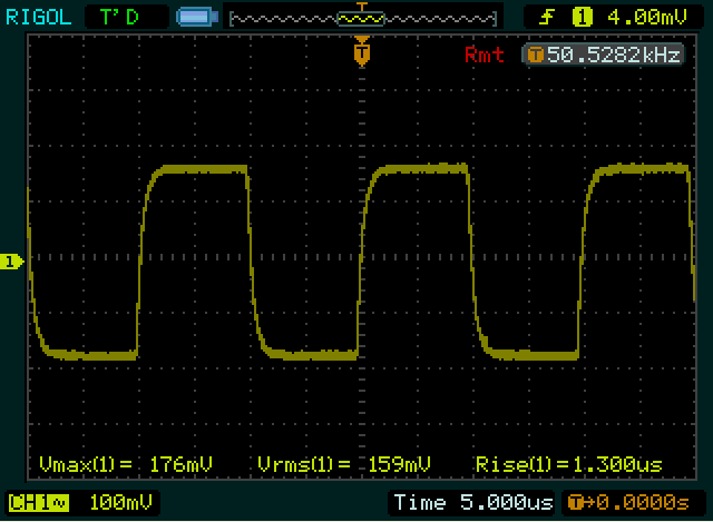

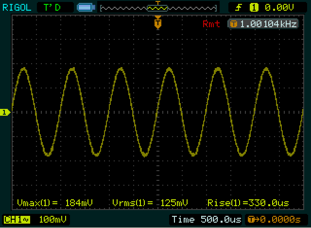

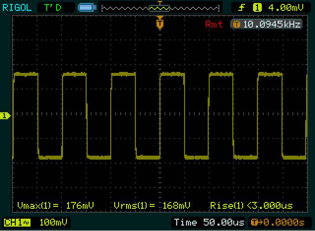

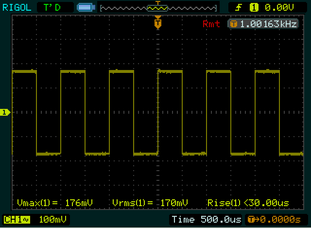

Scope test
Scope test

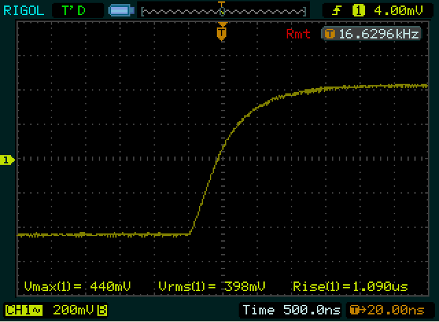

Scope test
Wow )) Better than my simulations 😀
Fast enough. Clipping is excellent
Do you mean ARTA STEPS at the higher amplitudes,or the rise time measurements at a higher level?It's better to see the step response at the higher amplitudes.
It will show some 40-50V/uS.
I actually mean this kind of picture for the rise/fall time. If you can see it at higher amplitude - like 50Vpp or so - you will get more precise measurement.
Look at your 20KHz square wave - it makes around 35V in less than 1uS.

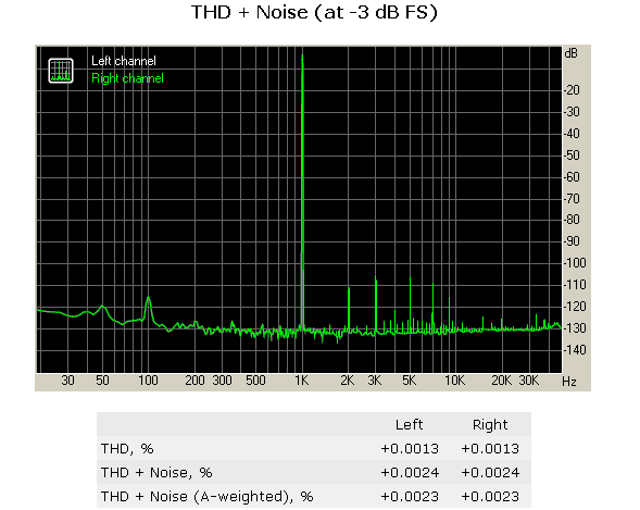

Sons of Vhex ver.1.2 2sk146GR

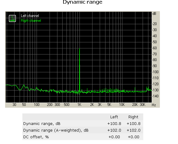

Today Sons tested using capacitance multiplier for input and vas stage but i can't see any further improvement.
PSRR is good enough
It's like trying to zip a jpeg - it doesn't compress any more 😛

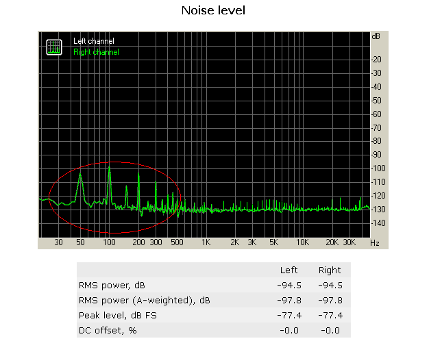

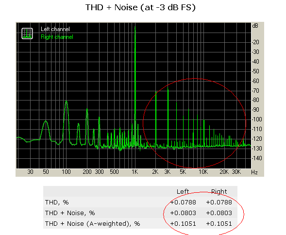

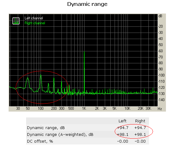

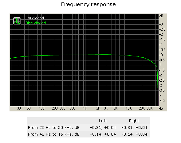

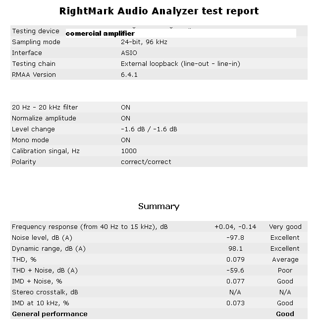

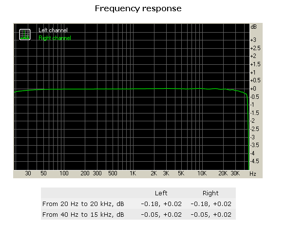

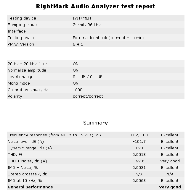

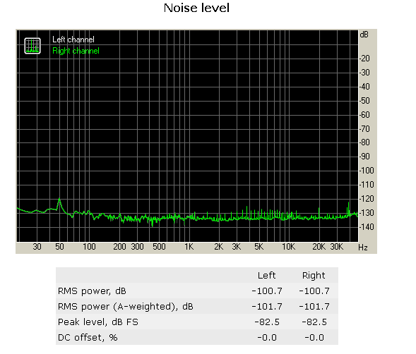

Terry,look these pictures.I see you post these graphs a lot. May I ask what you see in these and how they help you determine whether or not an amp is working well or not? What are you looking for when you look at them?
Thanks, Terry
It is from a commercial amplifier to be compared with the sons of vhex
