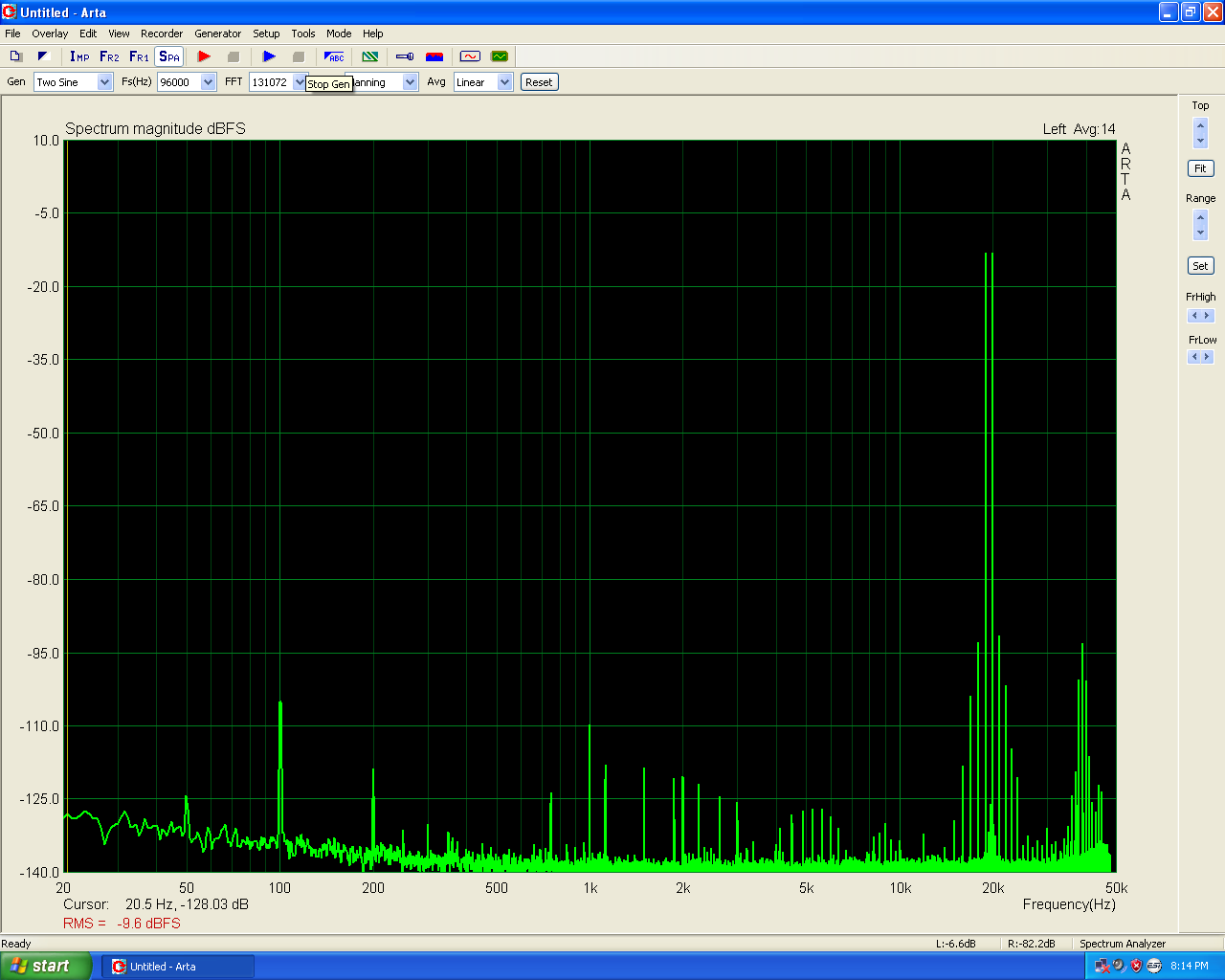

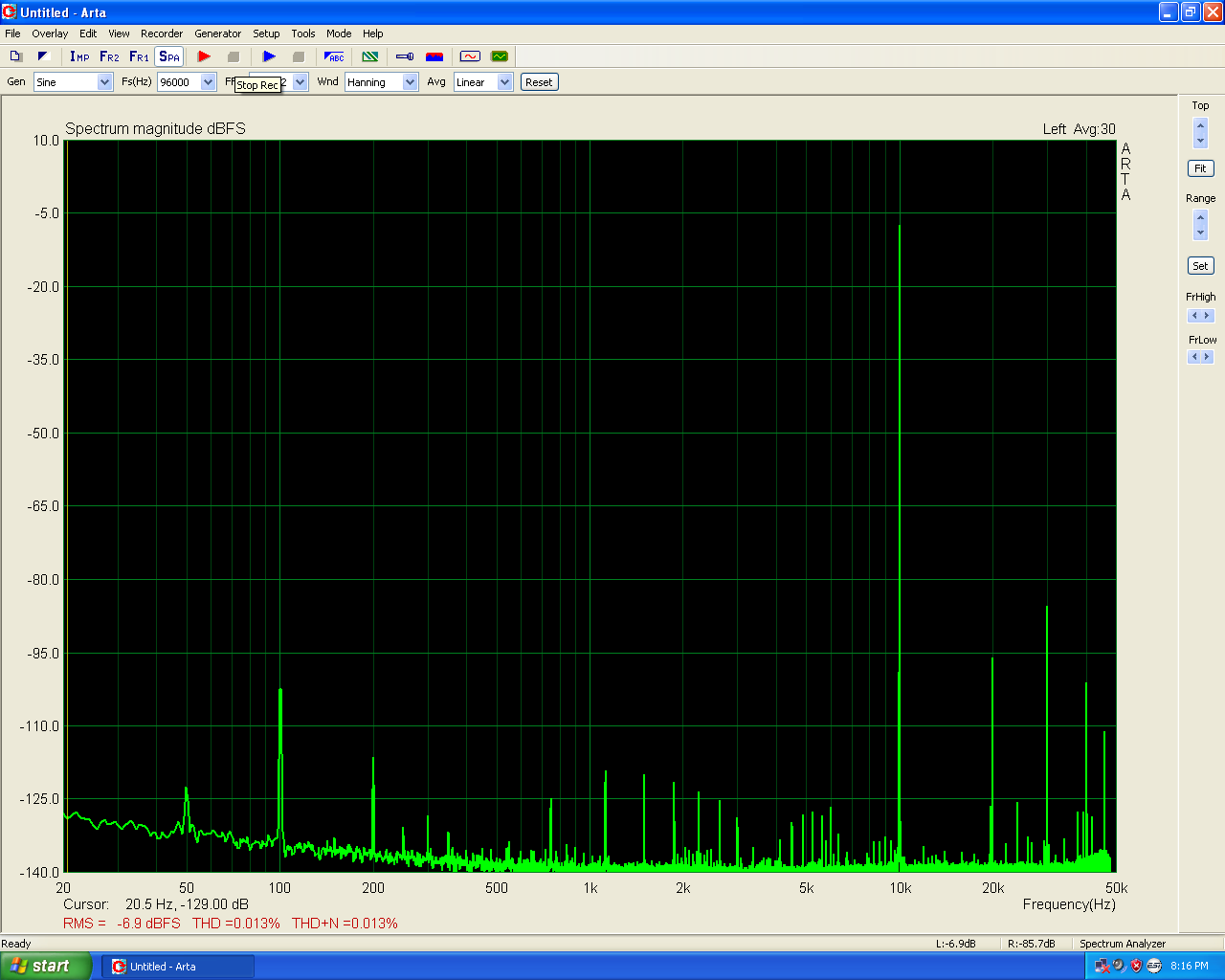

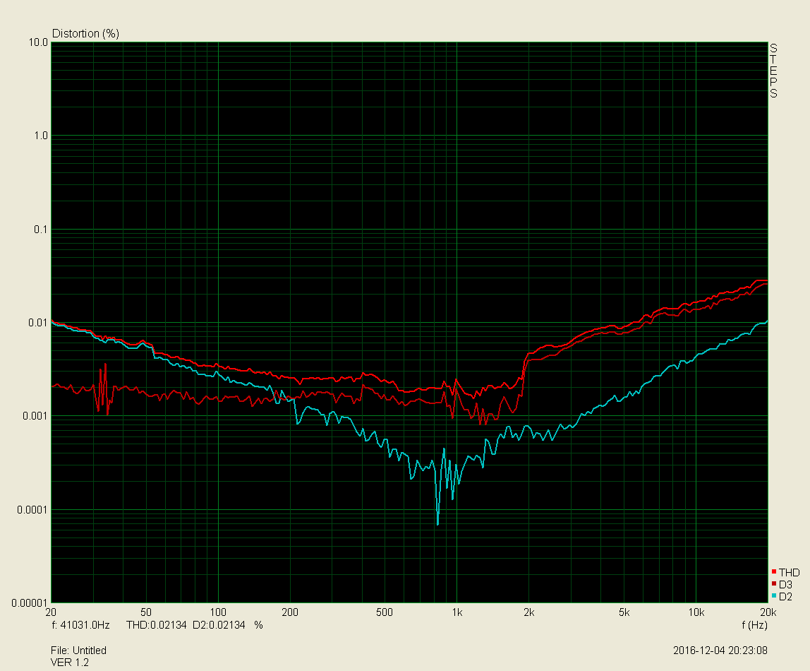

I believe that is ok.now.

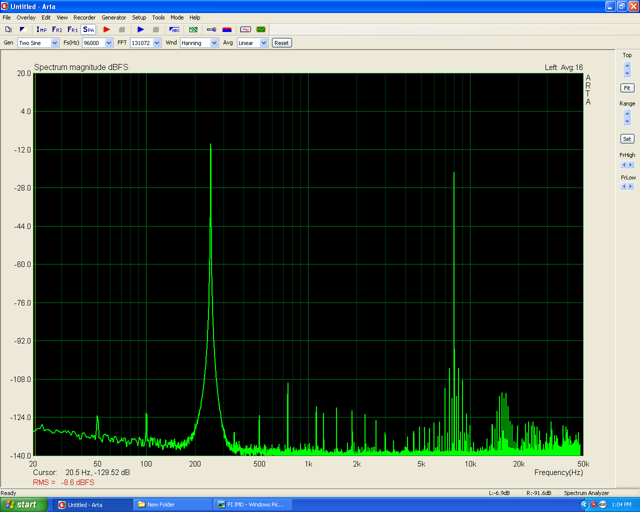

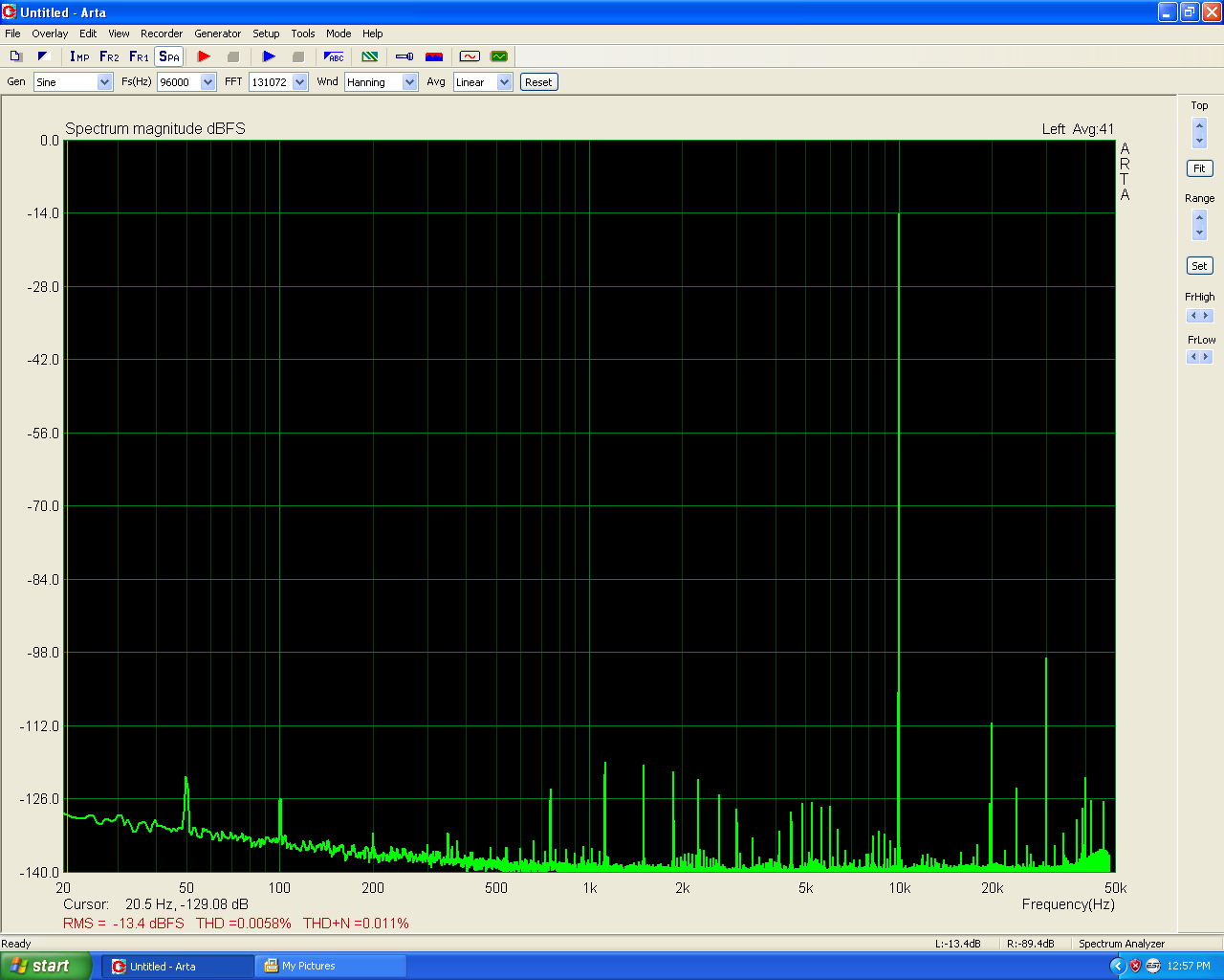

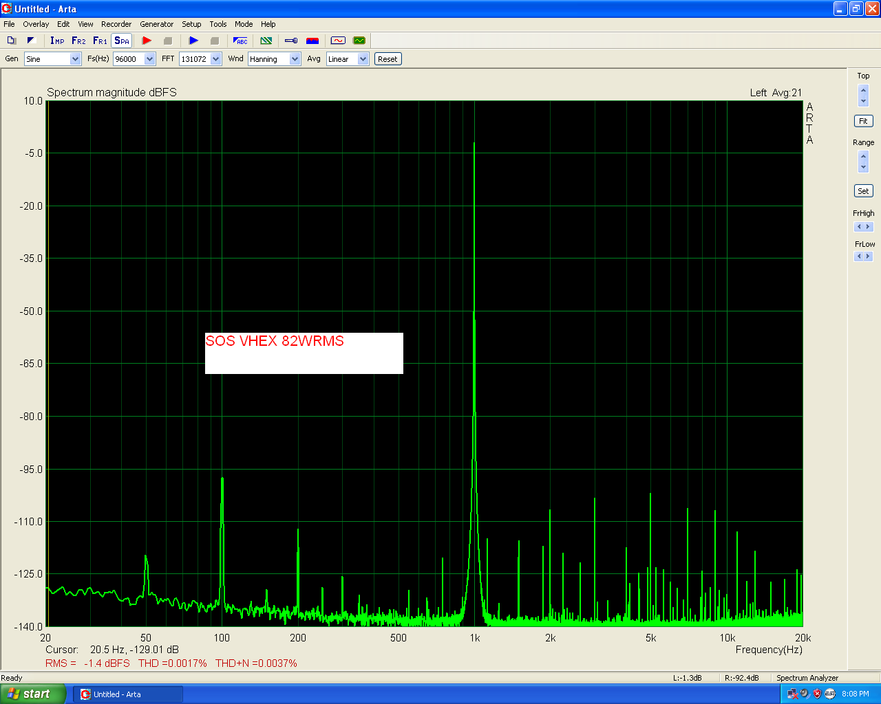

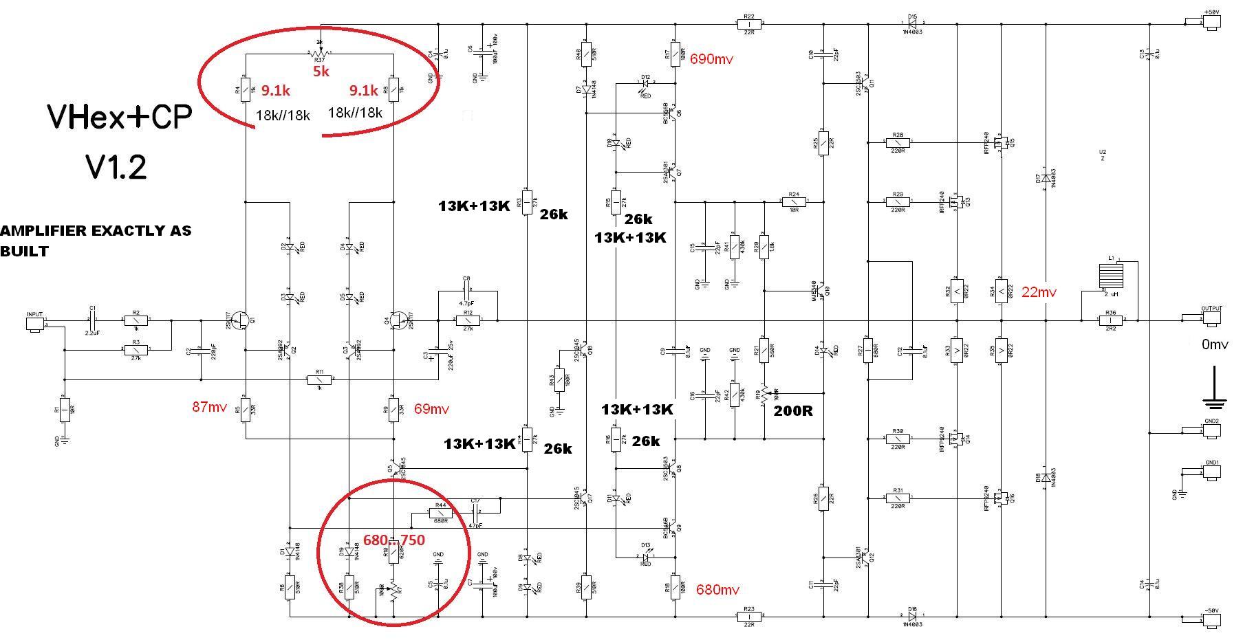

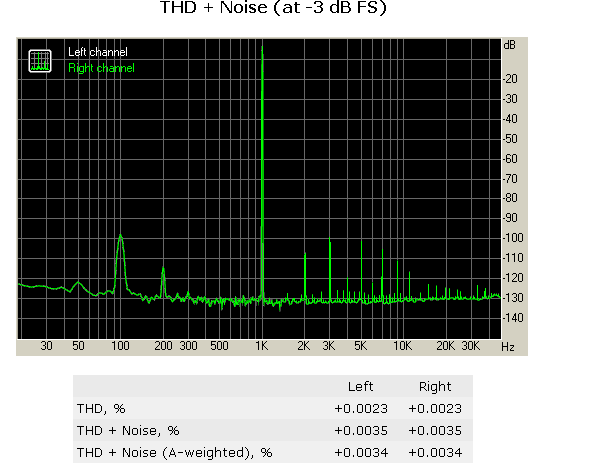

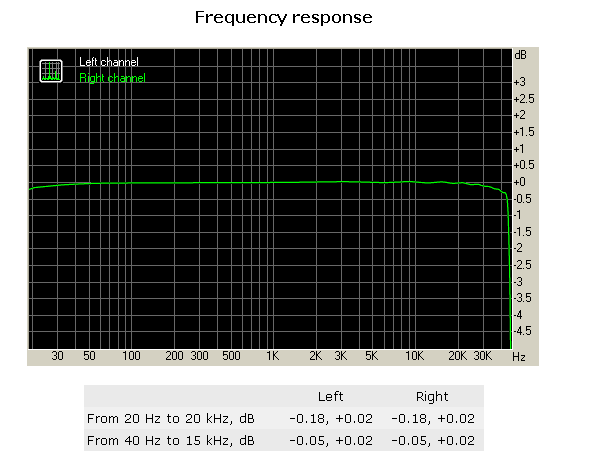

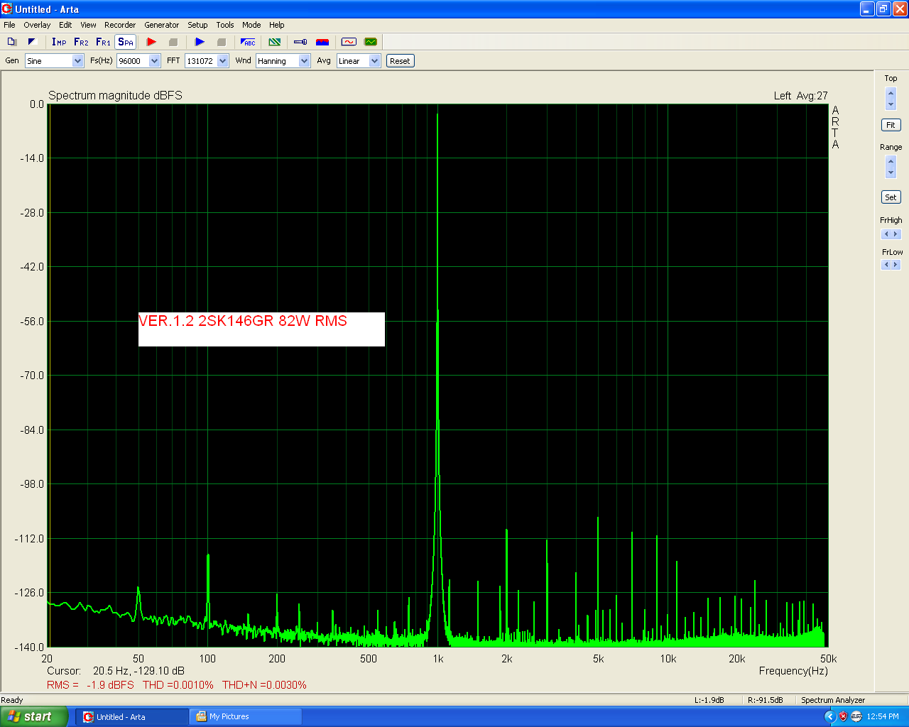

Sons of Vhex ver.1.2

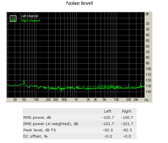

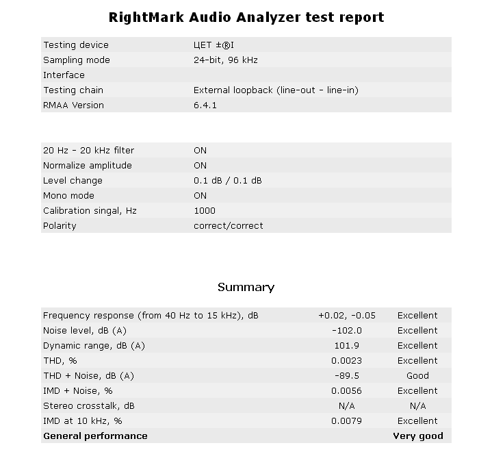

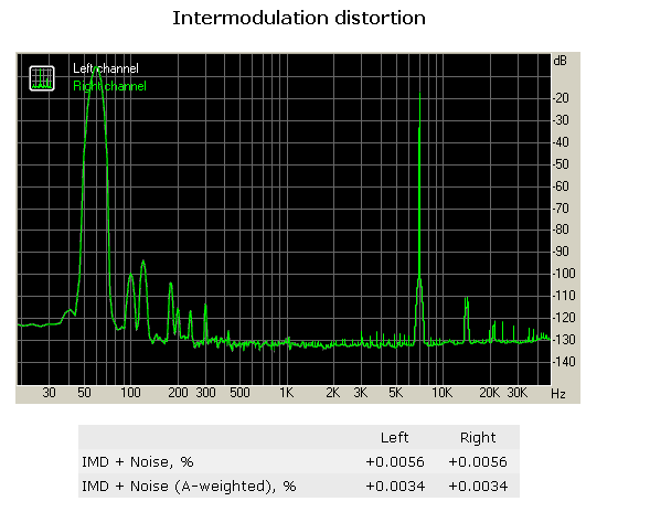

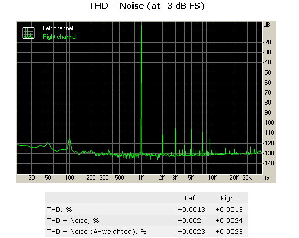

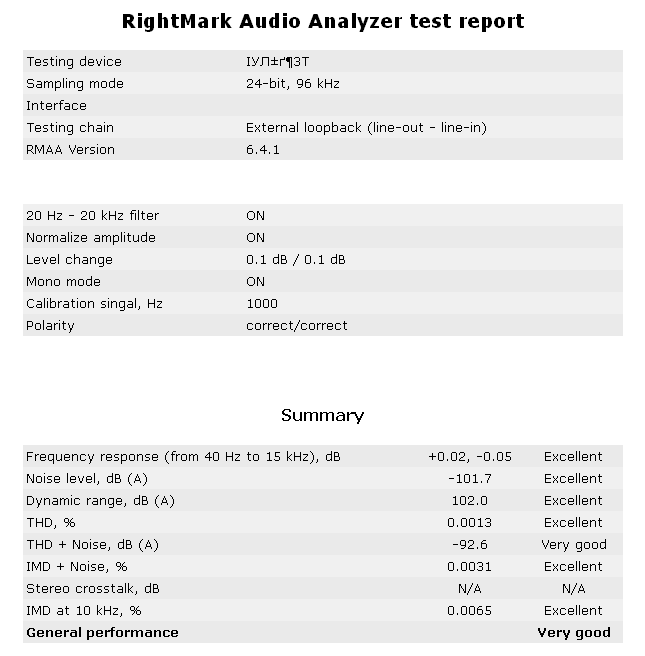

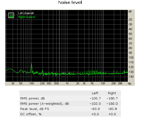

Using RMAA
Using RMAA

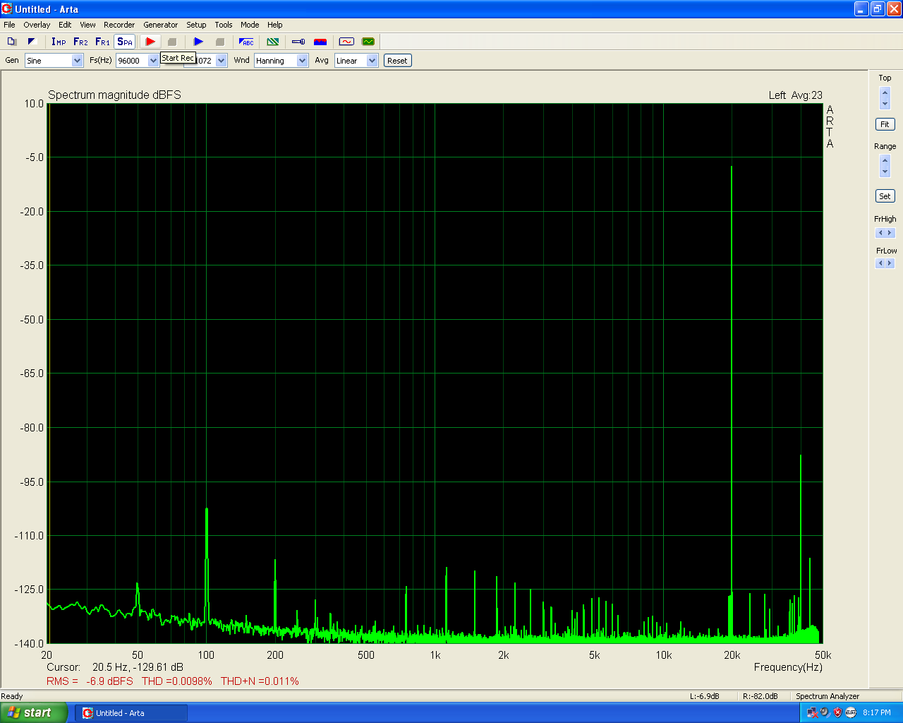

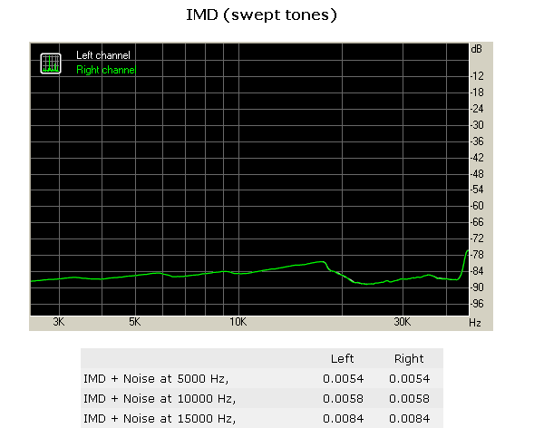

I must set the vas current at 6mA and try the 2sk146 dual fet later.
Note - current through the LEDs is around 1.7mA, so if you've got 6.9mA through R17, R18, VAS current = 6.9 - 1.7 = 5.2ma
Right!Note - current through the LEDs is around 1.7mA, so if you've got 6.9mA through R17, R18, VAS current = 6.9 - 1.7 = 5.2ma
So i must try a different R10 (680R-750R)to reach the 6mA vas current.
Right!
Yes, higher value of R10 will give higher VAS current. You need to reach around 770mV over R17, R18 for having 6mA at VAS collectors.
Be careful with the bias - it will slightly increase at higher VAS current.
Yes i know,but i wonder is it safe this operation for the vas transistors without heatsink?Yes, higher value of R10 will give higher VAS current. You need to reach around 770mV over R17, R18 for having 6mA at VAS collectors.
Right - I normally recommend small snap-on heatsinks for TO-126 devices, running with average power dissipation above, say, 250mW.
For running with no heatsinks, better leave it at 5.2mA - they must be warm already.
No,at present there aren't hot because of the winter 😉Right - I normally recommend small snap-on heatsinks for TO-126 devices, running with average power dissipation above, say, 250mW.
Heh-heh )) I also have some -5C here 🙂

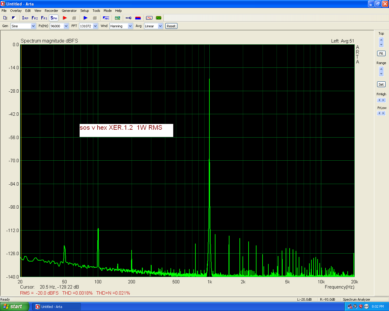

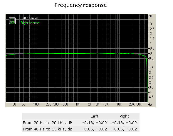

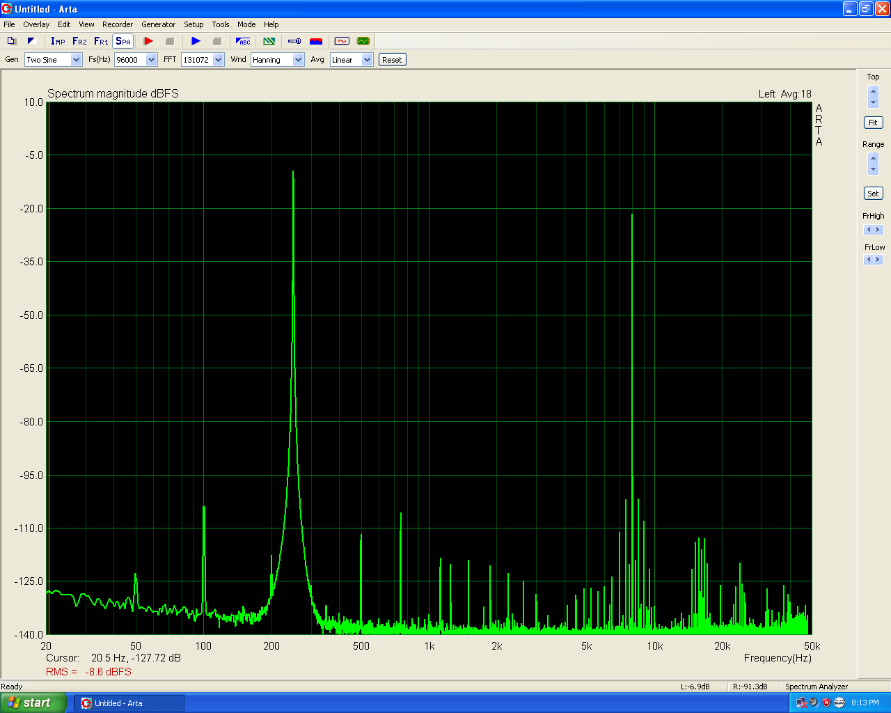

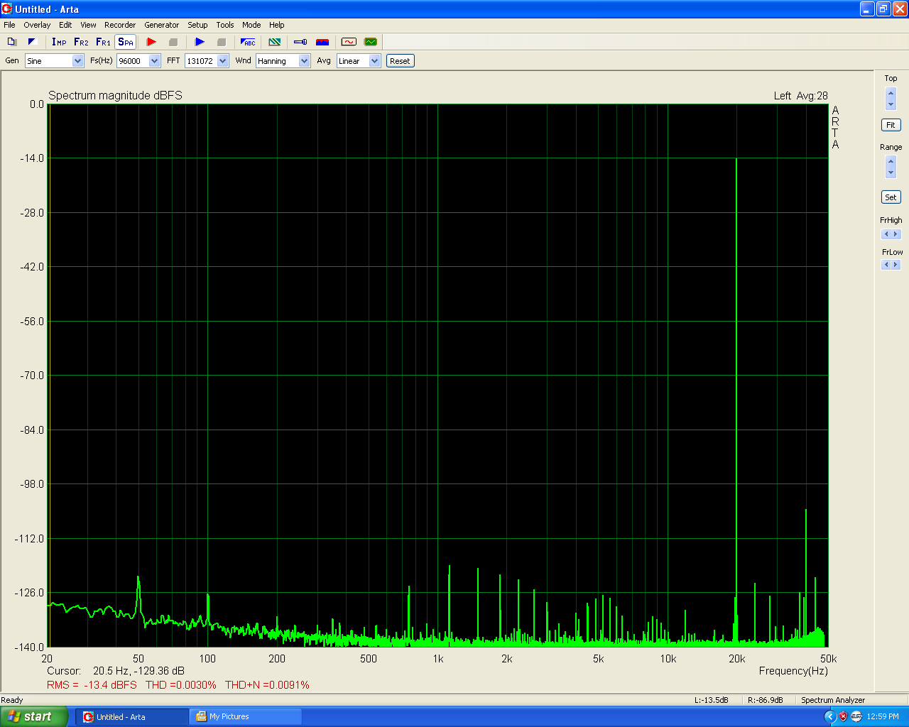

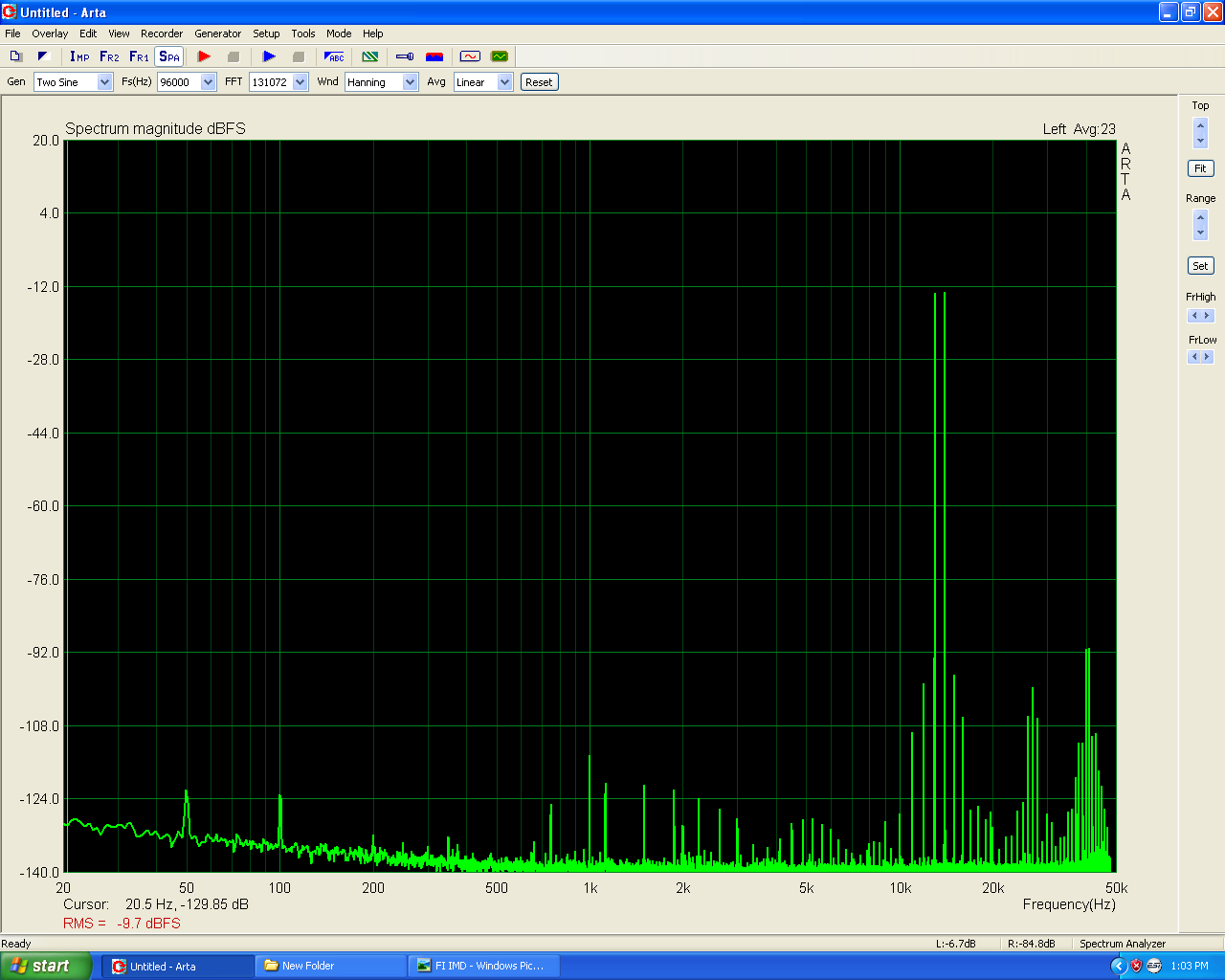

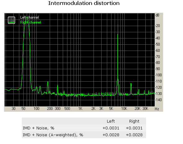

Using RMAA

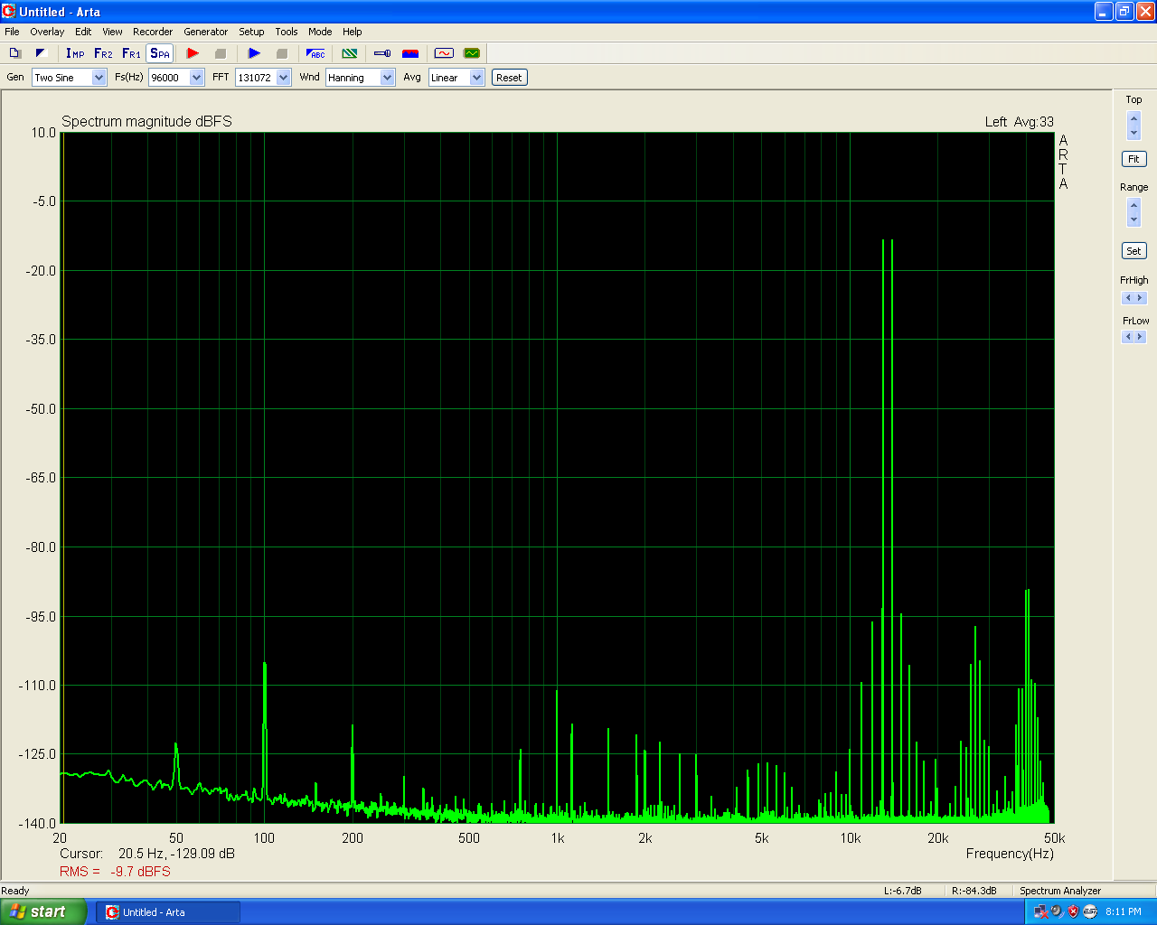

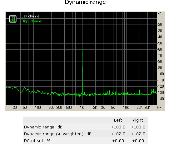

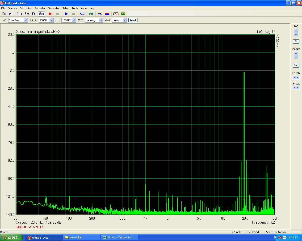

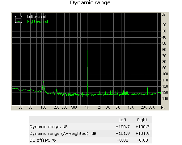

I see you post these graphs a lot. May I ask what you see in these and how they help you determine whether or not an amp is working well or not? What are you looking for when you look at them?
Thanks, Terry

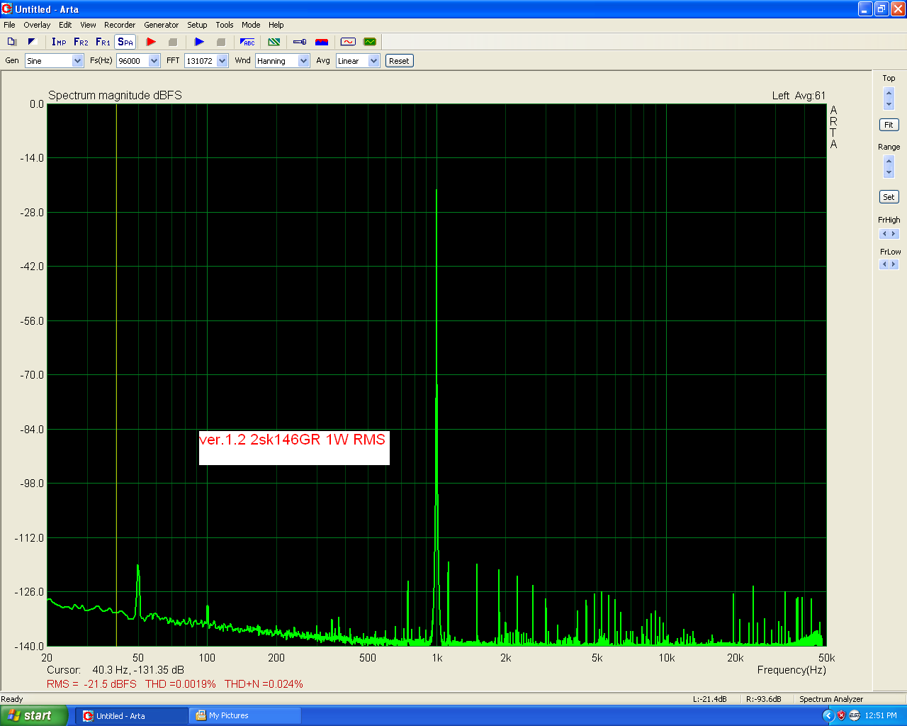

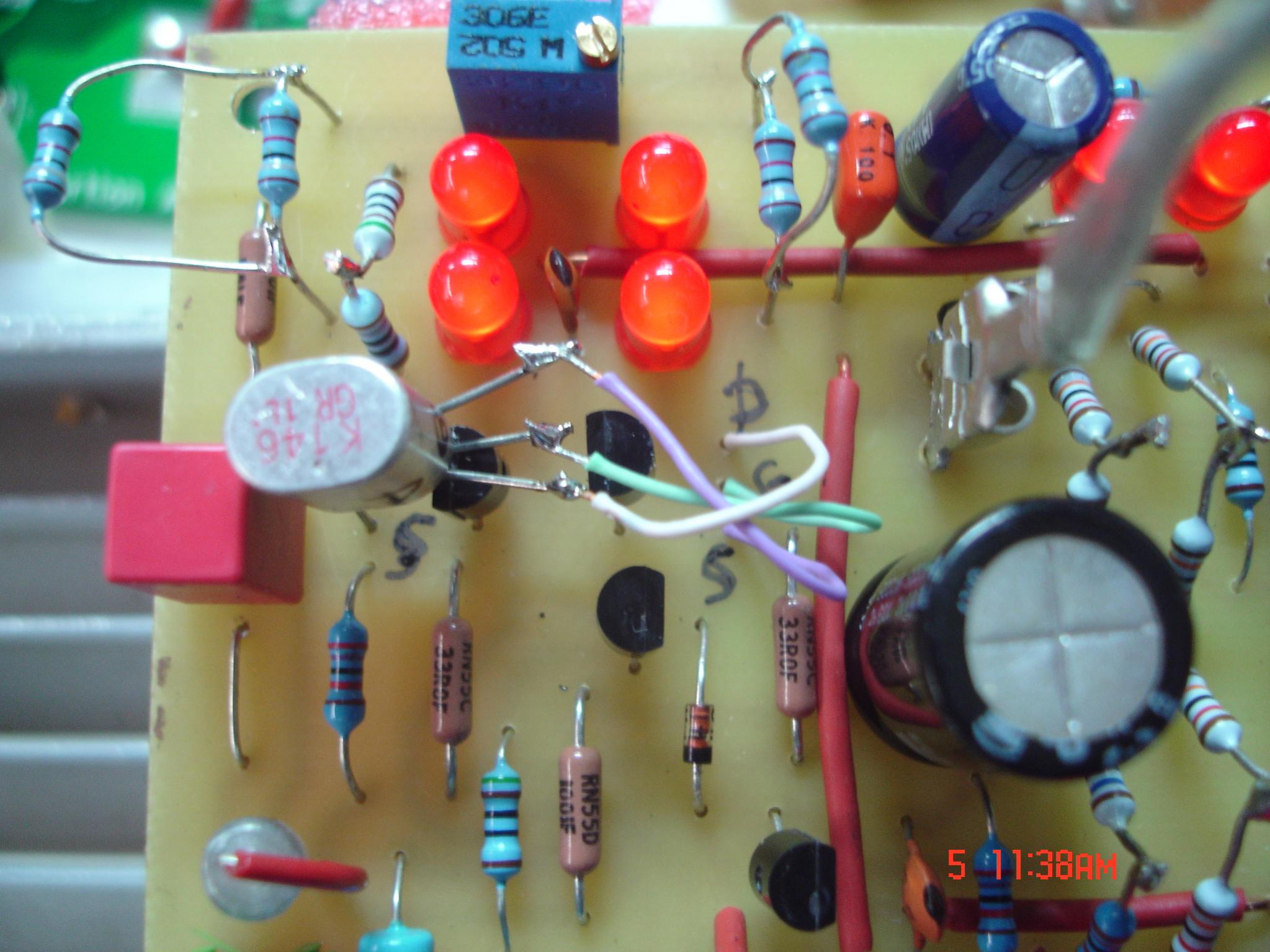

Sons of Vhex ver.1.2 2sk146GR
A dual fet 2SK146GR as input fet.
Nice balance.
I think that an offset controlling trimmer is no more necessary.
Nice balance.

Excellent work! This design is a winner and with some attention to the power supply and layout, it's likely to get even better. Has anyone done phase and gain margin numbers?.
thimios
Hi Nania,
Please see the calculated feedback loop analysis in post #290
ULGF = 2.8MHz
Phase margin = 80 degrees
Gain margin = 16 db
