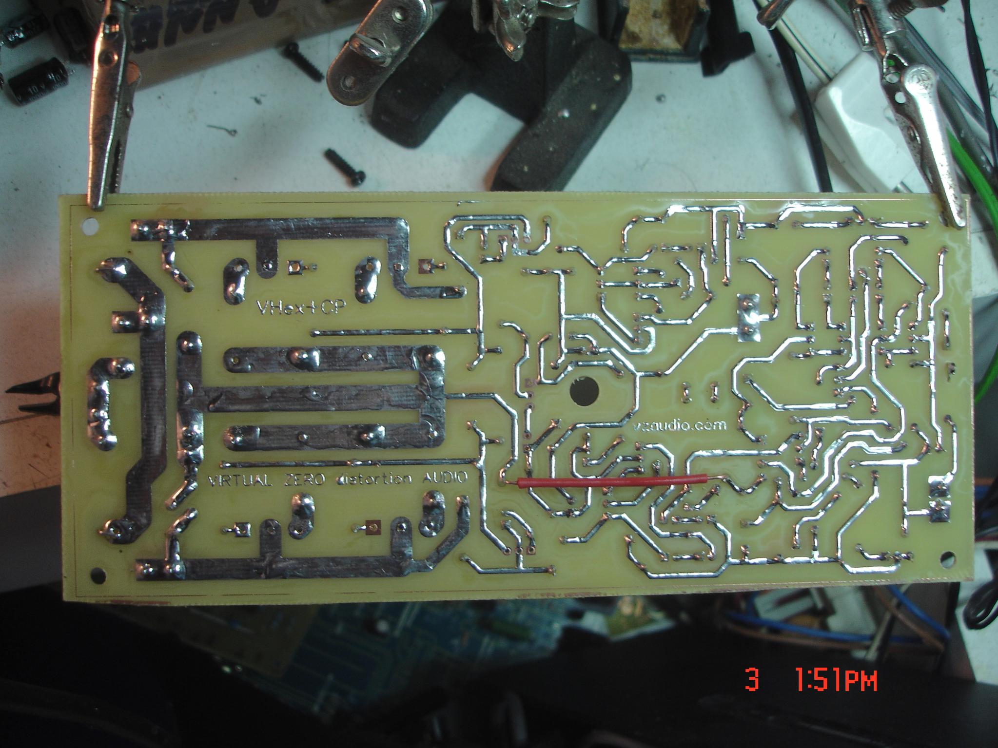

I decided to do just one board for the V1.2. As you can see, iron transfer is not quite as crisp and the photo etch that Thimios uses. Hopefully I will have time tomorrow to transfer the parts over from one of the other boards. I would just do all new but I have running out of red LEDs.

Hi Thimios,
That is what I usually do but yours looks like is didn't cover the holes. I have never been that lucky. I usually wait until after I have soldered everything in place. I know there is some kind of solution that will tin the traces but I have not found it.

Terry i use pencil solder iron Multitip 25W, solder with flux and before place
parts- fill tracks short to holes- if you solder parts- fills the rest, that also keeps a bit heat from parts- my opinion.
Thimios could may be much better explain- his more professional looking work.
Hi Thimios,
You are looking for liquid tin. http://www.mgchemicals.com/products/prototyping-and-circuit-repair/prototyping/liquid-tin-421 Great stuff, and the kids will love turning their pennies into dimes with it. I'd send you a jug, but I don't know how to get it over the boarder.

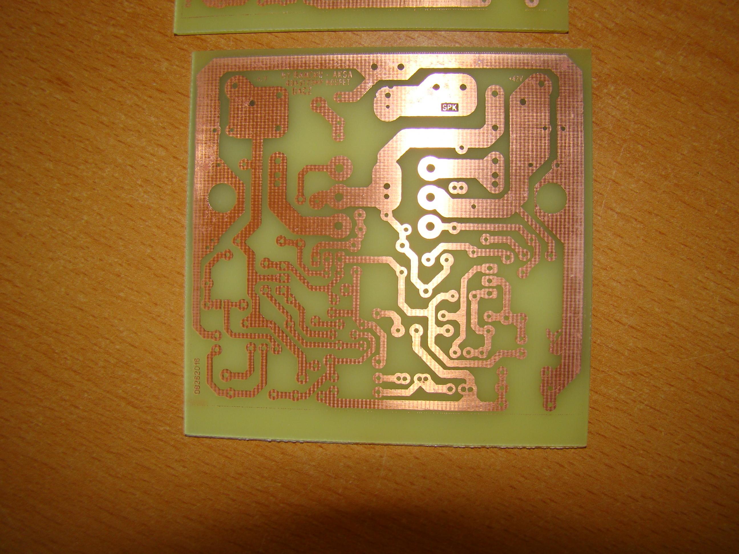

Thimios gets great results with the photo resist boards. Terry also has made many very nice boards. I get sometimes usable and sometimes great results using the toner transfer. These came out great. I use a shallow tray and brush the surface of the board while it is etching.
That did come out good! Is that 1/2oz copper? I think the brush would be the same as using a sponge.
Yes, 1/2 oz copper. I tin the tracks when the board gets populated. That little board is probably about as complicated a circuit as I would etch. There is some extra satisfaction in making the pc board as part of the build but commercial boards with the solder mask are easier to solder up not to mention the fact that our home made boards are single layer.
1/2oz comes out great! You can actually do two layer boards quite easily. Use two 1/32" single sided boards and epoxy them together. The vias can be joined with a piece of wire.

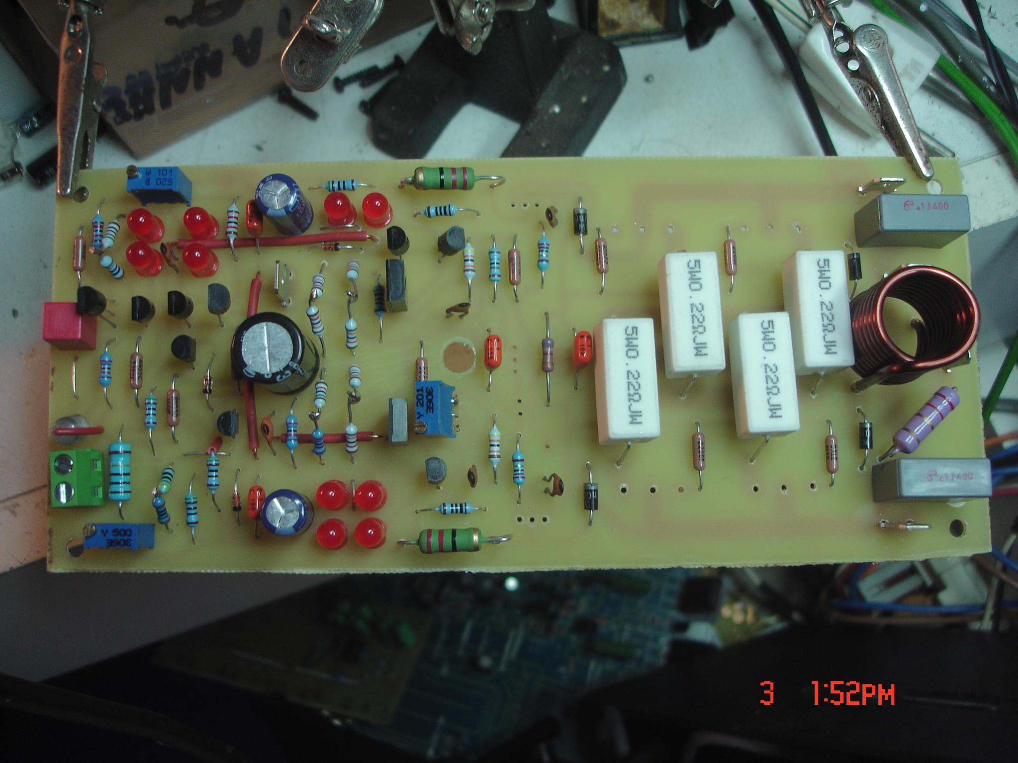

Sons of Vhex ver.1.2

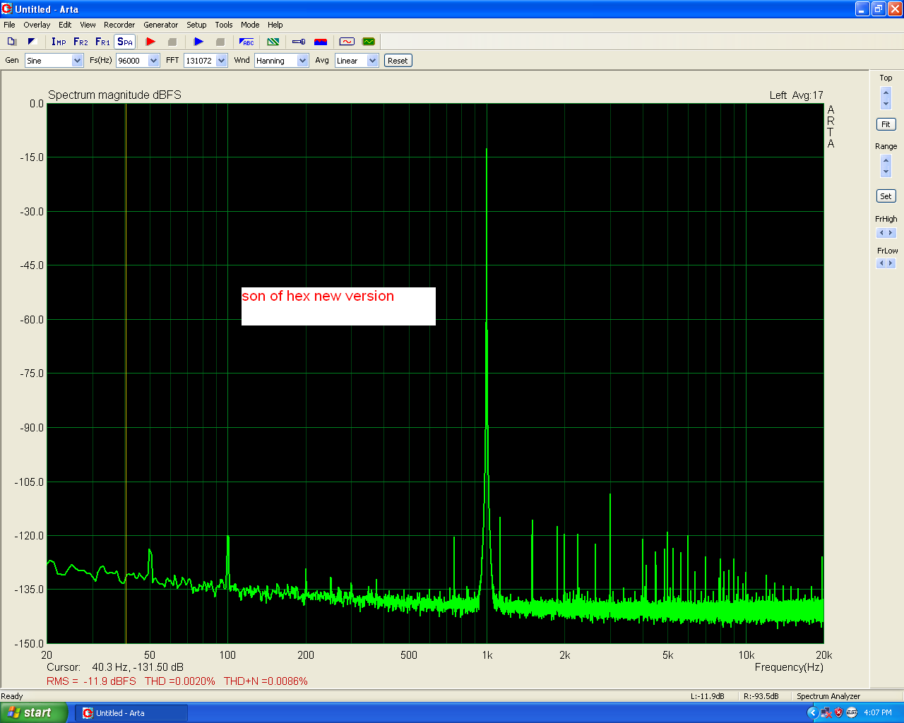

Here is the Sons of vhex ver.1.2
It is up and running.
Now the PSRR is excellent,absolutely quiet,offset is stable,i have a wrong value trimmer installed(100R),so offset is 60mv .
The very first measurements.
Thimios, this one is looking excellent! :up:
100Hz component is somewhere at -110db - nice.
Right, with 1...2k trimmer you will be able to zero the offset out.
I believe, this one is going to sound very accurate.
The first one was not a waste of time as well - we have learned a few things we have to avoid in the good amplifiers 😛
That was a real design process with great inputs from you and Terry.
Many thanks for all the efforts :worship:

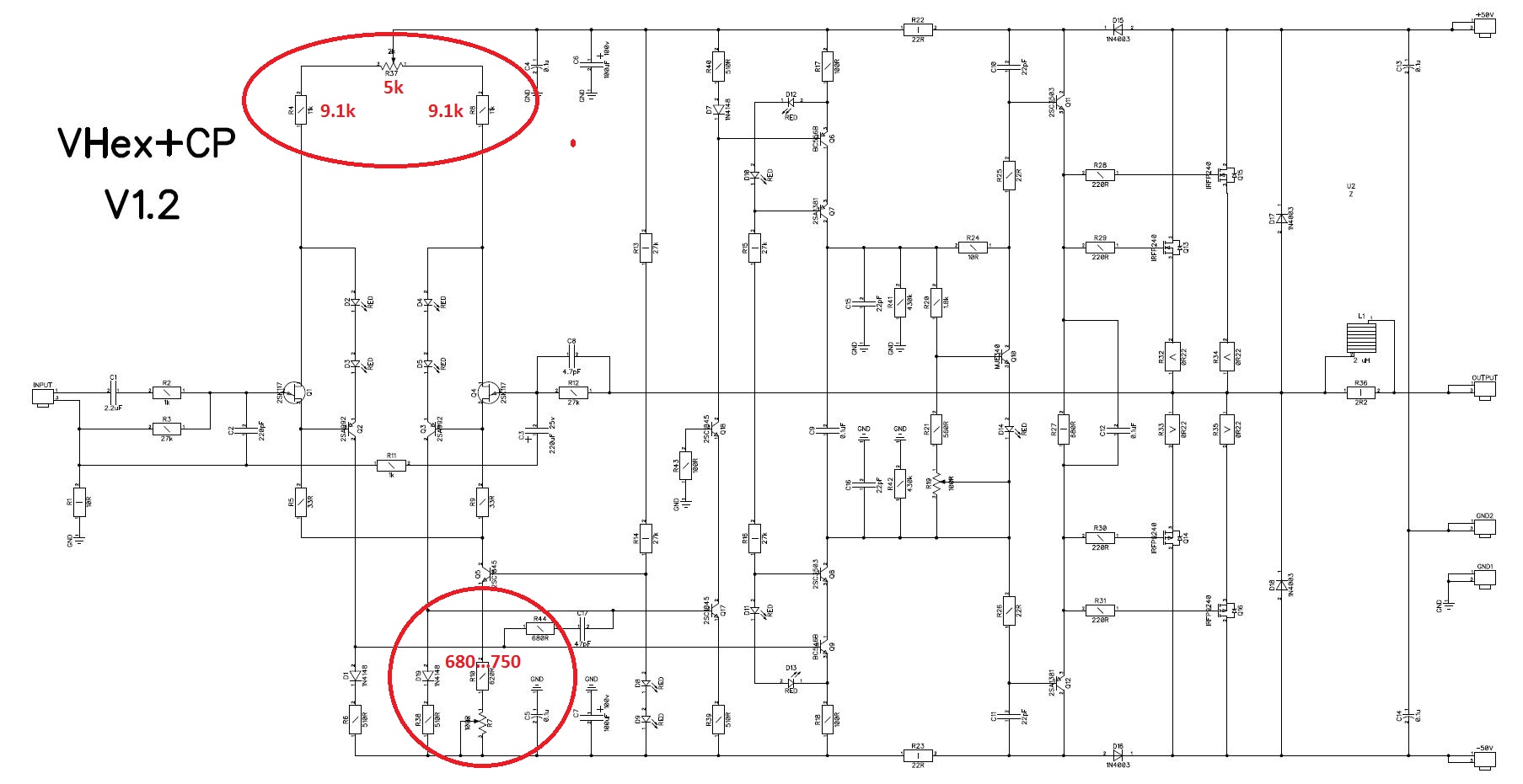

Hi Valery,now it is time for some resistors tuning.
I know that best way is a matched pairs,matched leds e.t.c but i have two 2sk117 only.🙁
Using a 1K trimmer for offset control i can't go better than 33mV. VAS current is low too.
Using the wrong value offset trimmer(100R) VAS current is 540mV/100R when VAS current trimmer is at the end(Counterclockwise).
Finally the idle current control reach the 20 mV bias when trimmer is at the end(counterclockwise).

Thimios, please see attached.
If you've got a 5k trimmer - that would be ideal (R37).
R4, R8 must be 9.1k in this case.
Increasing R10 to 680...750R will allow you setting the VAS idle current to around 6mA.
Note that R37, R4, R8 altogether also influence the VAS current. So the procedure would be:
1) Install R37=5k, R4=9.1k, R8=9.1k;
2) Install R10=680R; Power on with no load, see if you can set the VAS current to 6mA. If it's still too low, change R10 to 750R and try again;
3) Zero-out the offset with R37 - in this configuration it should allow the threshold around -150...+150mV
Valery

Ok.Valery i will try your suggestions.
I have some 2SK146GR DUAL FET but you say that isn't a good solution.
rsavas.I have two pieces 2sk117 only,it is a Valery's donation some time ago.
