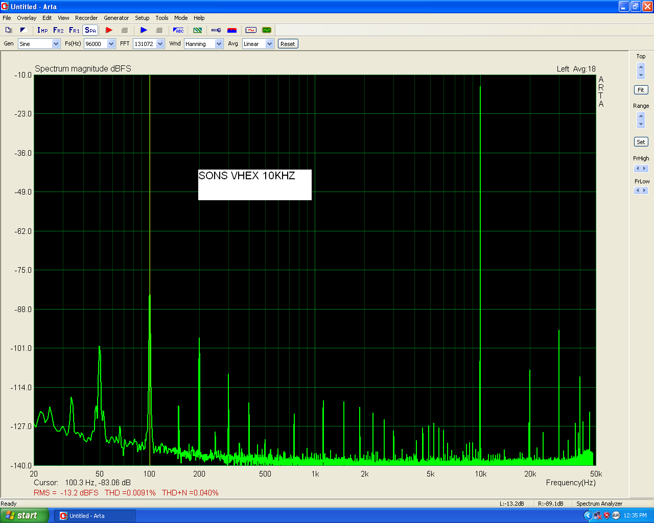

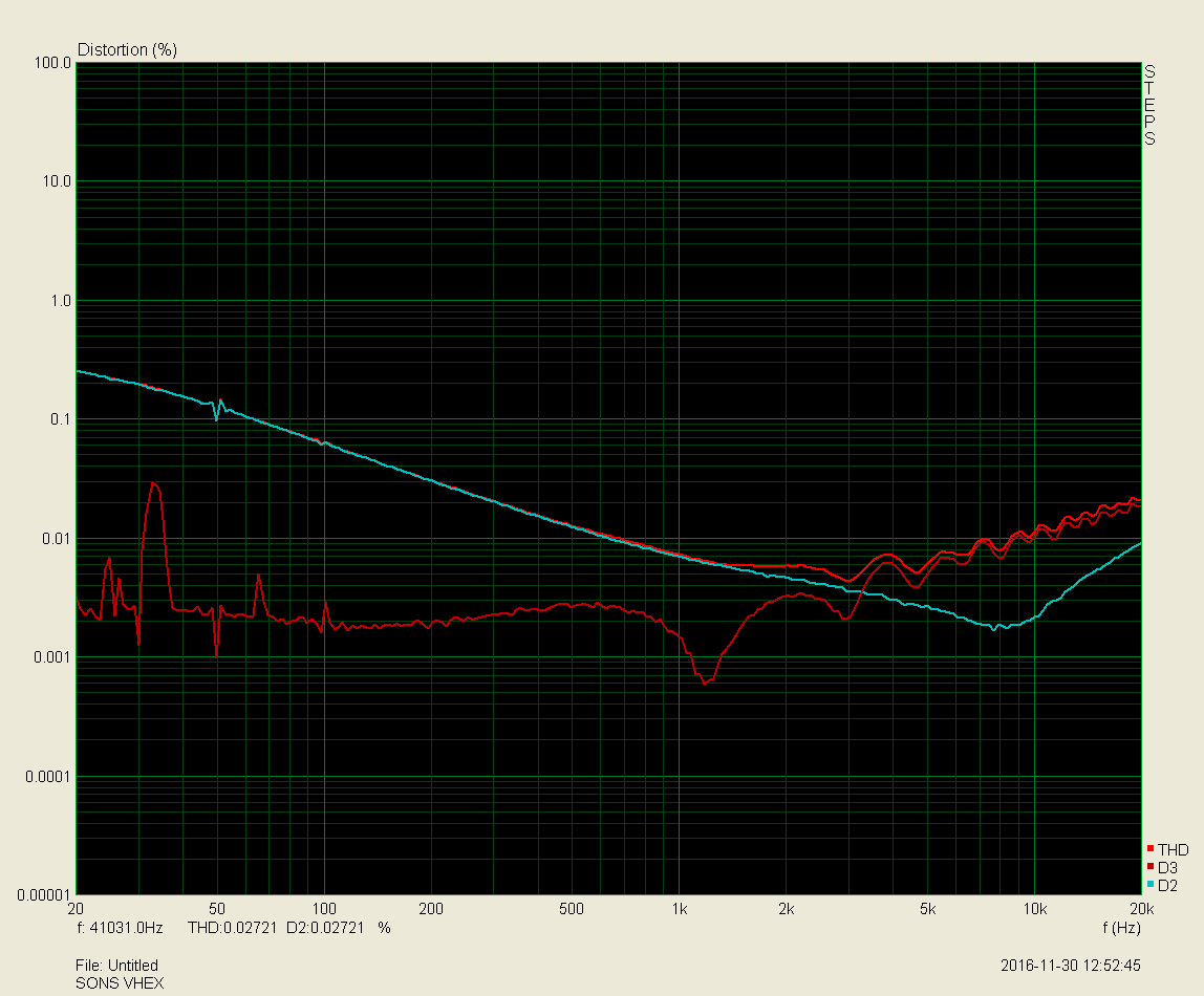

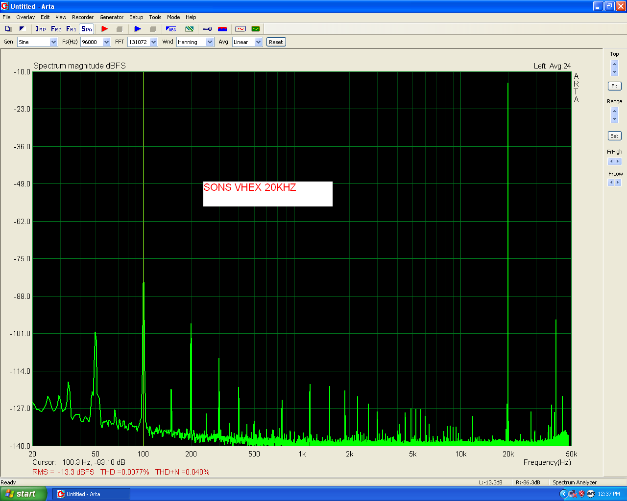

Sons of Vhex

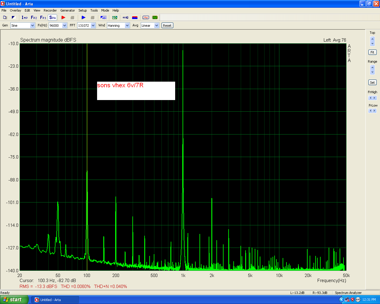

A first test.
1)Offset isn't stable but vary continuously between 0-15 mV.when input is shorted.
2)This amplifier isn't quiet,i see 1mv A.C output when input is shorted.
3)It is stable,i see no ring no oscillation up to 50 khz, the square wave is good.
4)Idle current is rock stable.

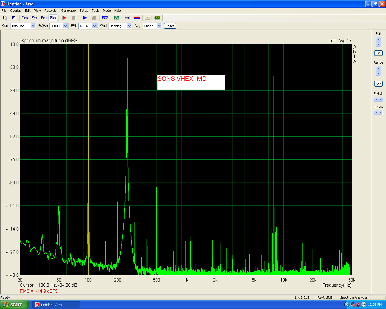

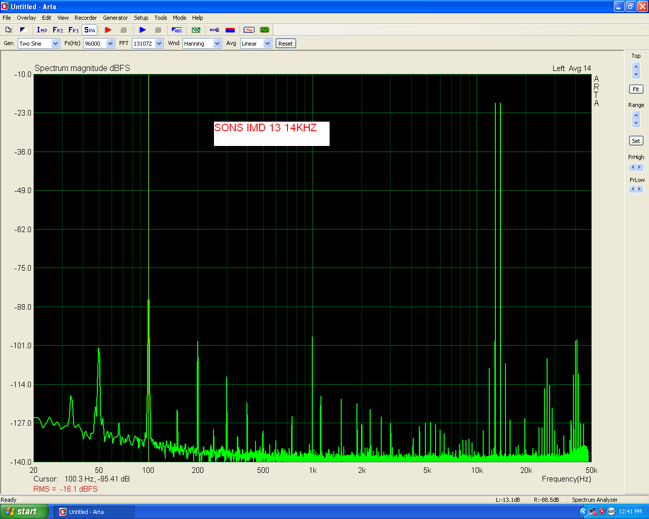

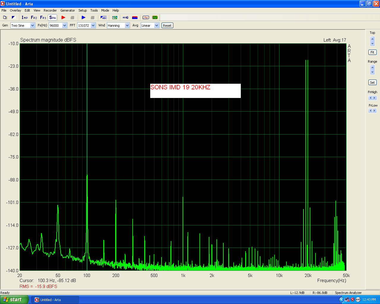

Hi Terry,
Can you power your front end up off a different supply?
It sounds like you have a ground problem. Did you return your speaker load to the power supply directly so that the speaker (or load) current doesn't share any conductor with the amplifier?
