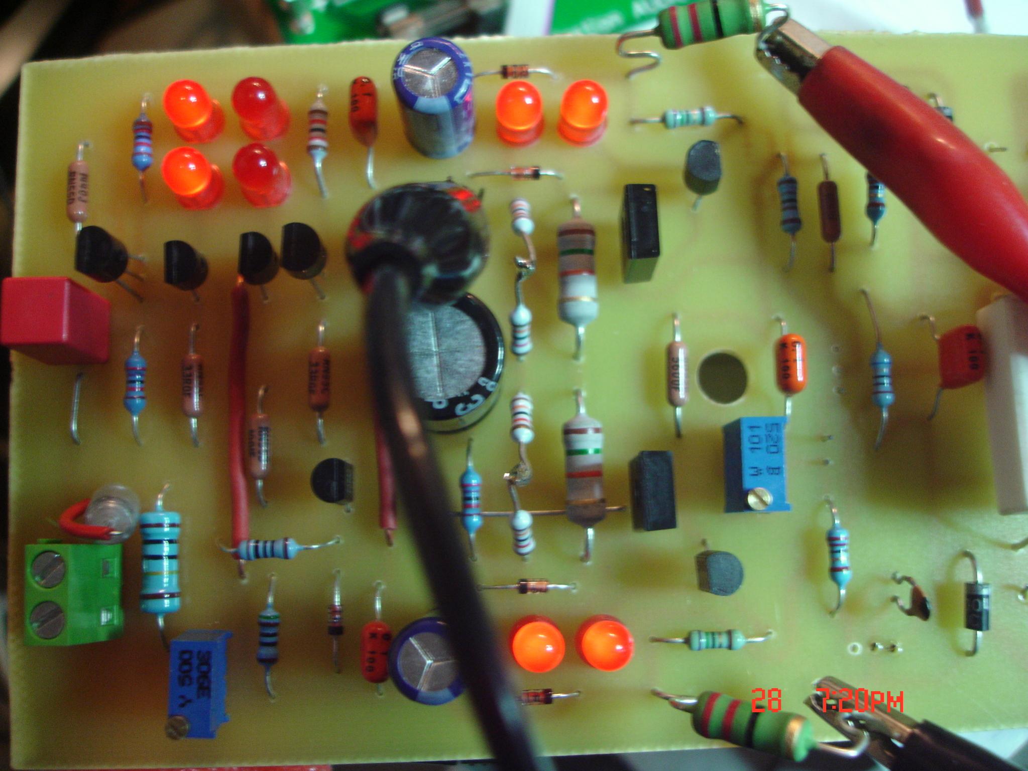

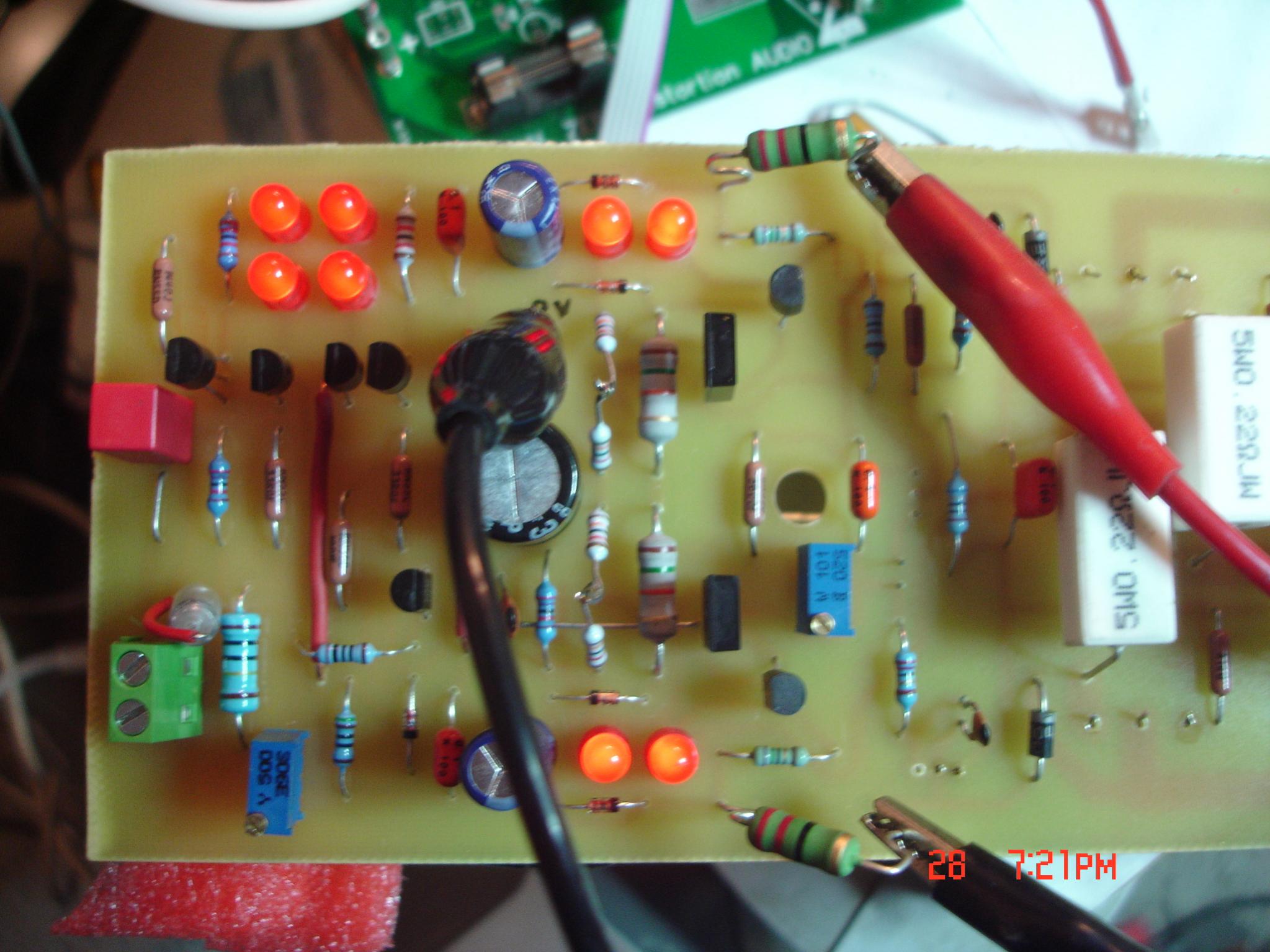

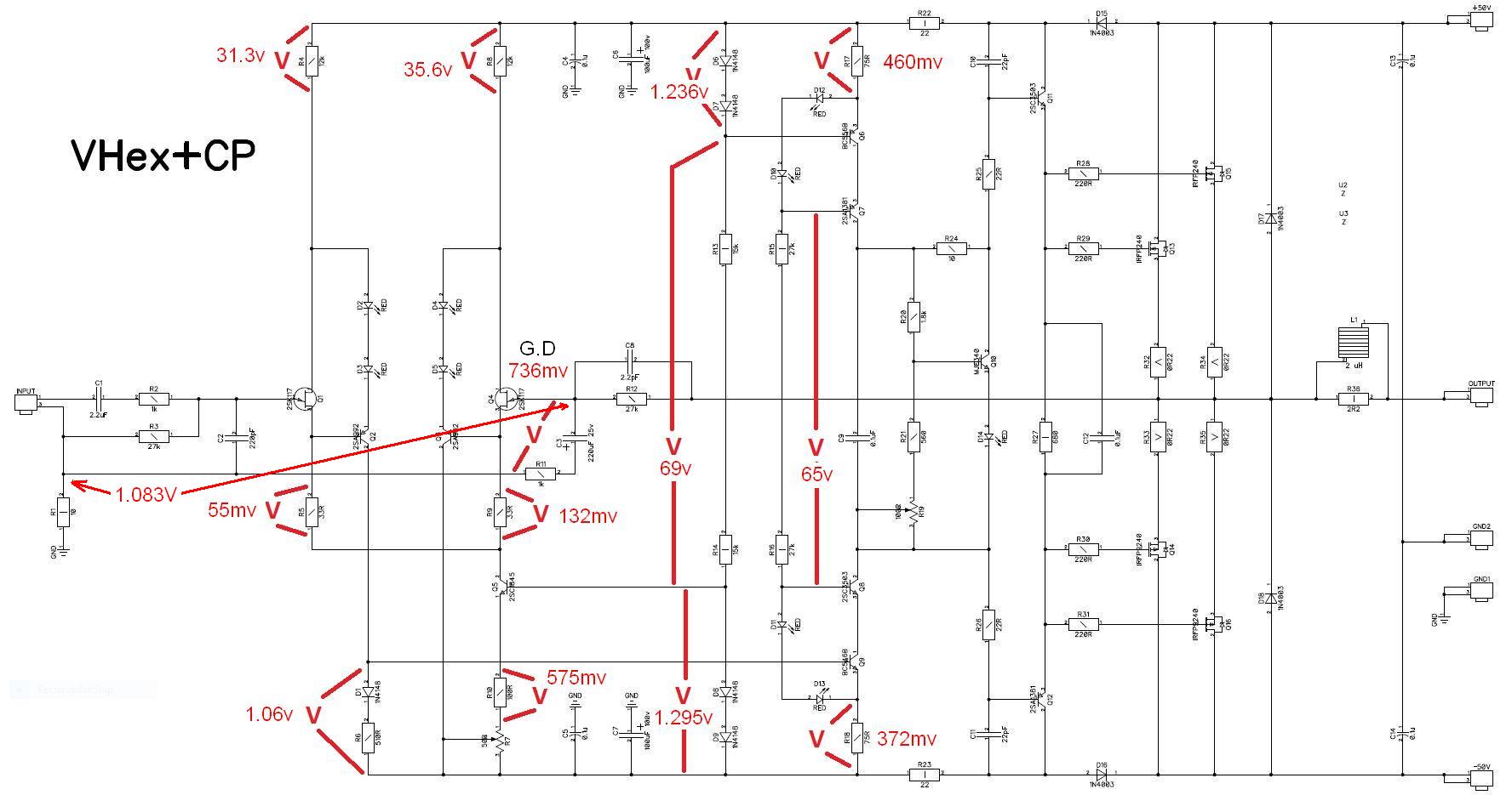

I have double check for dry joint,wrong orientation and wrongly placed parts but nothing.

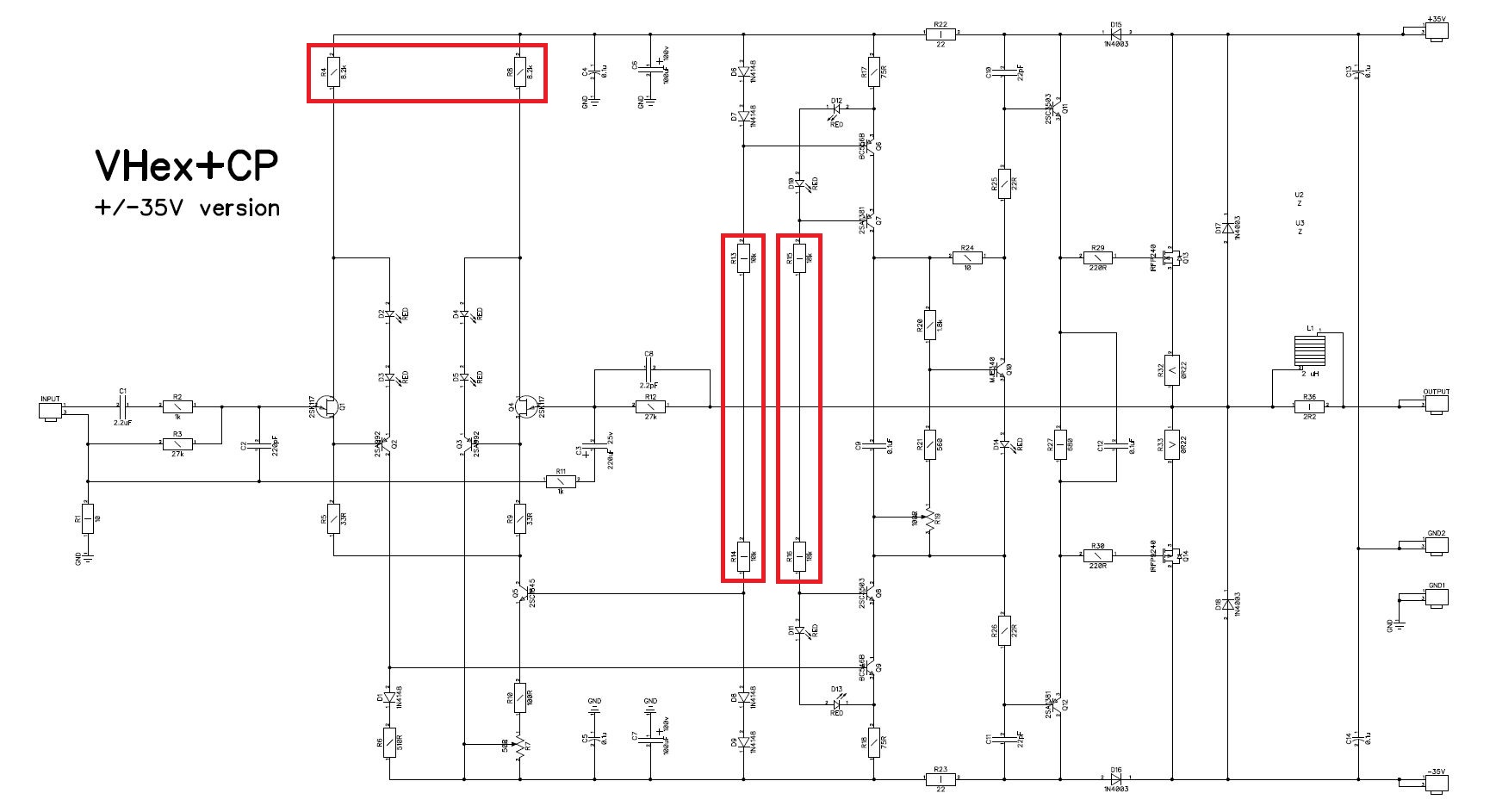

I think I know what the problem is.
This design is rather sensitive to the rails voltage.
You've got some +/-36V instead of +/-50V it's initially calculated for.
Attached is the version, adjusted for +/-35V rails - I did it earlier for one of the members. Can you please try these values (marked by red frames).

Yes,i have power it using +/-50v but with 18R in serial of each rail INSTEAD OF FUSES AND a lamp in series with the transformer primary.
I have measure 4v on 18R.Voltage on amplifier board is +/-36v and the lamp isn't full dark.
I had tried it without primary lamp but without success too.
You can try this PSU config with adjusted values.

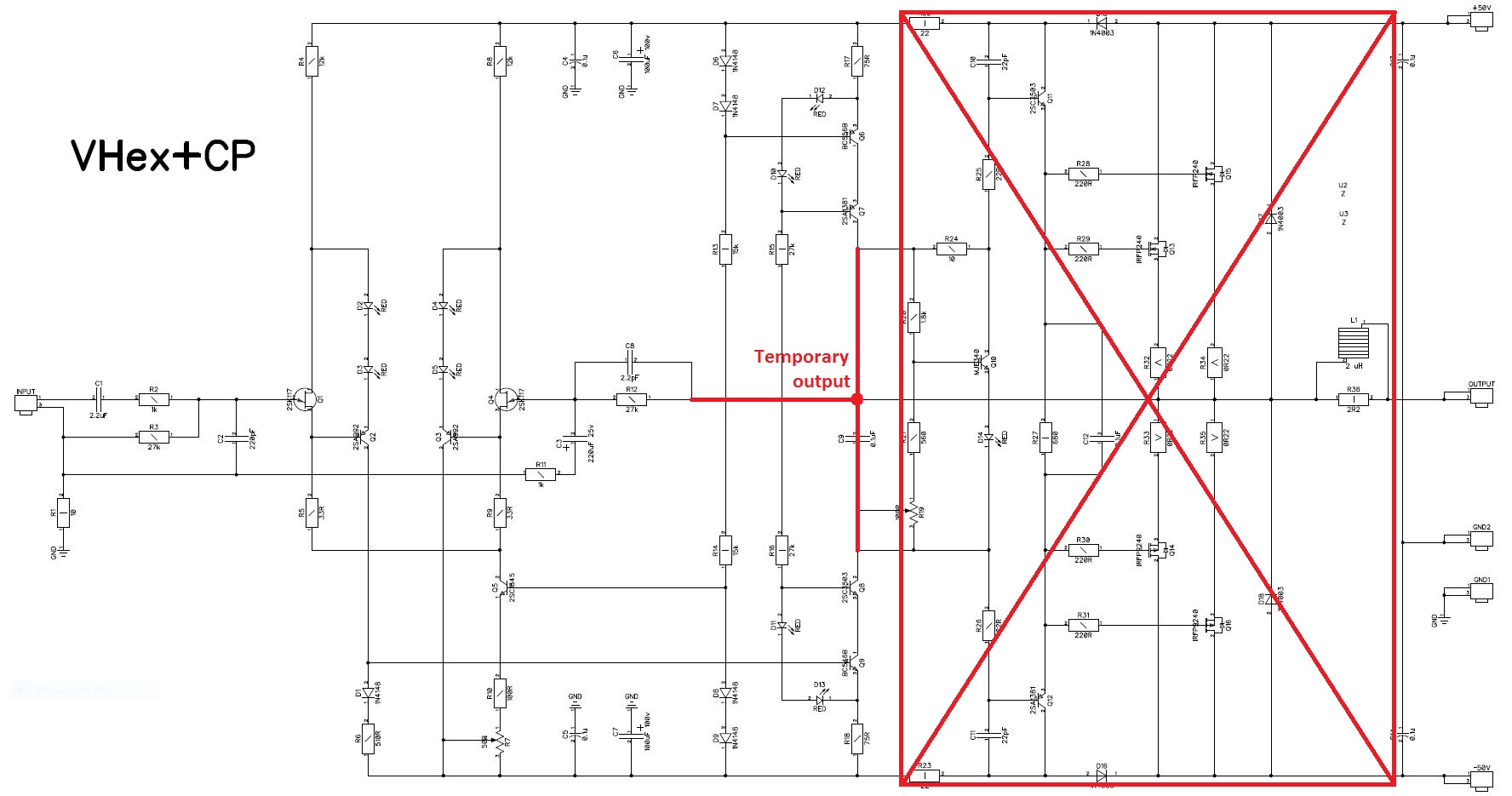

Or - the other way - try the front-end without the spreader, drivers and output transistors, connecting NFB to the VAS output, but with full +/-50V rails.
Some other designs tolerate the rails increase/decrease easily, but this one is rather sensitive to the rails voltage - it's getting imbalanced with the lowered rails.

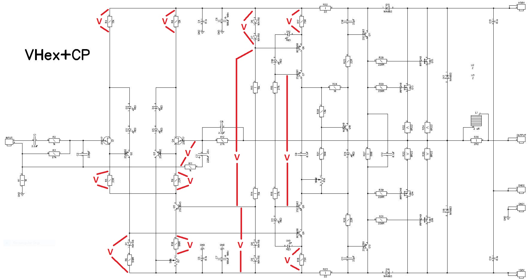

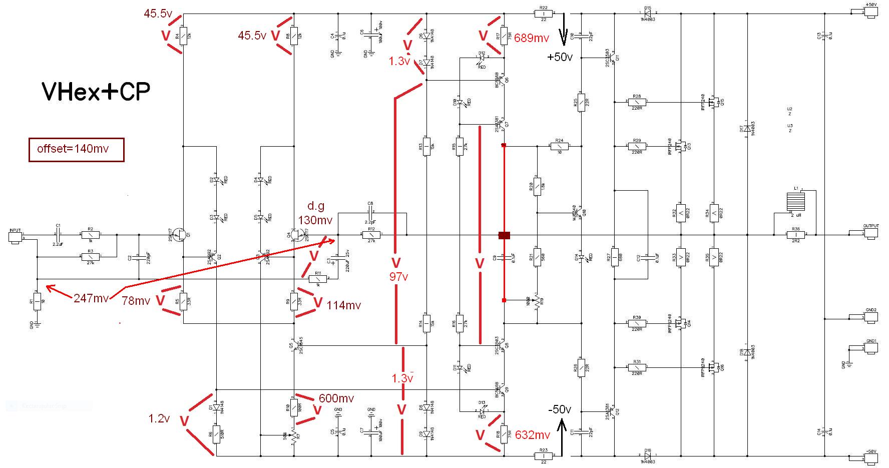

OK, no problem. It would be also interesting to know the offset at the output (no load so far, until we balance it out).
Offset is.......29-35vOK, no problem. It would be also interesting to know the offset at the output (no load so far, until we balance it out).
Can you post a schematic diagram?
Here we go!
You can remove 22R resistors at the rails and connect the rails directly to the front-end (although it would be good if you can add the diodes and 22R in series for having the voltage equal to the real situation).
