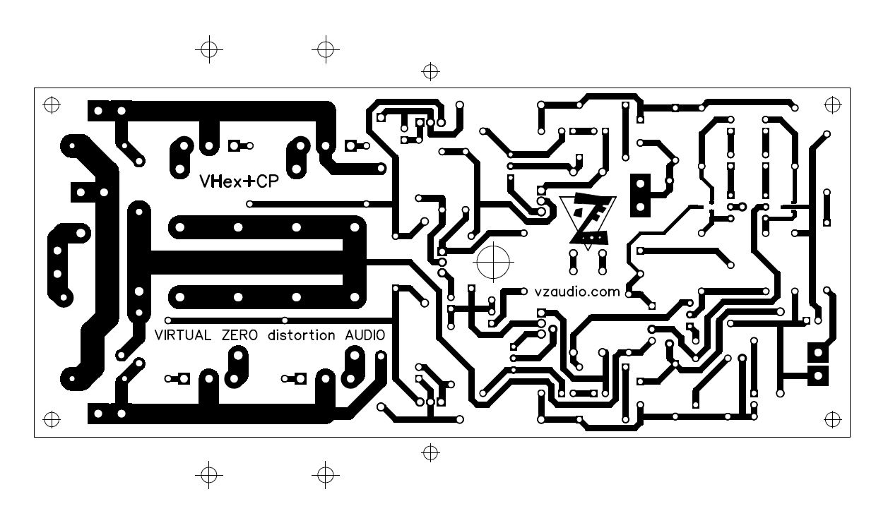

Hi Valery,
For toner transfer, the images must be mirror of what you posted.
Thanks, Terry
Hi Terry,
OK, here are the mirrored ones with smaller holes!
Valery

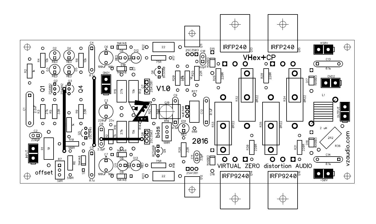

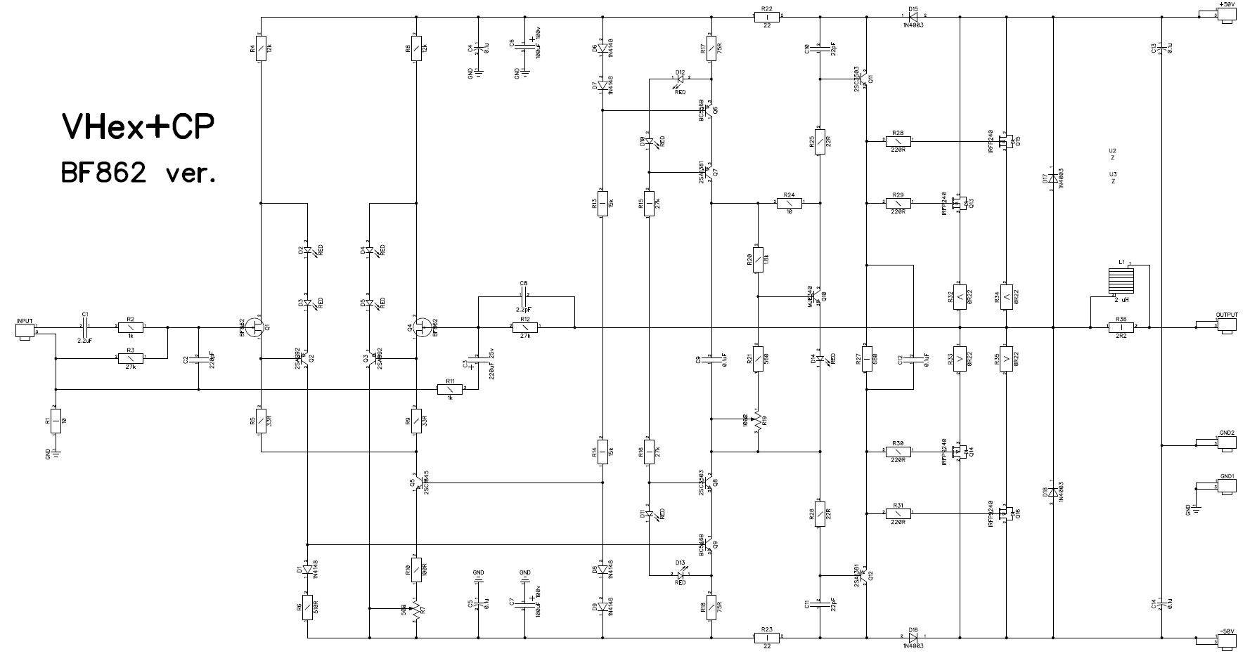

BF862 version
Here is a BF862 version set with corrected small holes for home etching.
I also attach the jpeg ones for reference.
Valery
Valery

Yes, very nice Valery. I have lots of 2sk170's - could those be substituted for the BF's with some drilled holes and bigger pads?
Hi X, just use the version from post #181 above, designed initially for 2SK117 - the holes are already there. 2SK170 will work fine there.

I am new at home made PCBs here but I think if using iron on transfer method for mask I want the image of the bottom not in mirror image. So I will manually mirror when printing PDF. The way I see it, we want the laserprint image to appear just like we want to view it on the back side of the board. Do I have this right?
You have that backwards. You want to glue a mirror image to the copper so when you peel the backing paper correct orientation will remain.
Thanks Valery - missed that. 🙂
No. Any image you transfer will read backwards because it reverses when you iron it down. If you can read the print it won't transfer properly.

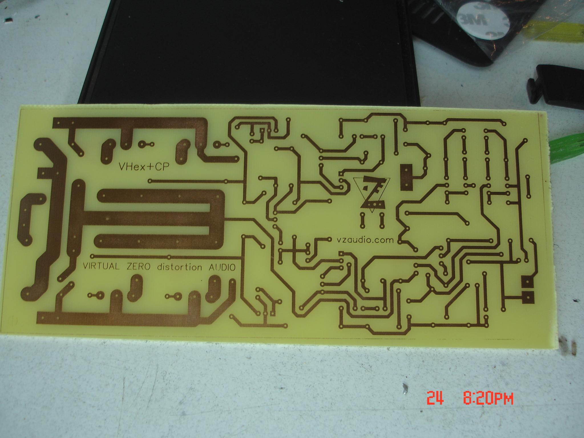

Thimios, very high-quality etching, by the way. Even a thin line on the logo triangle looks good!
<<Thimios, very high-quality etching, by the way. Even a thin line on the logo triangle looks good! >>Which is very cool already!😀
Photoresist method.😉

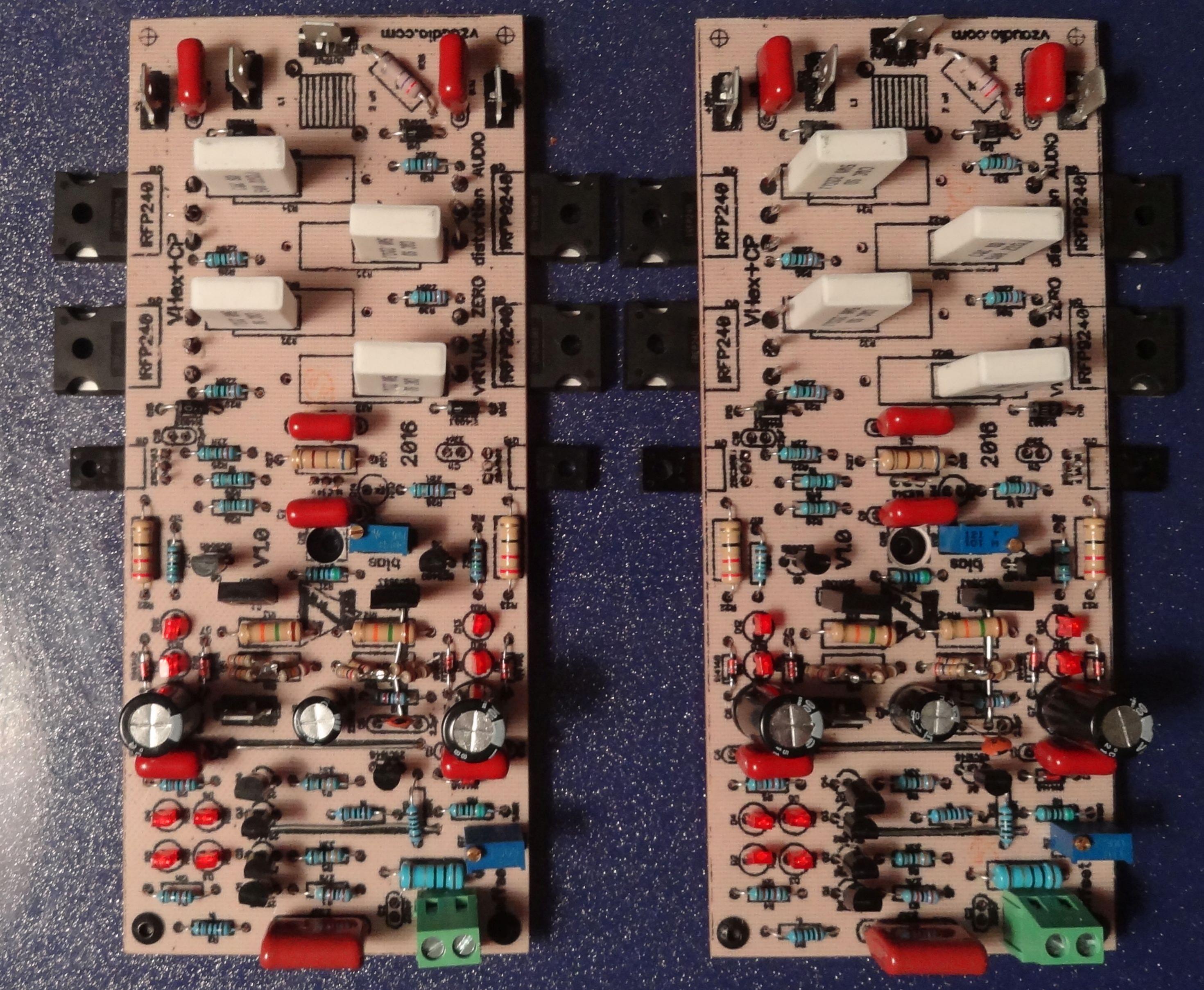

Turns out the reduced scale was not an obstacle. I need to get it mounted on a heatsink in the morning. I used 2SK170 for the JFETs.
Blessings, Terry
Wow)) That means we can slightly scale-down the board if we see it doesn't fit the chassis or a heatsink.
Never thought about it that way 🙂
