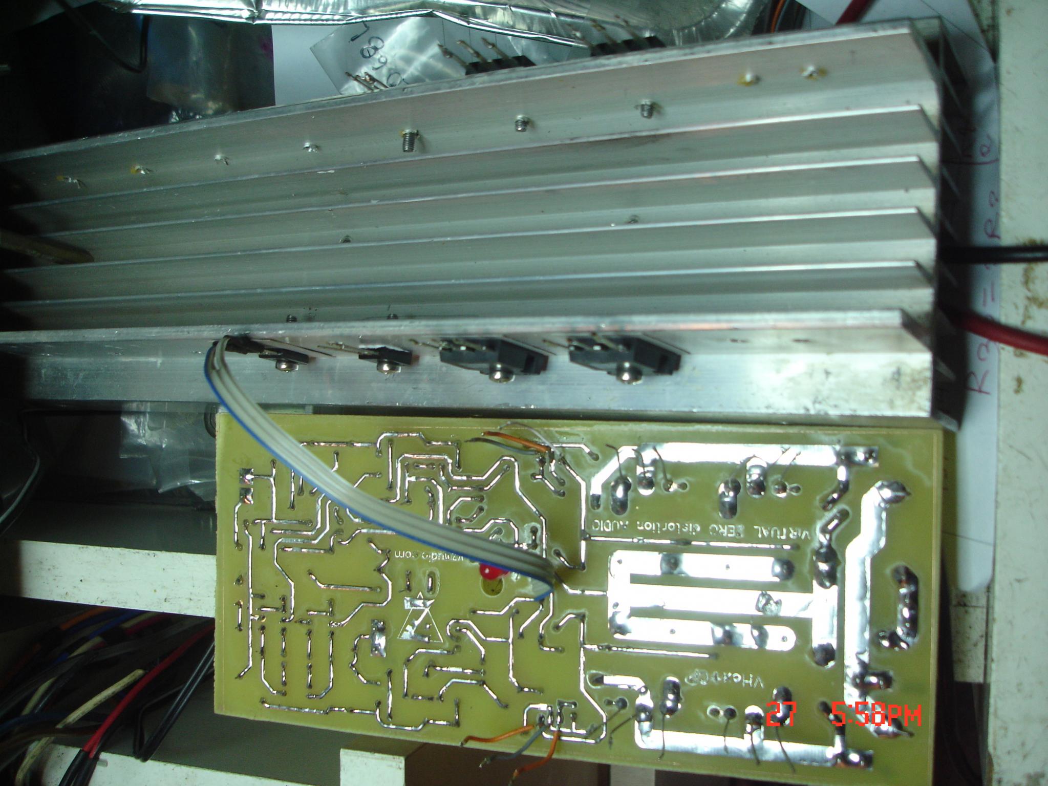

I have done a clone in Eagle of your shematic, Valery.
Because i have only EAGLE 7.6.0 Light- full version 125€
i couldn't go more board size 80x100 mm. 3.."x4"
My idea was transform a bit to VLatFet board.

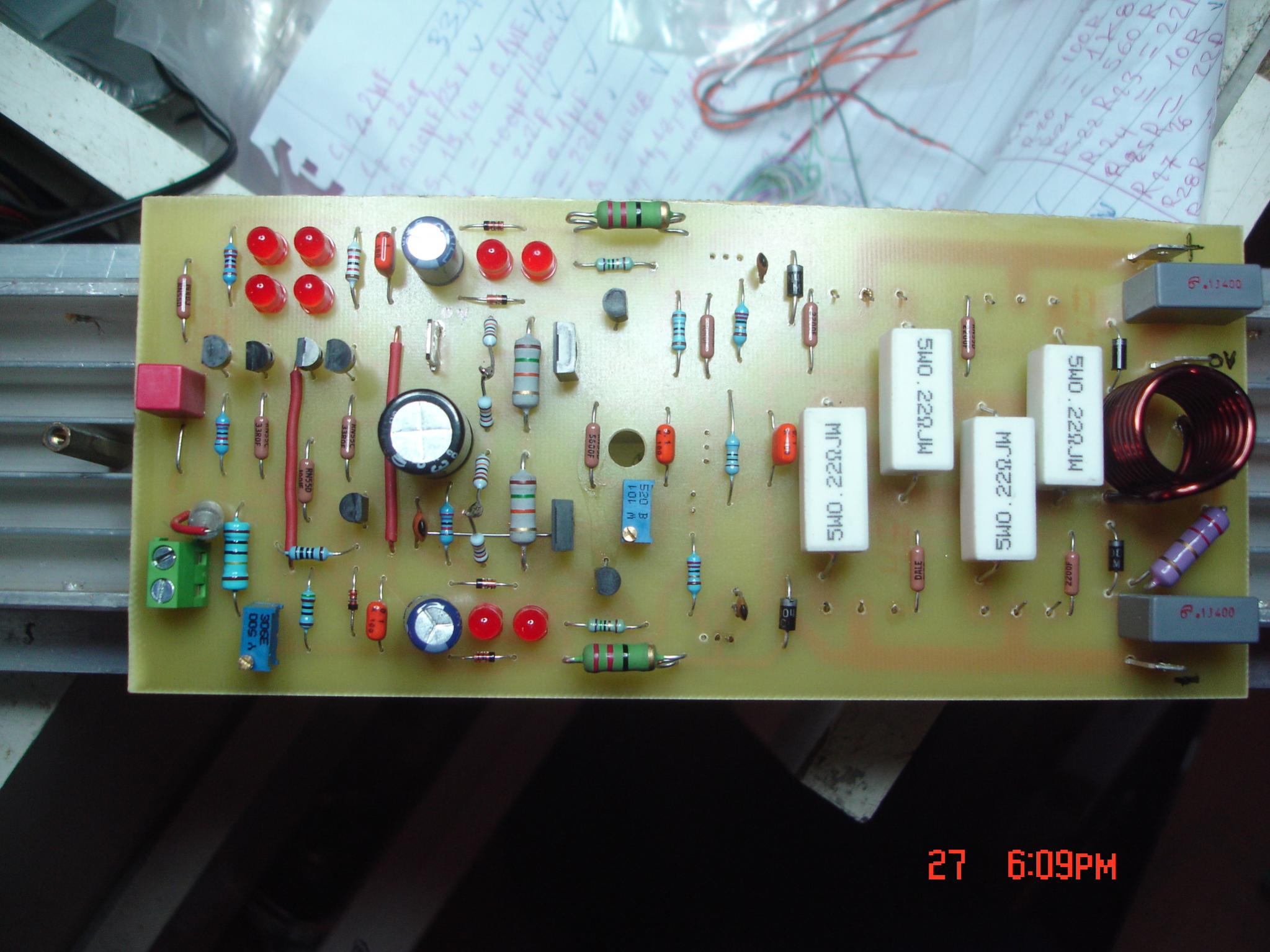

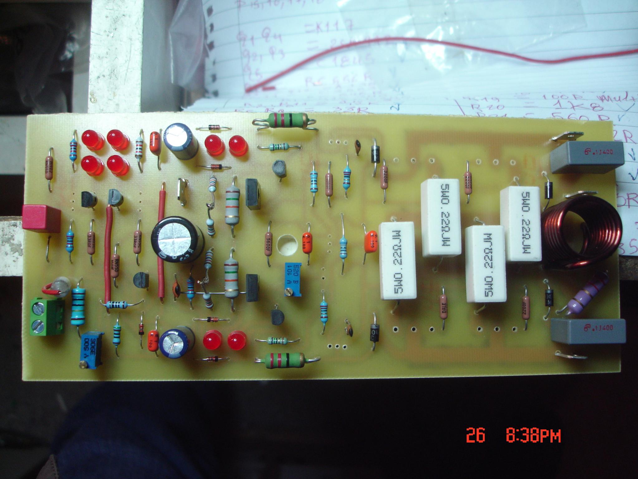

Turns out the reduced scale was not an obstacle. I need to get it mounted on a heatsink in the morning. I used 2SK170 for the JFETs.
Blessings, Terry

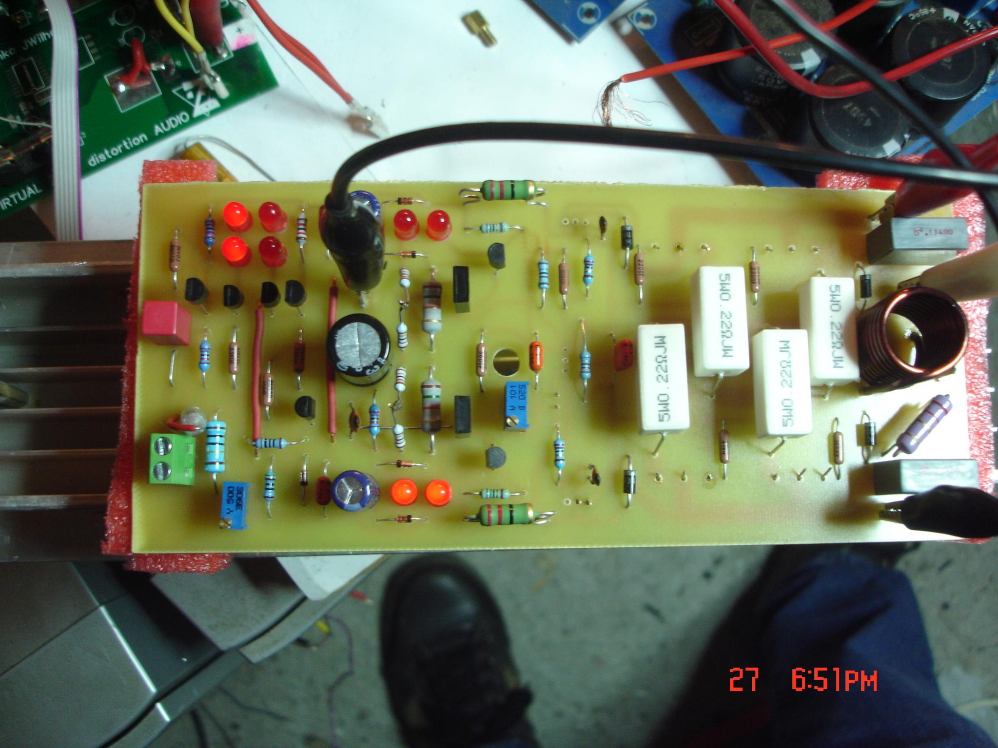

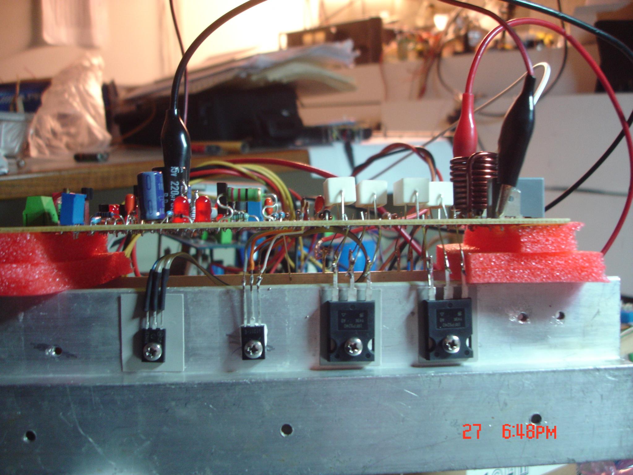

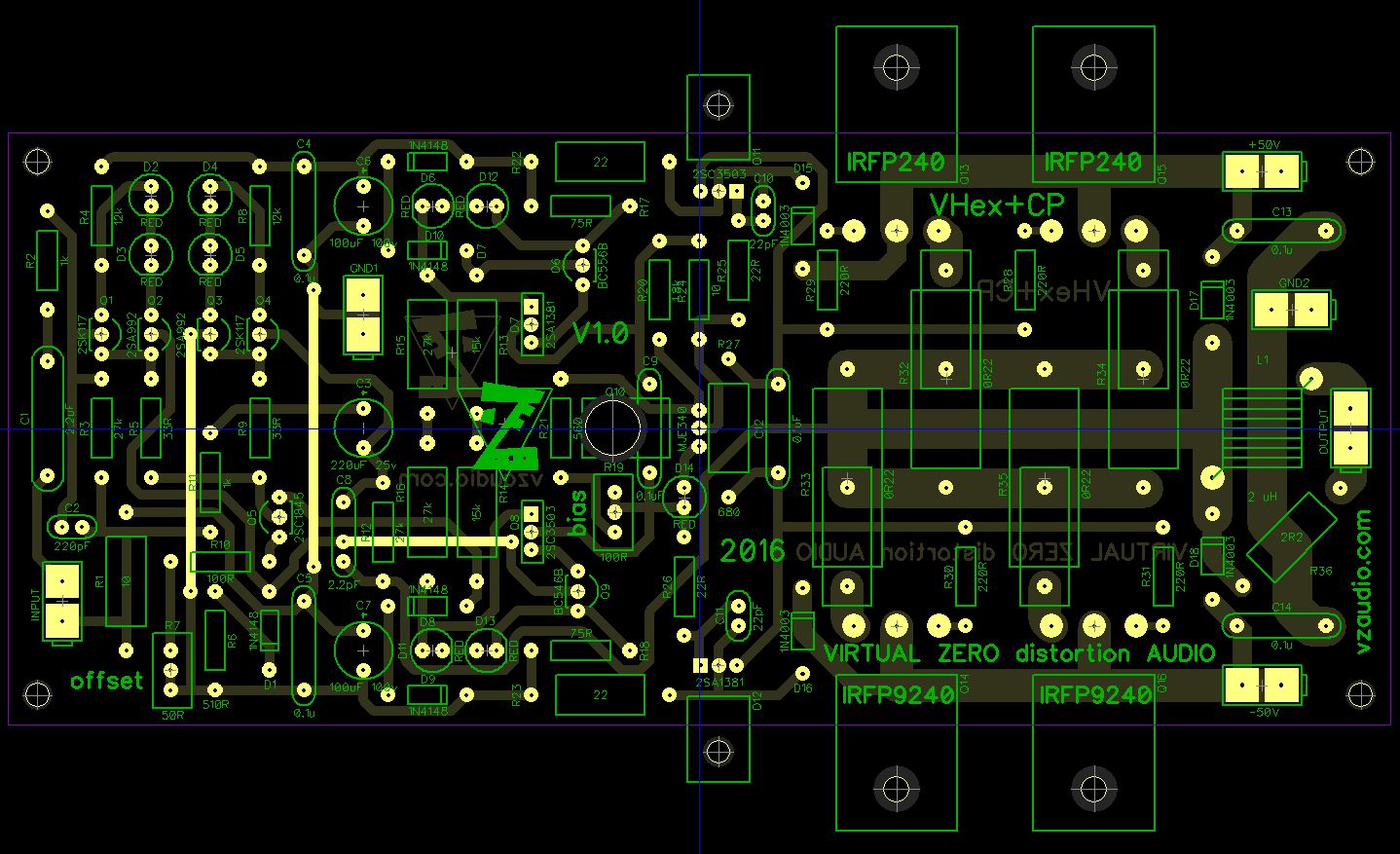

I have them mounted on a heatsink but they are not firing up properly. Only D8 and D13 light, All other LEDs are dark. I don't have any more time to troubleshoot today so I will have to get to it later. Can you post a pic showing the components in overlay with the traces?
Thanks, Terry
Thanks, Terry
Thanks, Terry
Hi Terry,
Here is an overlay, looking from the top.
Valery
