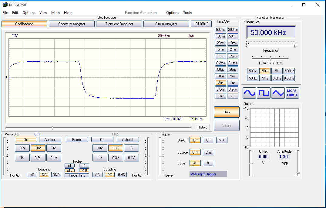

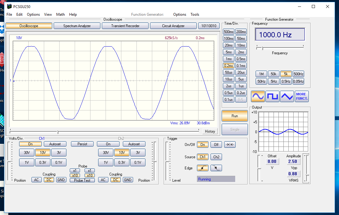

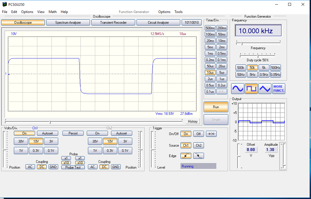

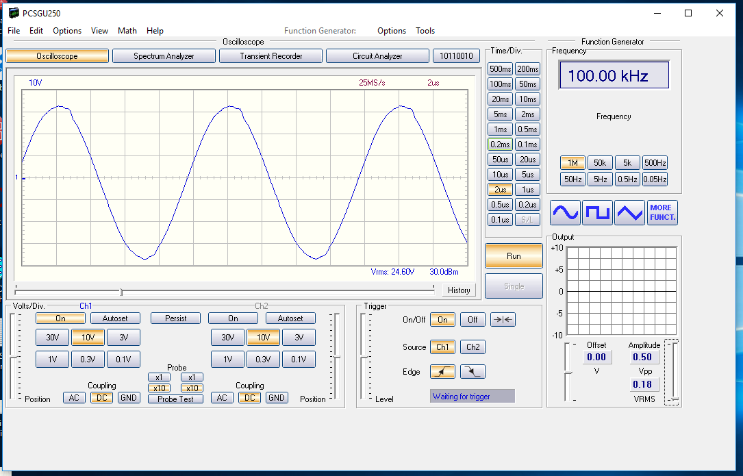

I've done a little more testing on the VHex+CP amp. Great running and great sounding as always! it has a very slight turn on thump, but noise free otherwise. Here's some scope shots.
Jeff, very cool, including excellent clean clipping. No artifacts.
Looks like the oscilloscope has got some negative DC offset - all the diagrams are below the center line 😉
Can you please drop the final schematic here - as I remember, you have adjusted the resistor in CCS.
