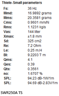

Here is some T/S parameters for us to 'play with'...plug them into sims & let's see what it can do...A ten-inch full-range $523.00 dollar driver.
Some graphs I saw had the response from 125 Hz. crashing a full Twelve Db by the time it got to only 50 Hz.

This price for you was fr a pair of speakers, including shipping. Actual price of one pair speakers SWR 250/A - $500.00 dollar/PAIR

Well, I've absolutely no doubt you can run your own analysis but using that spec. and assuming the usual 0.5ohm series R for wire-loop, connection resistance, then as far as regular vented enclosures go:
Standard maximally flat vented after Small: Vb = 116.75 litres [nearly], Fb = 38.4Hz [nearly]
4th order flat vented after Keele: Vb = 111.6 litres [nearly], Fb = 38.3Hz [nearly]
...and assuming I was designing an enclosure for a reasonably wide number of people who aren't familiar with adjusting the tuning of vented enclosures to suit their particular room acoustic (and aren't interested in learning), then I would be inclined toward 100 litres with an Fb = Fs for a mildly damped 'practical' alignment that should work reasonably in a variety of situations. Obviously, the need for EQ or lack thereof will depend on the design details & its room position, so can't comment on that without working up a full design, as generic values / assumptions aren't generally of much use.
